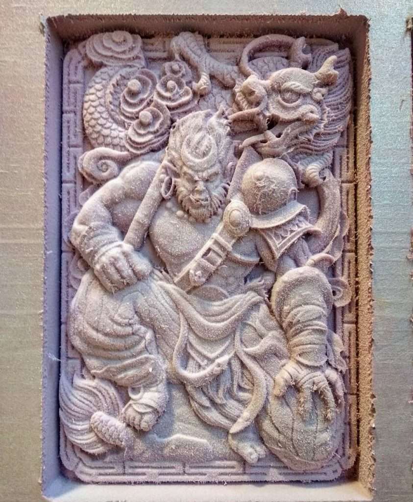

Foam, being a super soft material, is an easy material to cut. We recommend foam as a starting material to practice CNC programming. Foam also has many useful applications, such as in packaging, RC planes, drones, and more.
Rigid foam is a super easy, soft material to cut. Most of the time, you can cut at full speed and full engagement with no issues, making it a fast way to draft out cuts. Soft foams come in many different densities and softnesses, which can affect cutting. Read more below to learn more.
These settings work with both 1/8″ and 1/4″ 2 flute flat end mills.
MaterialFeed Rate (mm/ min)Plunge Rate (mm/ min)Step OverStep Down (mm)Spindle Speed (RPM)
Foam (rigid closed-cell)25008000.7610,000
Rigid foams (polystyrene foam insulation)
  • Because polystyrene is so soft, you can typically cut this material at full engagement. Keep your spindle speed low to prevent melting.
  • Since it’s easy to cut, we recommend using it to practice CNC programming or as a drafting material.
  • Foam dust is very fine and sticks to surfaces. It is recommended to use a dust shoe.
  • Keep an eye on melted foam on your bits. You can clean them off with some acetone.
