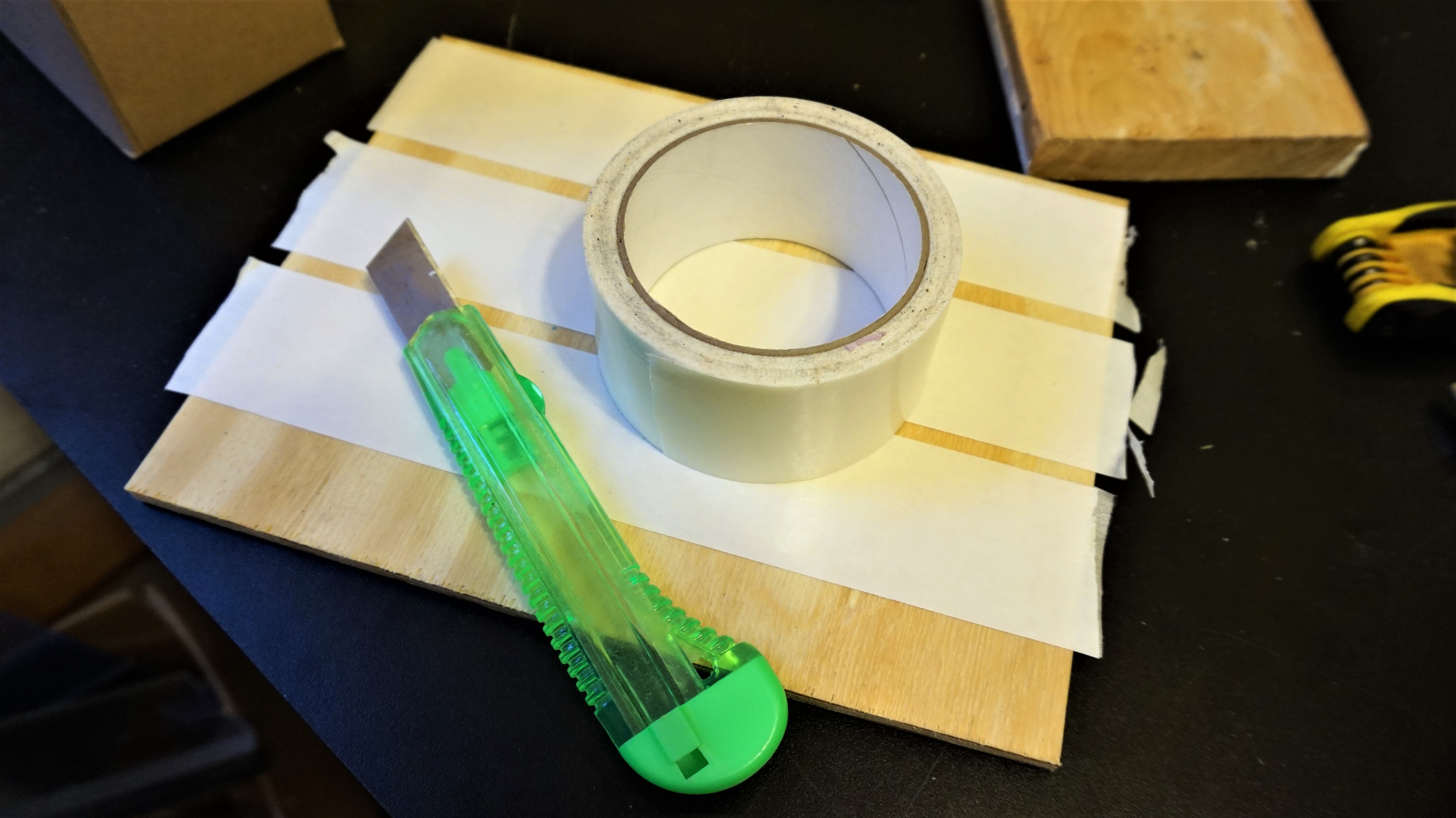

Carpet Tape
One of the fastest and easiest options for securing your material and can be found in most hardware and department stores. Carpet tape has surprisingly sticky adhesive on both sides, and works best when applied to flat pieces of material with a large surface area. Using carpet tape usually eliminates the need for workholding tabs since the final part is kept held down by the tape.
Tips:
  • Ensure surfaces are clean before applying carpet tape.
  • Press firmly on your material to ensure both surfaces adhere properly.
  • Water will often cause the tape to loosen its hold on the tape; keep this in mind if you are using coolant.
