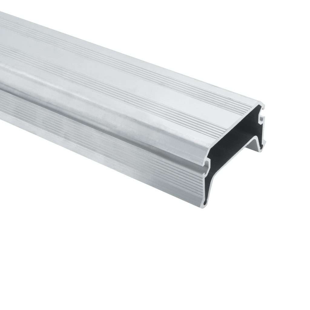

All MK1 machines use angle aluminum for all the rails.
Here are some photos of the rails

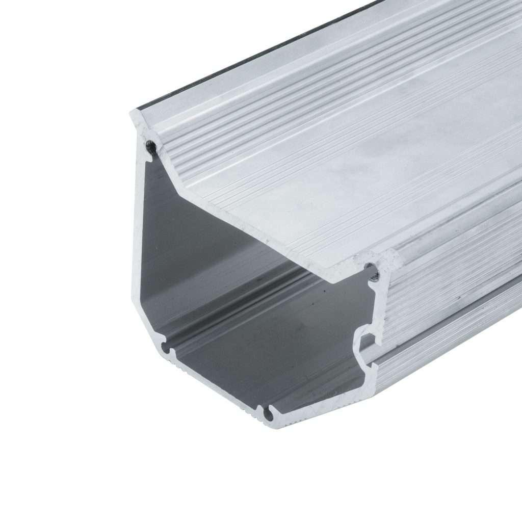

If you have a LongMill MK2, you will have our “rectangular rails”.
Here are some photos of the rails.
The LongMill MK2 started shipping in March 2022 and continue to be the latest version to ship.
