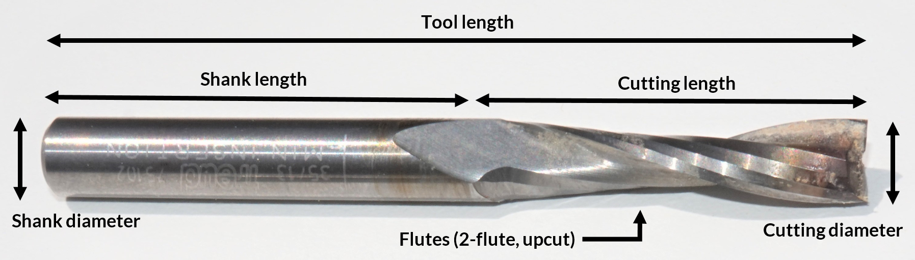

There are cutting tools for every possible cutting application. Features such as tip shape, shank diameter, cutting diameter, tool length, flute count, helix direction and tool material can all vary from tool to tool. The material that you wish to cut, how fast you wish to cut it, and your desired surface finish will decide what features you want on the tool you end up using. Since there are a lot of variables, we’ll try to stick to the most commonly available cutting tools that you can use with your Mill One.

The detail accuracy that you can produce with your machine is primarily determined by the cutting diameter of the tool, with the maximum depth determined by its length. Some of our go-to sizes include:

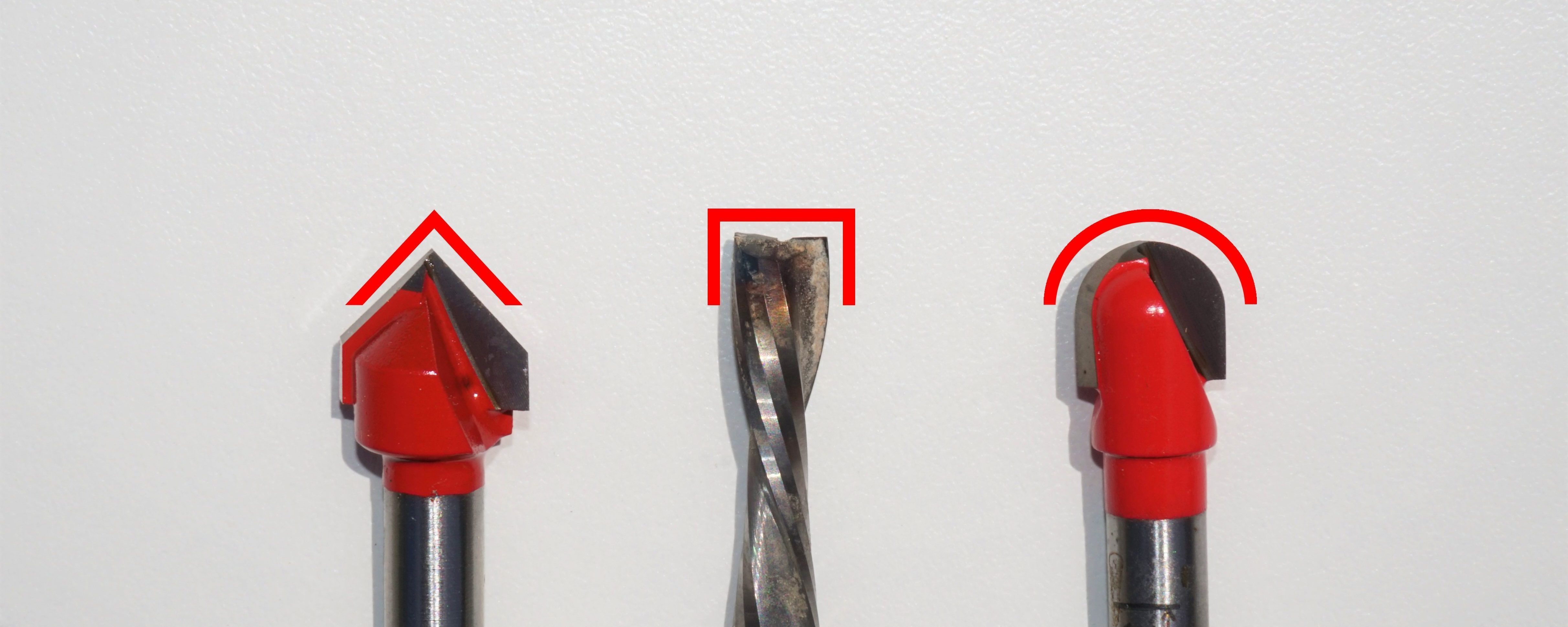

Tip shape
Tool tips can take on many shapes, with each tip designed to be used for a specific application. The three most common tip shapes are flat end/fishtail, ballnose, and v-bit/engraving.

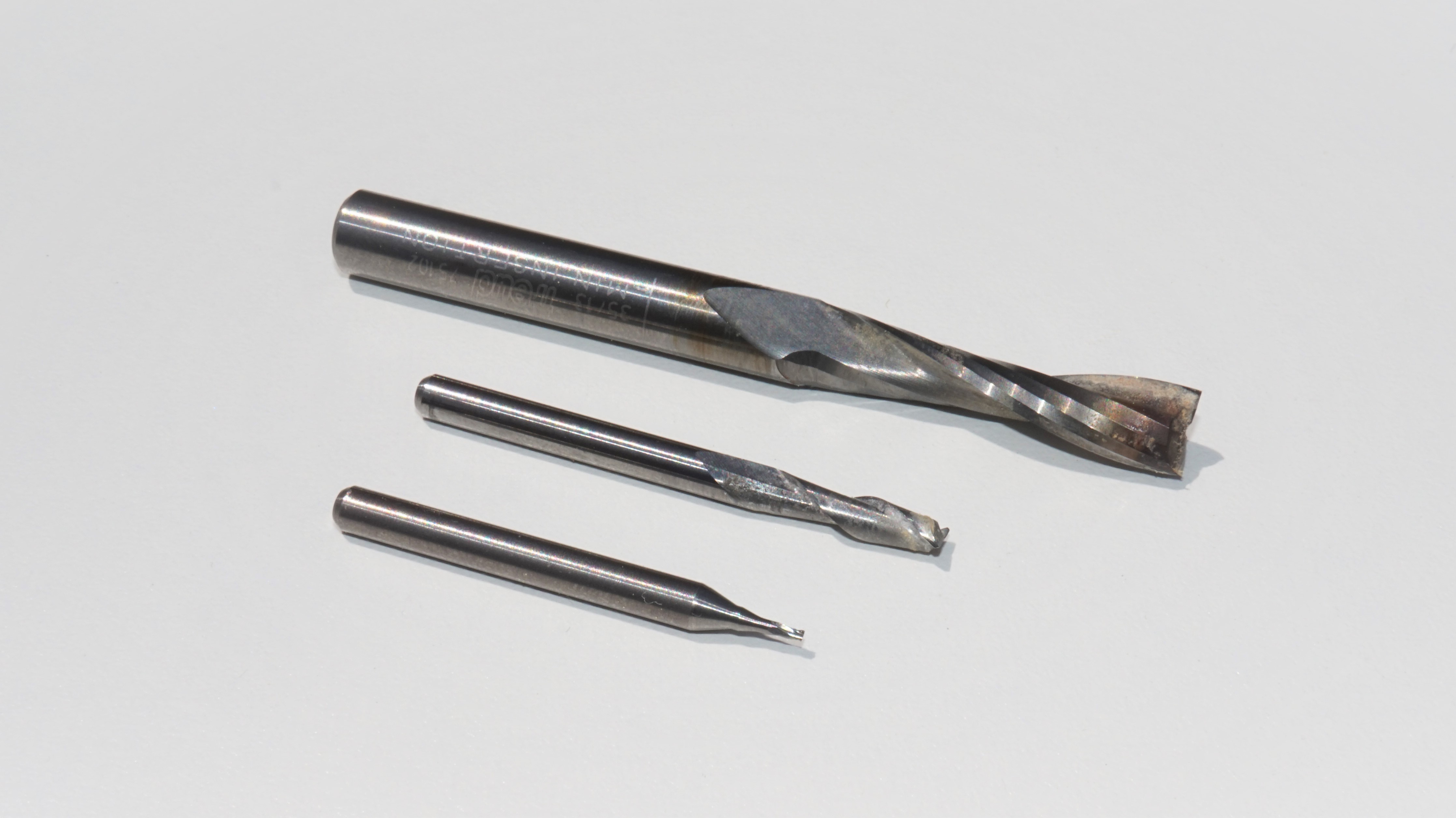

End mills are typically used to mill most 2D parts and any 3D parts that do not have complex features, while ballnose mills excel at cutting 3D curves and contours to a smooth finish. Increasing the overlap between cutting passes for either of these tools will also boost their ability to produce a smoother surface finish.

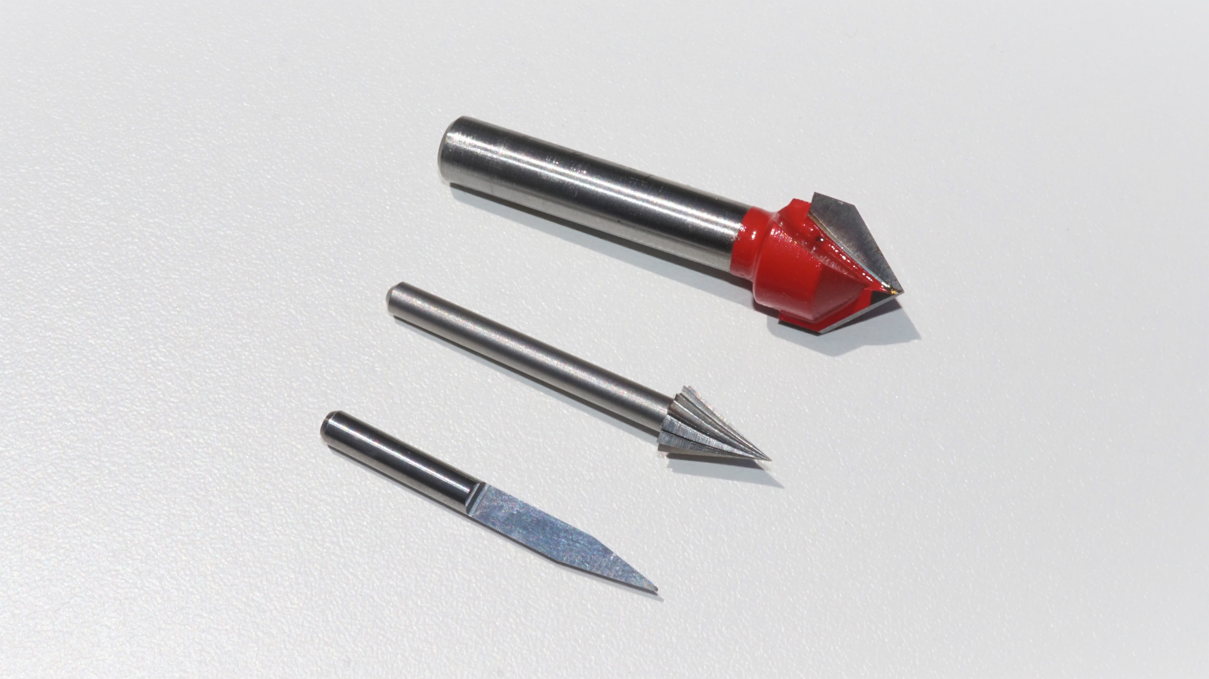

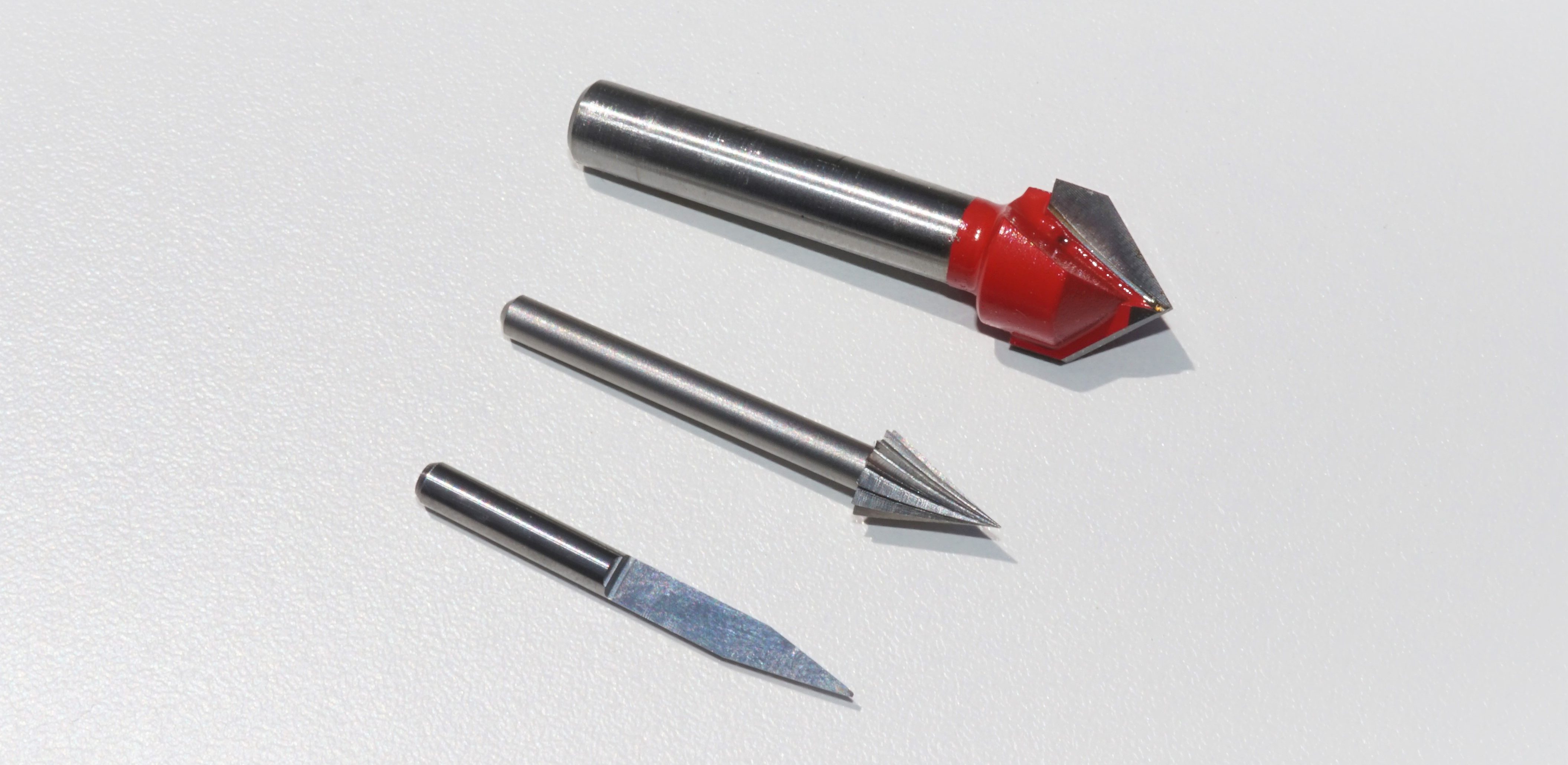

Lastly, v-bits have a much more specialized usage in sign-making, PCB milling and other forms of engraving where a 2-dimensional pattern is cut into a material blank. You can vary the depth of cut of the v-bit to vary the width of the engraving. This means that for very fine lines, the Mill One will make very shallow cuts with the v-bit, and for wider lines, make deeper cuts.
Since v-bits can come in a variety of cutting angles, ensure that your bit has the right angle for your application. Usually larger (60 degree and 45 degree) v-bits are used for making signs and doing other detailing work whereas smaller angles (30 degree and lower) are used for PCB milling to achieve small trace paths.
Flute number, direction, and chipload
The flutes on the cutting tools are the cutting edges that remove material but also act as channels which move chips and dust away from the cut. Most tools have two or four flutes, but you can find tools with any number of flutes. When an cutting tool has less flutes, more material can be cut away per flute, per rotation. This means that fewer flutes will remove material faster, at the downside of making rougher cuts, meanwhile having more flutes increases the chance of a smoother surface finish.
The ‘chipload’ on a cutting tool is important because as material is removed it takes a little bit of heat along with it, and if the tool or the material starts to heat up then you’ll get poor cuts and bad edge finish, you may even burn or melt your material and dull your cuttingtool. This is why fewer flutes are generally used on materials which can easily melt or weld themselves to the tool, such as plastics or aluminum.
The spiral direction of the flutes will also have an impact on the surface finish of the material. Since the shaft on CNC routers always spins clockwise, if the flutes wrap in a counter-clockwise direction then the downward spiral will eject the material downward, meanwhile the opposite will eject them upward. The downside to both downcut and upcut bits is that they can cause ‘tearout’ (material splintering or burring) on either the bottom or the top of the material respectively.
The solution to this is compression mills which spiral in both directions to ensure a smooth finish on both sides; however these bits are much rarer and come with a few of their own problems. You can also clamp a scrap piece of material either above (for upcut bits) or below (for downcut bits) the part that you wish to cut in order to reduce the amount of burring.
