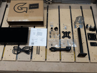

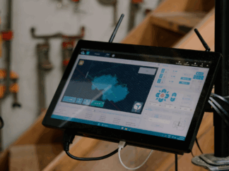

Our gControl Panel Computer is a touch-screen interface designed to be part of the full ecosystem for CNC machine control, working with gSender, AltMiIll and LongMill CNCs, and the SuperLongBoard family of controllers. It’s also a fully functional Windows computer that can run other programs; connect peripheral devices like a mouse or keyboard; even support an external display; and send commands.

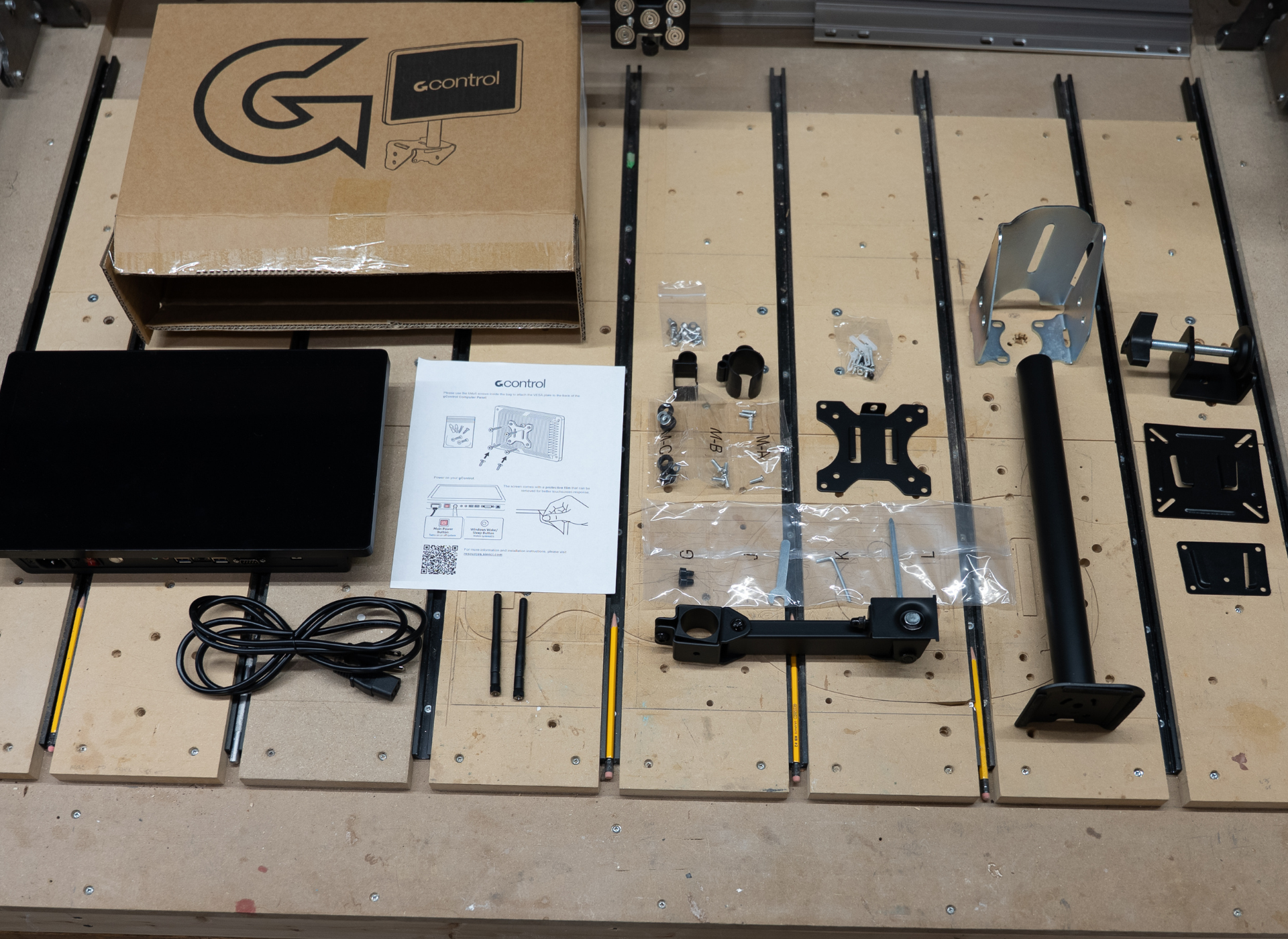

It can control any CNC machine that is already compatible with gSender, as well as run any other CNC control software that runs on Windows. When you purchase gControl you’ll also receive a mounting solution that works with all AltMills and LongMills, as well as many other workbenches.
gControl will ship in it’s own carton and may arrive separately from other orders.
gControl computers will ship in 2-3 business days.
65 in stock
Description

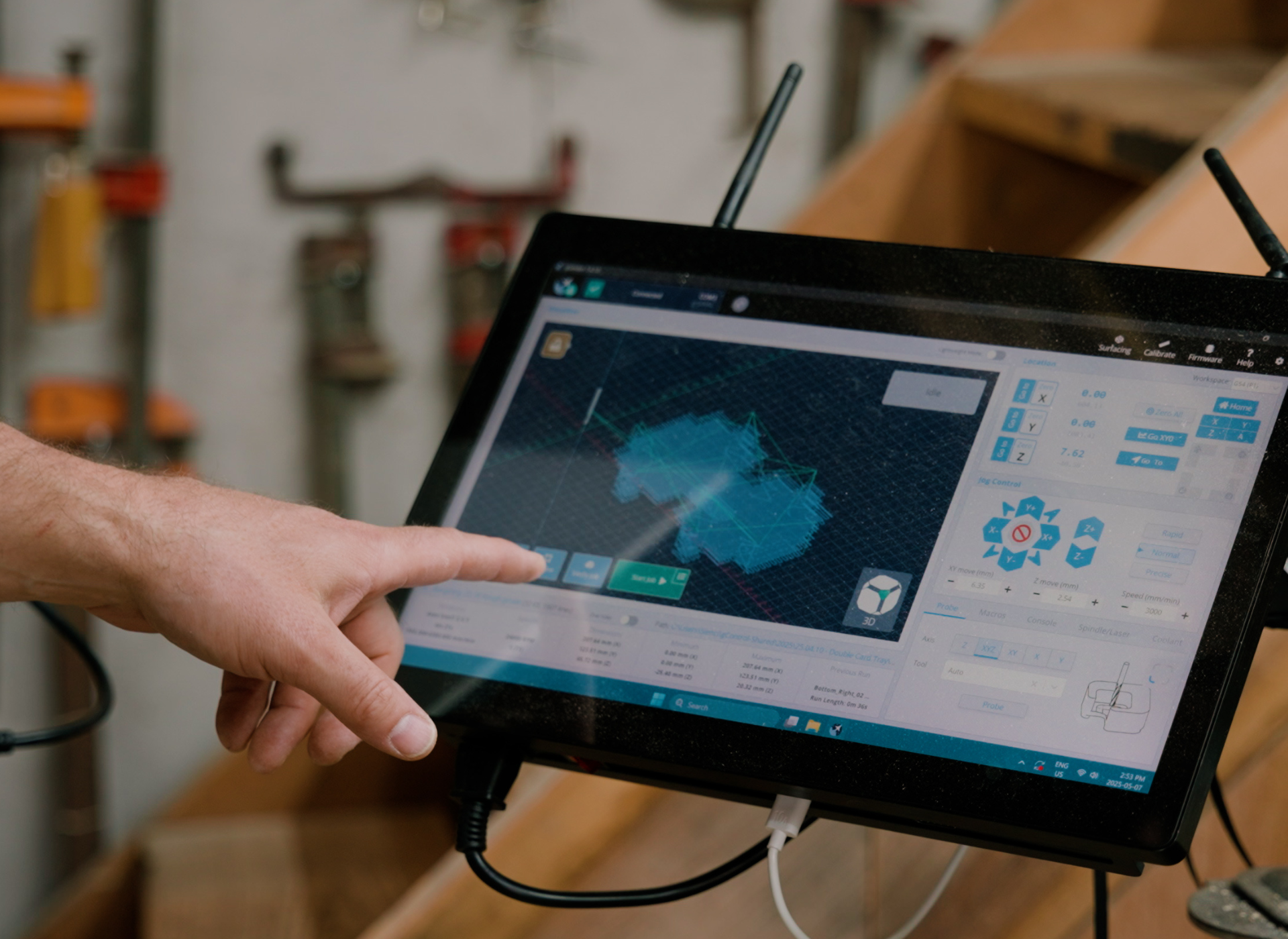

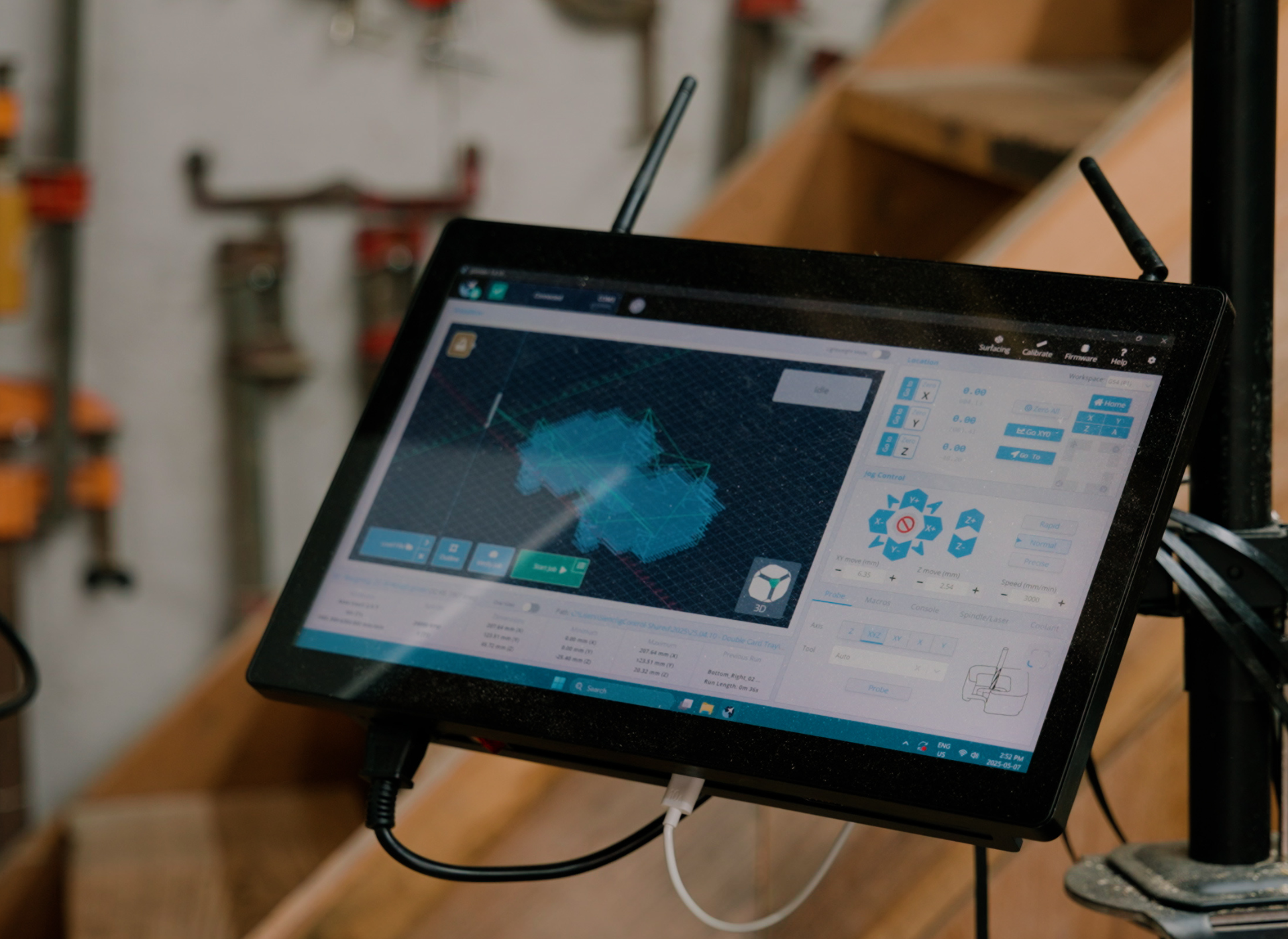

gControl controls your CNC machine, runs gSender and connects with your AltMill or LongMill. It’s a touchscreen interface that allows you to send commands, jogs, change settings, and send jobs, plus, it’s a fully functional Windows computer that can connect to other devices and run other software.
Some basic specs:
  • Screen: 1080P 15.6″ Touch Screen
  • Processor: Intel N100
  • Operating system: Windows 11
  • RAM: 8GB
  • Memory: 128GB
  • Connectivity: Ethernet, Wifi, Bluetooth, USB, HDMI

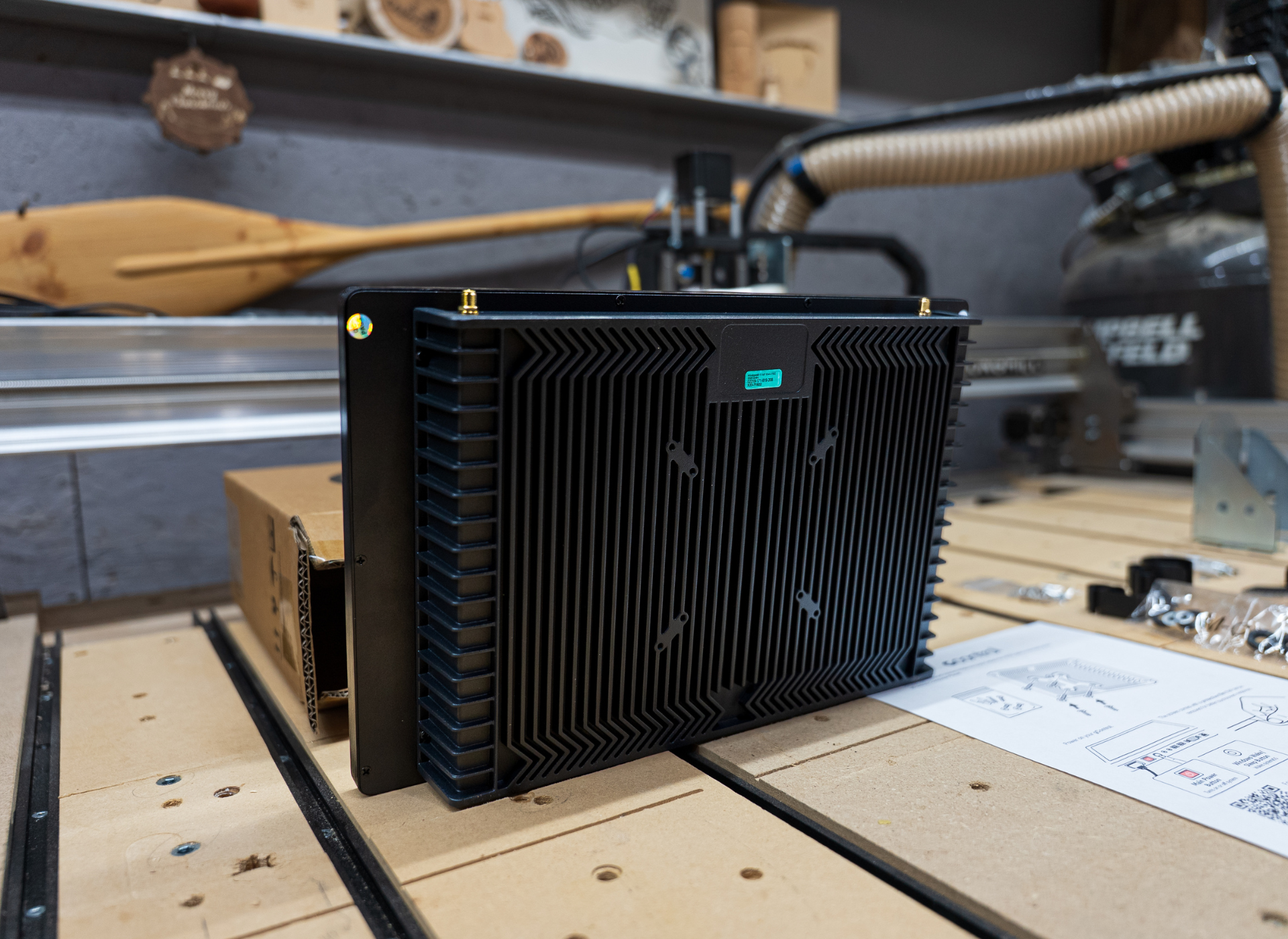

Operating System Microsoft Windows 11 IoT Enterprise LTSC (x64)
Processor Intel® Processor N100 6M Cache, up to 3.40 GHz
Display 15.6” touch screen 1080P resolution (1920×1080)
RAM 8GB DDR4-3200MHz (User upgradable to16 GB max, DDR4-3200MHz, single channel, no ECC support*)
Storage 128GB M.2 SATA SSD (6Gb/s)
Hardware Connectivity USB A (4 ports), HDMI, VGA, Ethernet, 3.5mm audio, 3.5mm microphone
Wireless Connectivity Wifi, Bluetooth 5.1
Power 110V/220V 50/60HZ compatible

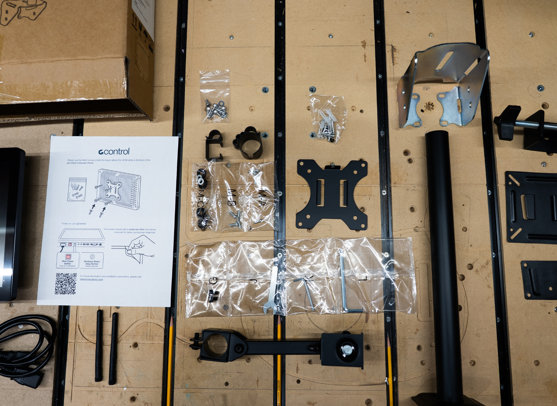

Our gControl panel is quite easy to set up, but check out our Resources page for quick answers and assembly help.
