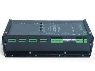

The LongBoard CNC controller is a powerful, three-axis CNC controller that acts as the brains and brawn of the LongMill. The four drivers are made to power any two-Y-axis CNC setup.
Each LongBoard comes with:
  • Fully assembled control board
  • Detachable screw terminals for motor and I/O connections
  • Pre-flashed and installed Arduino UNO with 1m USB cable
*Please note that your order of the LongBoard ships with the latest version of the controller. The latest version also comes with an external e-stop button.*
*Please note that your order of the LongBoard does not come with a power supply. If you require the power supply with your LongBoard, you can purchase one at the link here https://sienci.com/product/24v-12-5a-power-adapter-for-110vac/*
Order your CNC controller with or without the outer steel enclosure.
Details on the board design, Gerber files, and other design and assembly files can be found on our LongMill Open Source Page.
LongBoard documentation can be found here in the LongMill Resources.
Please note, if you have a MK1 machine, you will need to flash your firmware to the correct machine profile. You can learn how to flash your firmware here. https://resources.sienci.com/view/lmk2-grbl-firmware/#flashing-grbl-using-gsender

The LongBoard is a powerful, all in one control board running the GRBL Firmware designed for use with 3-axis small to medium size CNC machines.
Input power
Voltage: 24V-48V
Current: Max 16A
We recommend using our 24V 10A power supply with your LongBoard.
Drivers
The LongBoard uses four Toshiba TB6600 drivers, with one driver used for the X and Z-axis, and two for the Y-axis.
Microstepping: 1, 1/4, 1/8, 1/16
Max current: 4A
Firmware
The LongBoard comes pre-flashed with the latest LongMill firmware on an Arduino UNO
I/O
The LongBoard comes with several inputs and outputs supported by the GRBL firmware. These include:
  • Spindle/laser control
  • Coolant control
  • Probe input
  • X, Y, Z homing/limit switches
  • 12V auxiliary power for active fan cooling
  • Buttons for Play, Pause, and Stop
  • Power switch
