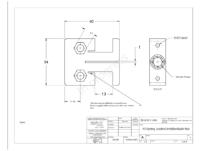

The T8 Spring Loaded Anti-Backlash Nut is designed to be the successor to the regular T8 Delrin Anti-Backlash Block. The springs are designed to radially load the lead screws to adjust for backlash, leading to smoother movement and no adjustments after assembly.
The Spring Loaded Anti-Backlash Nut is made for T8 type 4 start 2mm pitch ACME lead screws like on the LongMill and provides high precision and repeatability with near-zero play or slop in the linear motion.

Threading: T8 8mm 4 start
Pitch: 2mm/rotation

V3 Spring Loaded Anti Backlash Nut
