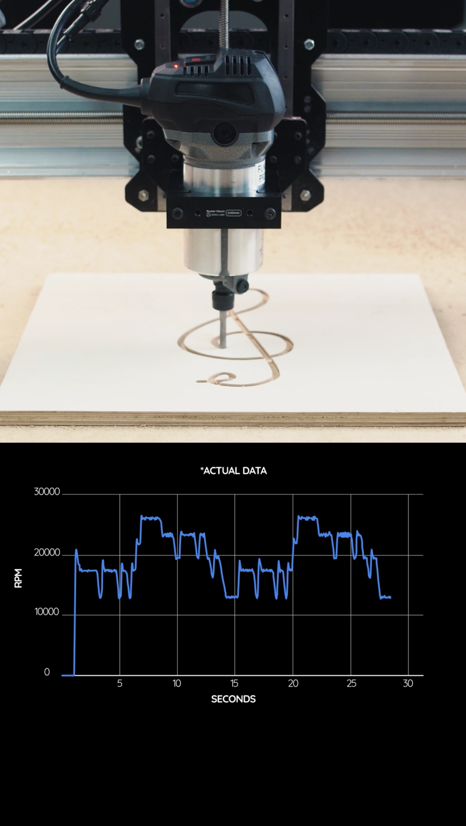

Watch the video to see and hear the prototype in action 🎵
Want to Learn More?
