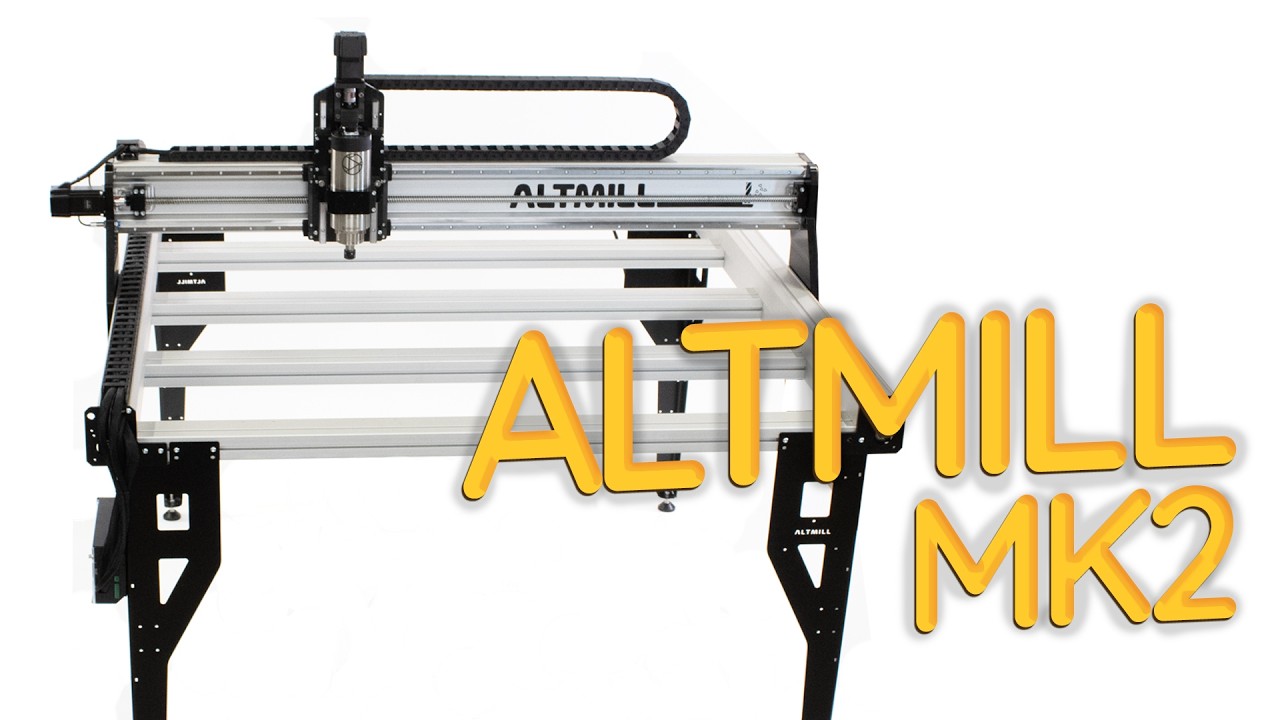

The AltMill represents the pinnacle of hobby CNCing, bringing industrial-level technologies to a price point and ecosystem for both beginners and advanced users. This kit comes with a standard 80mm spindle mount, however it does not come with a spindle which must be purchased separately.

    • Rigid frame and linear motion design using HGR15 linear guides and ball screws on all axis mounted to a custom-designed, machined aluminum extrusion
    • Closed loop stepper motors for over 600IPM
    • Support for 80mm spindles and routers
    • Approximately 49″ by 49″ inch working area with a max Z-height of 5.5″
    • Footprint of 59″ wide and 62″ deep (detailed PDF drawings found here: AltMill MK2 4×4 Key Dimensions and AltMill Table Leg Dimensions)
    Included in the Kit
    • SLB-EXT controller
    • Partially pre-assembled rigid frame
    • Inductive sensors for homing included
    • Sturdy metal legs with the ability to add 4ft wide shelving underneath
