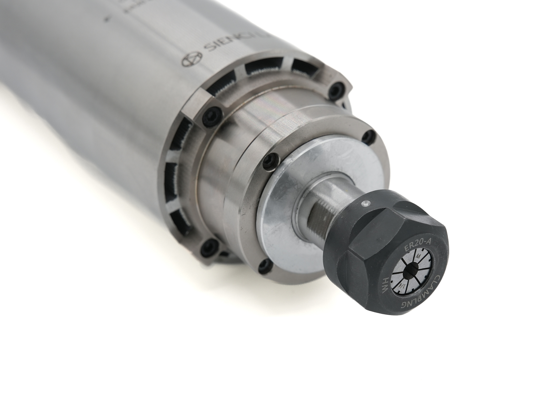

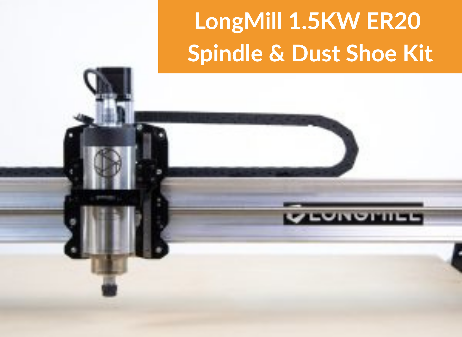

The LongMill 1.5KW ER20 Spindle & Dust Shoe Kit is designed to unleash the cutting capabilities of the LongMill, as a plug-and-play add-on.*
Each kit comes with:
  • 80mm Dust Shoe

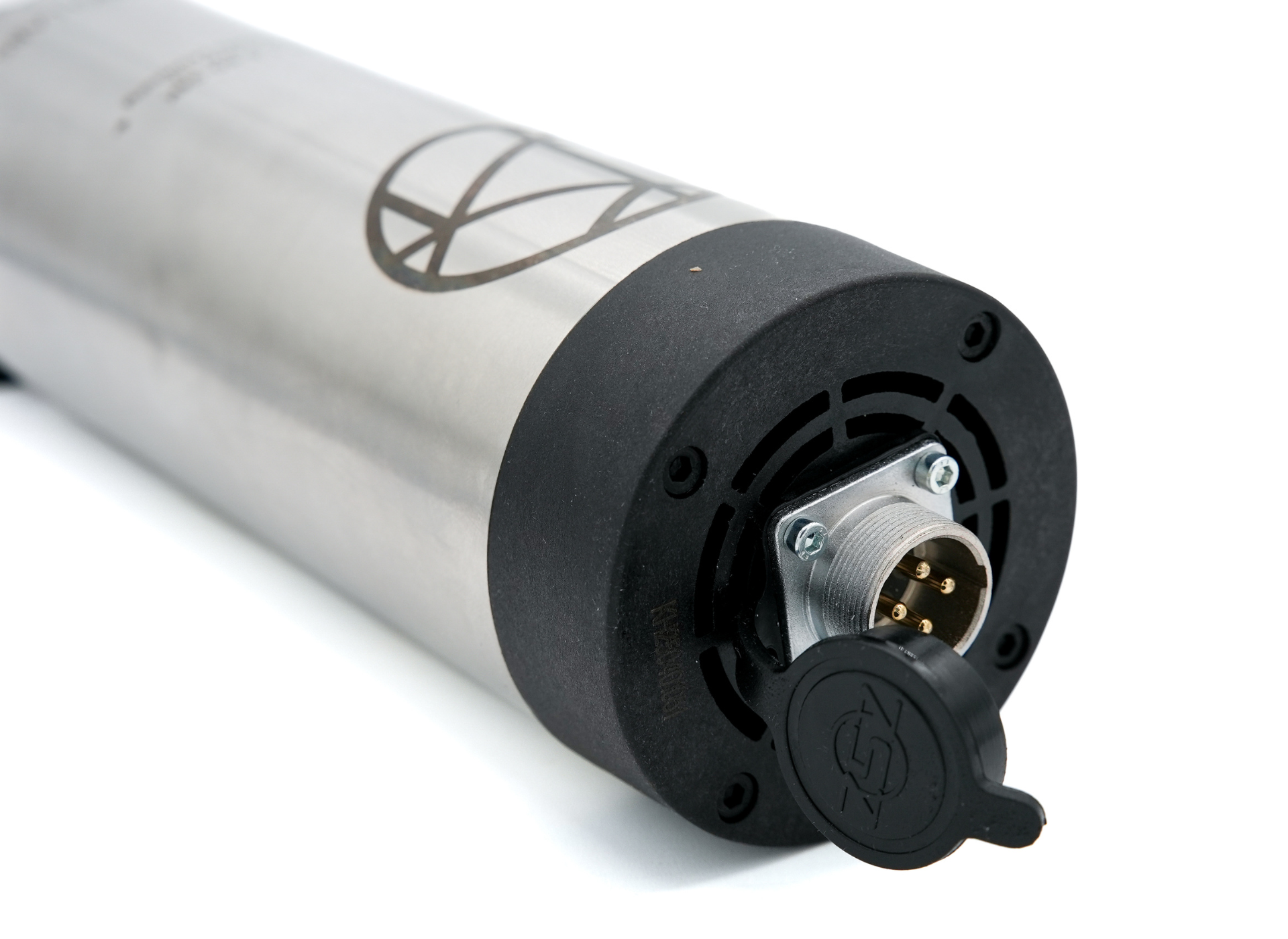

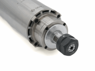

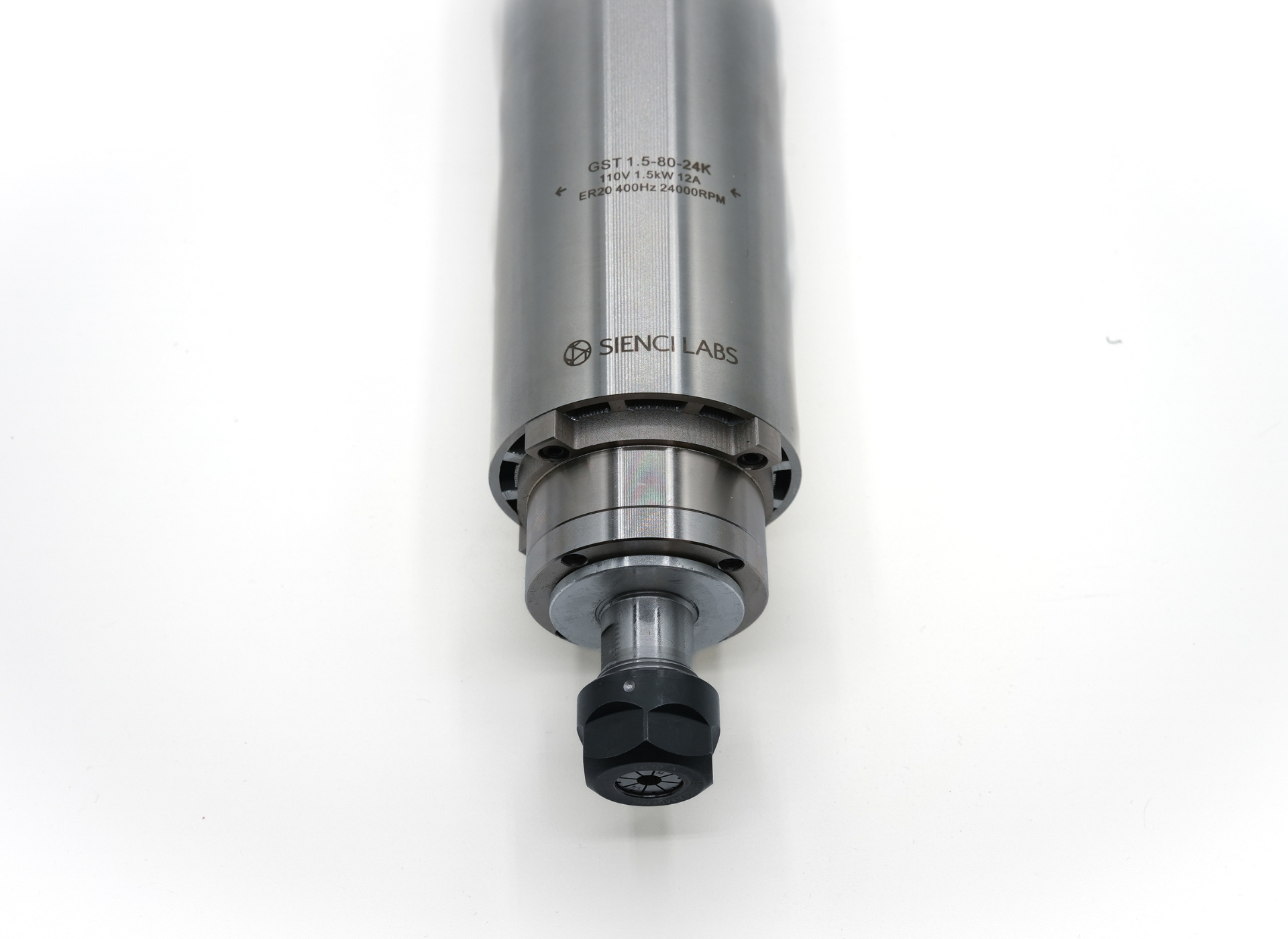

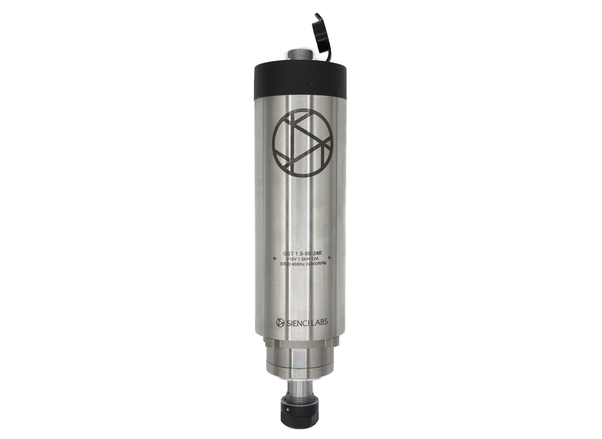

  • ER20, 80mm, 1.5KW 110V Air-Cooled Spindle
  • 110V, 1.5KW, 3-Phase output VFD

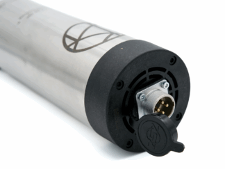

  • AC power cable and 5m spindle power cable

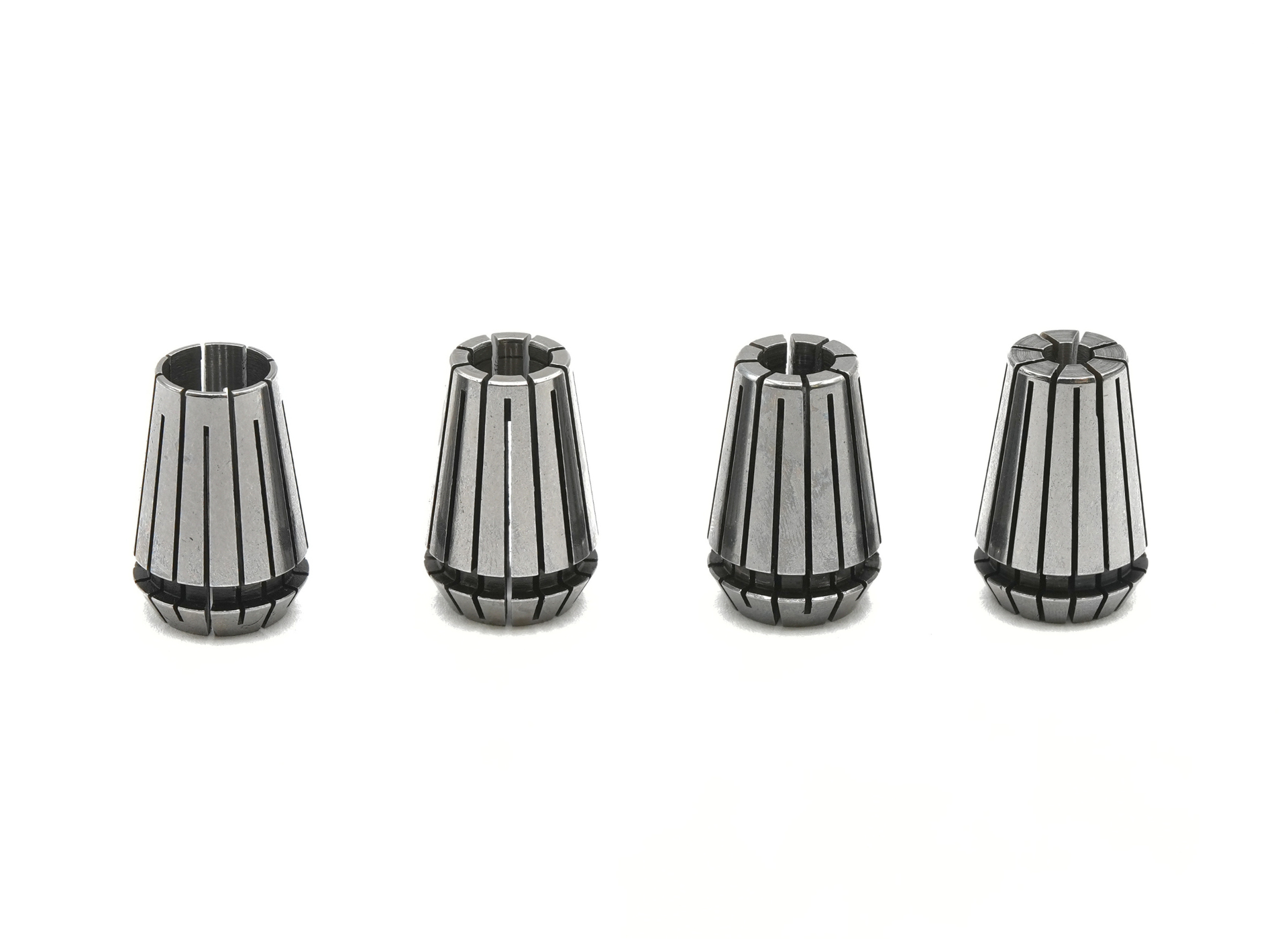

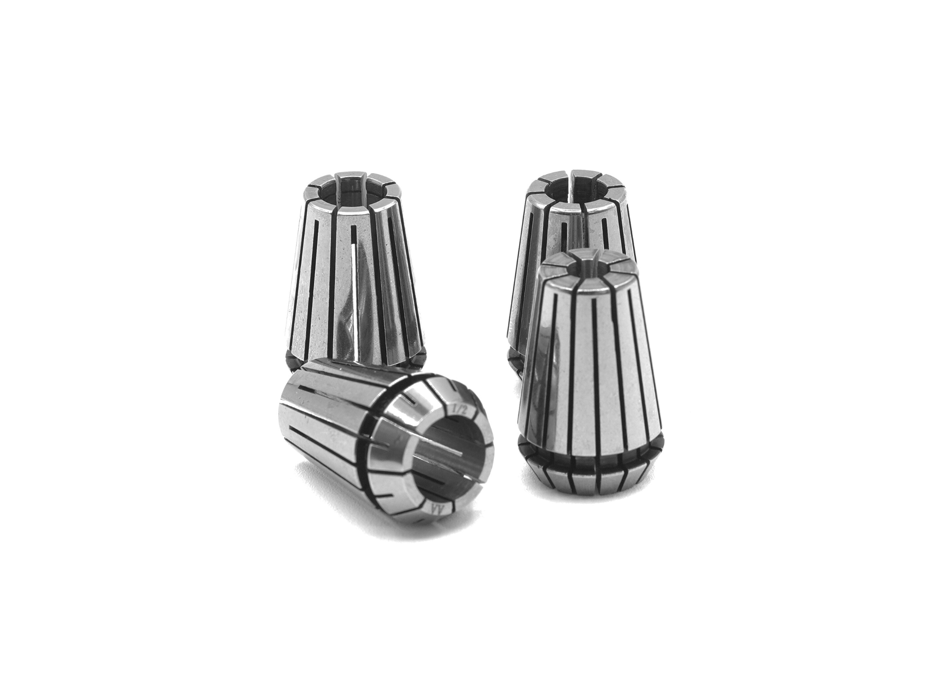

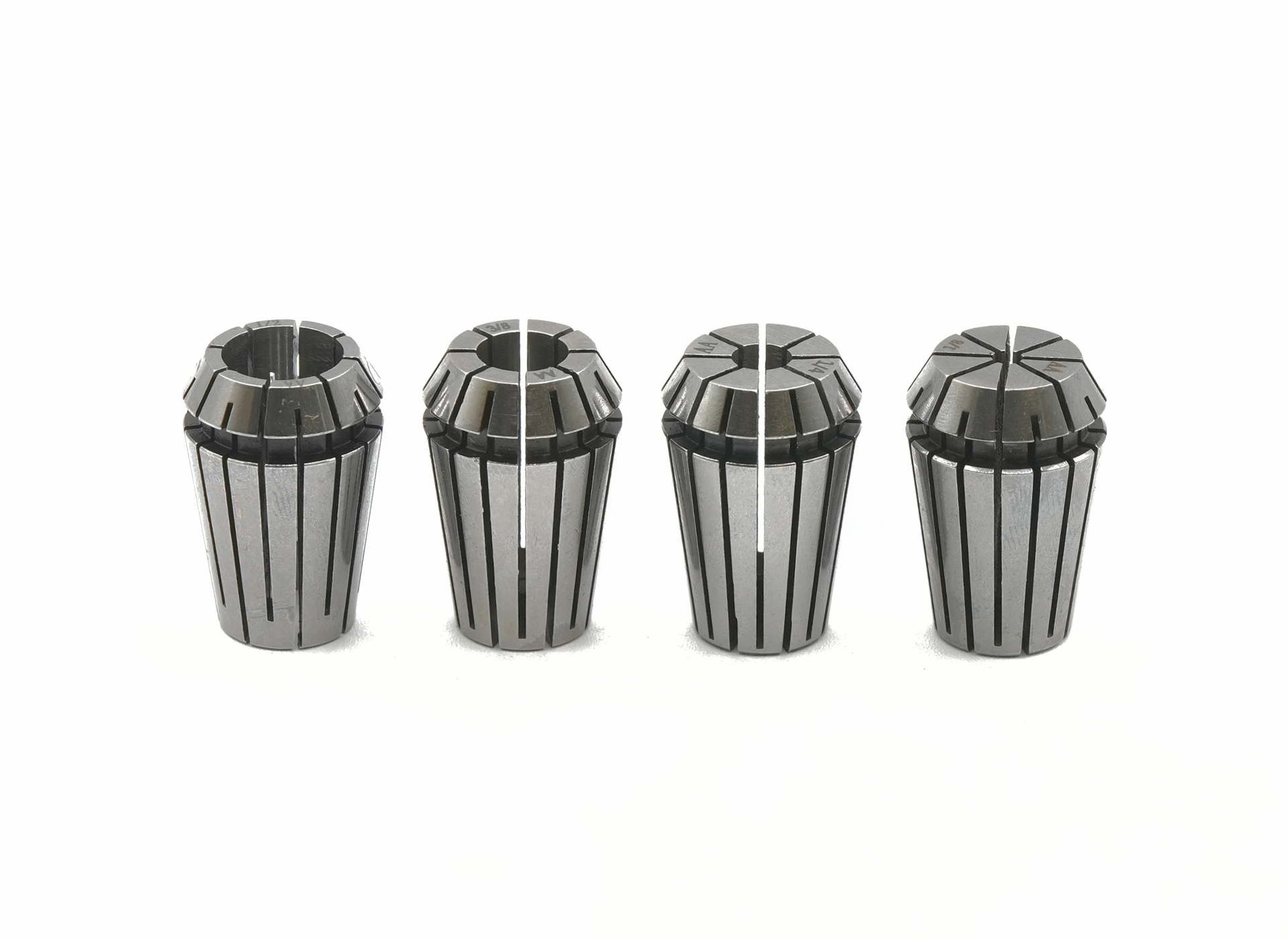

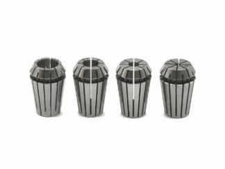

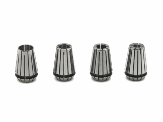

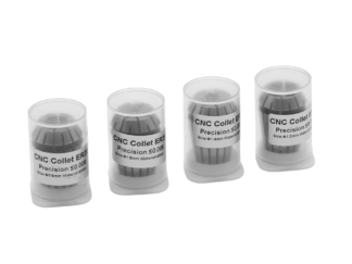

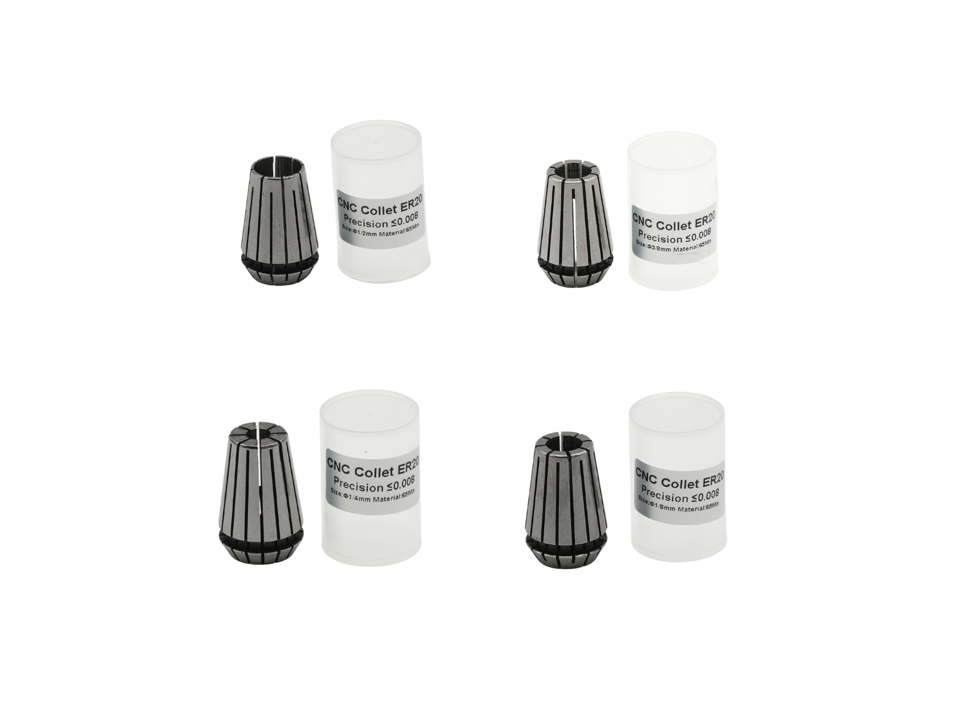

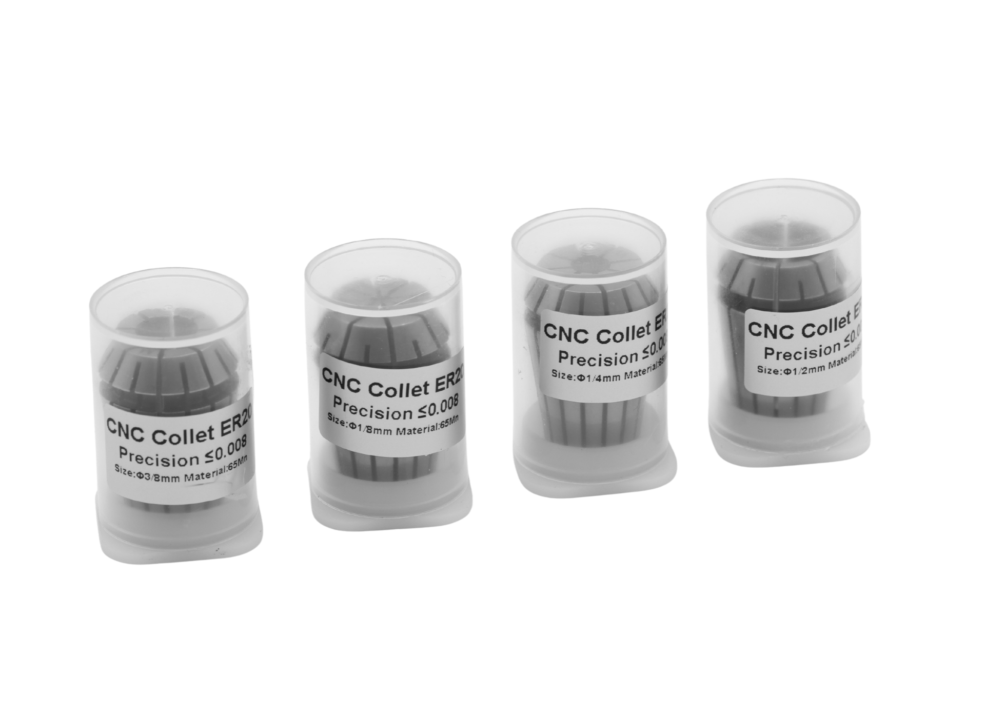

  • ER20 1/8, 1/4″, 3/8″and 1/2″ collets (one of each size)
  • Data cable to connect to the SuperLongBoard controller for remote speed control
  • 80mm Spindle Mount also included
*The Spindle is NOT plug-and-play compatible for machines with the original LongBoard (MK1 and MK2),  support and resources are limited for implementing this set up. Please read this article for more information on compatibilityCustomers who have a LongMill MK2.5 do NOT need to purchase the SLB. Due to the spindle’s weight we would recommend energizing the Z-axis which can be toggled through the $37 firmware setting.

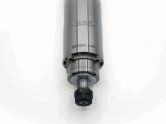

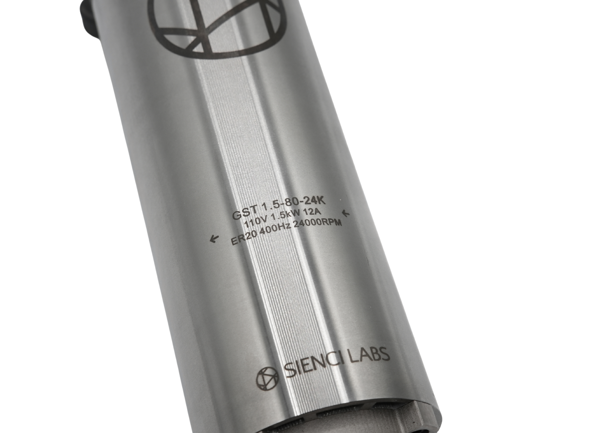

***Spindle and VFD Specifications***
  • Spindle body diameter: 80mm
  • ER Collet System: ER20
  • Weight: Spindle, appx 5.4KG or 11.9lbs
  • RPM range: 7,500 to 24,000 RPM
  • Power: 1.5KW (2HP)
  • Voltage: 110V/120V AC, single phase, NEMA 5-15P plug included
