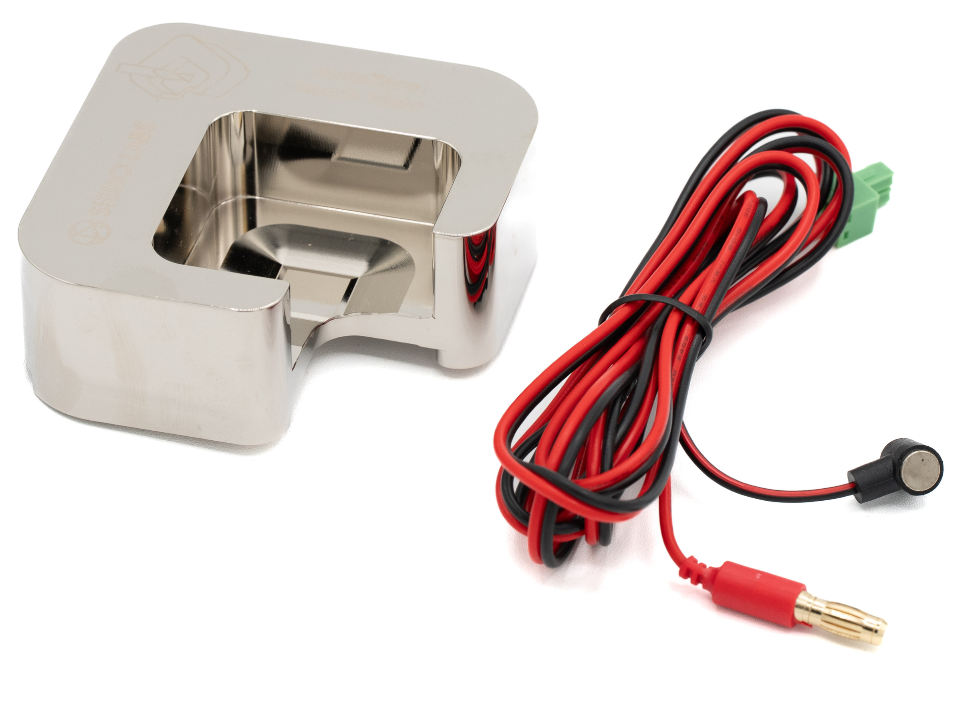

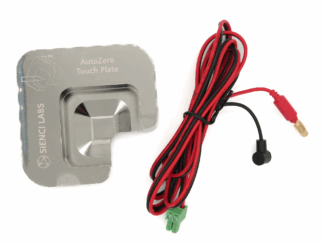

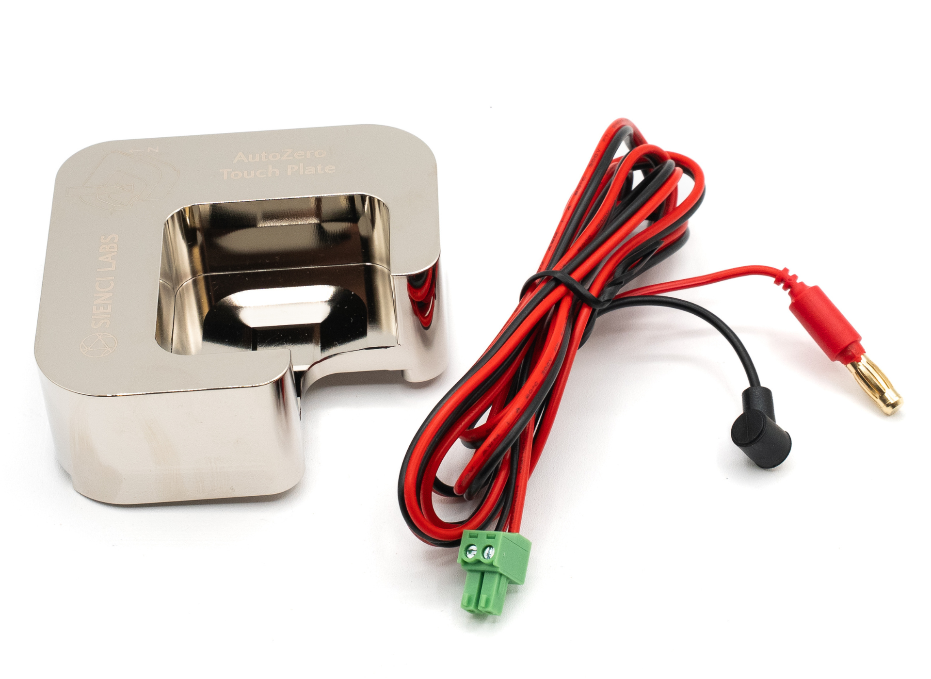

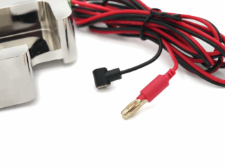

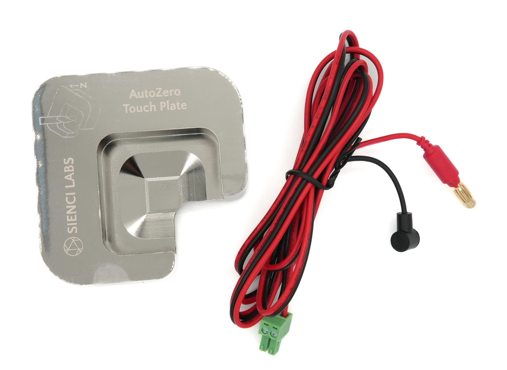

The AutoZero Touch Plate is Sienci’s revolutionary CNC touch plate that allows for automatic zero-setting in all X, Y and Z directions, with both straight and irregularly shaped bits (v-bits, ball nose and tapered.)
Engineered by our team, the AutoZero allows for a fully streamlined probing experience:
  • Skip the process of measuring or assuming the tool size before probing
  • No more need to probe with a straight-edged bit to find zero before starting a 3D contour or v-carve
  • Corner cutout allows tool to go to zero to confirm successful probing
Unlike most conventional touch plates, the AutoZero’s unique chamfered-edge geometry, symmetry and tall walls allows it to automatically measure and calculate the size and position of the bit you’re using, with extreme accuracy. Plus, when combined with our gSender control software, users can run all functions through pre-built settings to have a seamless zeroing experience without having to mess around with custom macros.
***Read Description Below For More Highlights***
Description
Other highlights include:
  • Special nickel coating for higher surface conductivity to improve touch-off sensitivity

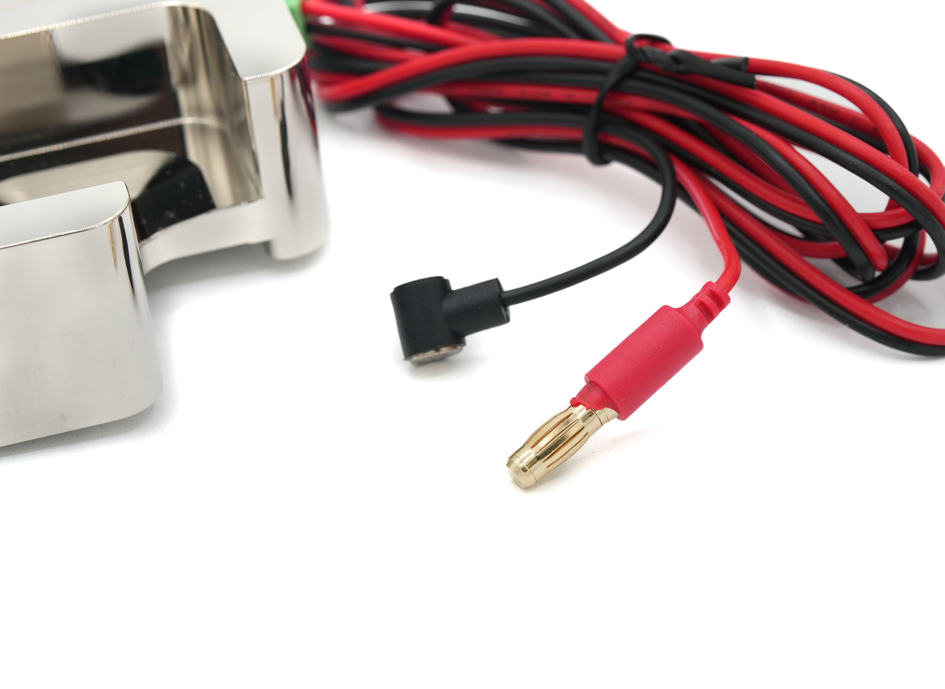

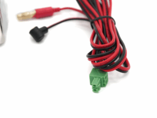

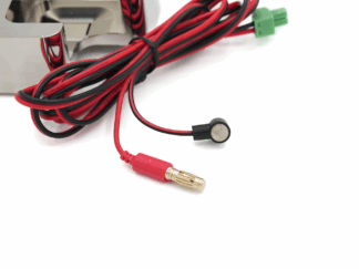

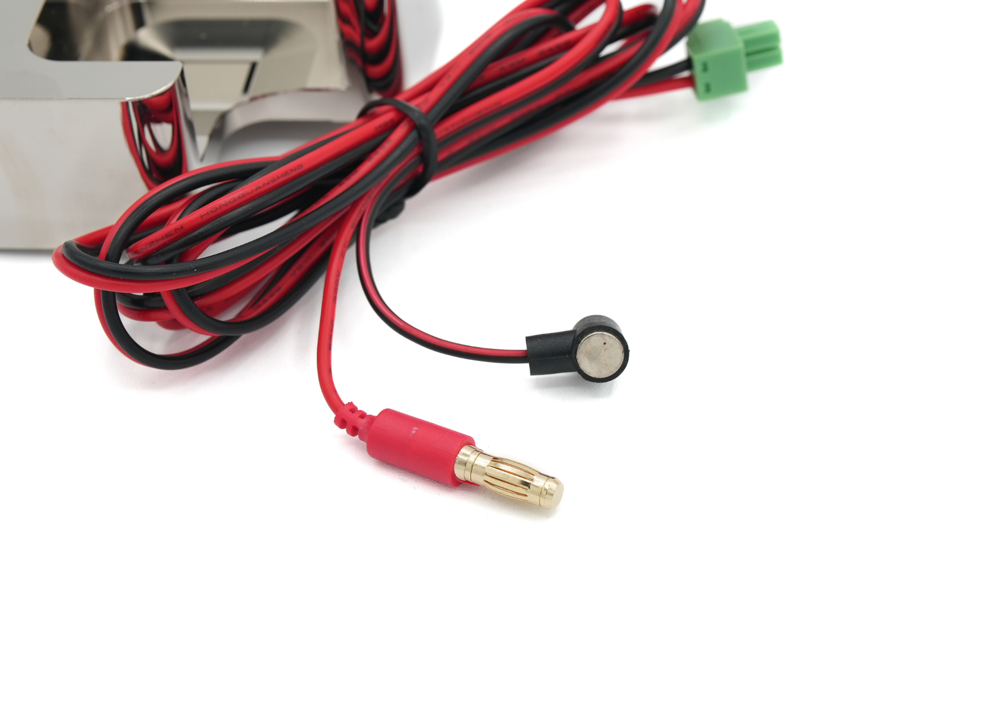

  • Each set comes with a 5ft cable with a strong neodymium magnet and gold plated 5mm ECS5 jack for easy connection to two spots on the touch plate
  • Guaranteed compatibility with our LongMill and AltMill CNCs, and likely compatible with other CNC routers with 2-wire, NO probe connections (like Shapeoko, 3018, etc.)
  • Works seamlessly out-of-the-box with the gSender CNC control software
  • Macros and documentation available for other senders too like CNCjs, LinuxCNC, Buildbotics, UGS, and more
  • Currently set up for Front, Left corner probing only – support for other options coming to gSender soon
