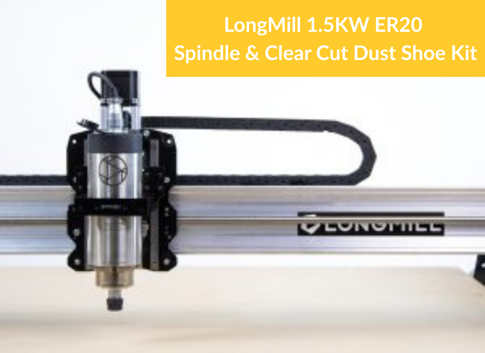

The LongMill 1.5KW ER20 Spindle & Clear Dust Shoe Kit is designed to unleash the capabilities of the LongMill cutting potential as a plug-and-play add-on.* This kit features the upgraded Clear Cut Dust Shoe, which allows for easier tool changes and height adjustments, quick hose clamp connection and clear views of your carves. The enclosed VFD is easy to mount, easy to install, and has a power-on/off switch. It also includes an 80mm spindle mount.
Each kit comes with:
  • 80mm Clear Cut Dust Shoe
  • ER20, 80mm, 1.5KW 110V Air-Cooled Spindle
  • 110V, 1.5KW, 3-Phase output VFD
  • AC power cable and 5m spindle power cable
  • ER20 1/8, 1/4″, 3/8″and 1/2″ collets (one of each size)
  • Data cable to connect to the SuperLongBoard controller for remote speed control
*The Spindle is NOT plug-and-play compatible for machines with the original LongBoard (MK1 and MK2),  support and resources are limited for implementing this set up. Please read this article for more information on compatibility. Customers who have a LongMill MK2.5 do NOT need to purchase the SLB. Due to the spindle’s weight we would recommend energizing the Z-axis which can be toggled through the $37 firmware setting.

***Spindle and VFD Specifications***
  • Spindle body diameter: 80mm
  • ER Collet System: ER20
  • Weight: Spindle, appx 5.4KG or 11.9lbs
  • RPM range: 7,500 to 24,000 RPM
  • Power: 1.5KW (2HP)
  • Voltage: 110V/120V AC, single phase, NEMA 5-15P plug included
  • 80mm Spindle Mount also included
***Dust Shoe Specifications***
  • Spindle diameter: Compatible with 80mm spindles
  • Hose diameter: Compatible with 4″ standard hose
***Spindle VFD***
  • VFD: Canadian customers will receive an enclosed, Ontario ESA approved VFD // EMI filtering for electrical noise reduction. All international customers will receive an enclosed VFD // EMI filtering for electrical noise reduction.
