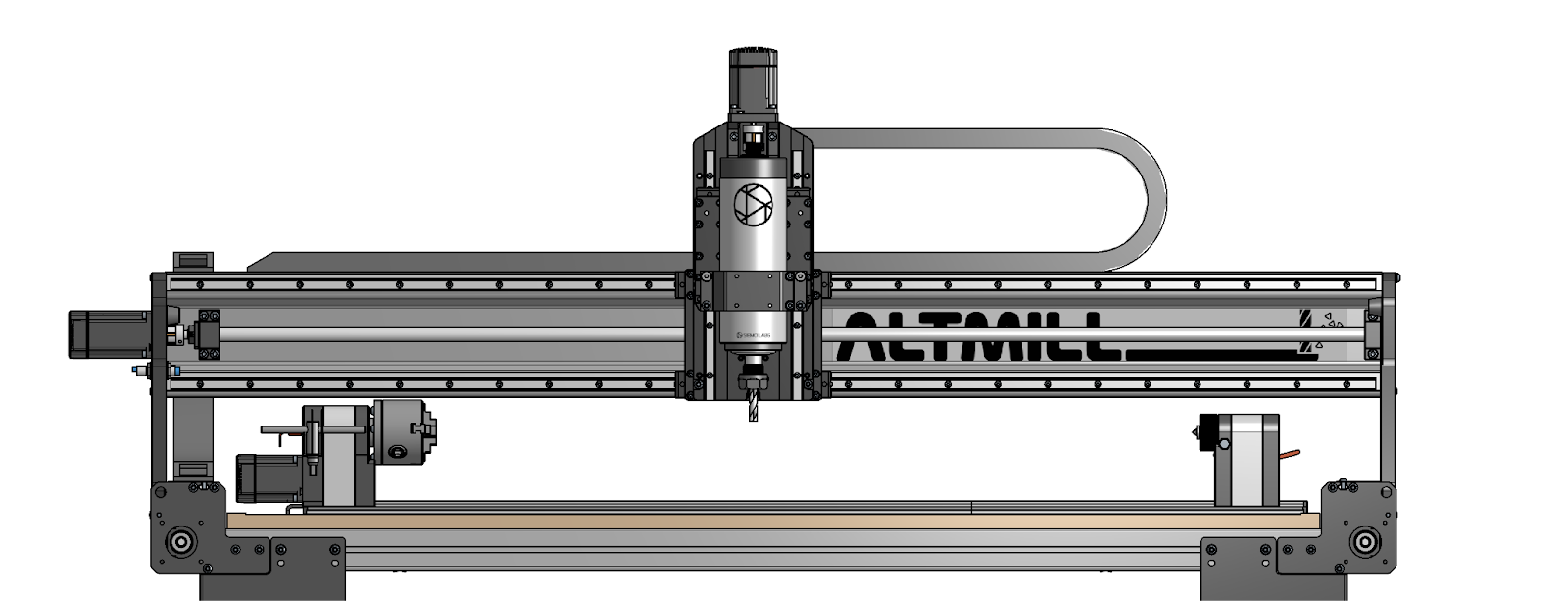

First install of close loop stepper and AltMill
A novel feature of the Vortex Rotary Axis kit not seen with any other rotary axis add-ons is the use of a rotary switching module which ‘intercepts’ power going from the motor drivers to the Y-axis motors and instead sends this to the A-axis, allowing for use of an A-axis which would otherwise be impossible with any regular 3 axis CNC controllers such as the original ‘LongBoard’ controller used on the LongMill.
