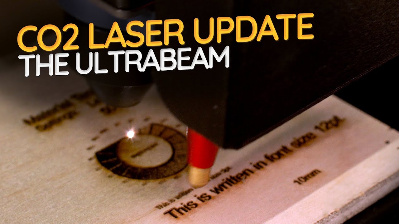

We’re thrilled to share an update on the progress of our CO2 laser project – introducing the UltraBeam! After nearly a year of development in CO2 laser technology, we’re eager to share what we have accomplished and what we’re currently working on.
Understanding CO2 Laser Technology
The UltraBeam combines CO2 laser technology with a CNC platform, offering precision and versatility. Like a CNC router, it uses computer control, but instead of traditional tools, it employs a CO2 laser beam for cutting and engraving materials with exceptional accuracy. This integration enhances its capabilities, making it a powerful tool for various applications.
UltraBeam Specifications: Redefining Speed, Precision, and Power
At the core of the UltraBeam lies its potent CO2 laser, boasting an impressive optical power of 75W. Surpassing typical diode lasers, this power ensures swift operations, with a maximum speed of 600mm per second. Coupled with its spacious work area of 24 inches by 36 inches, the UltraBeam accelerates project completion and broadens the scope of potential applications.
Imagine the UltraBeam moving at ten times the speed of your average CNC router. This feat is achieved through meticulous optimization of its mechanics, resulting in remarkable agility and accuracy. Experience consistently smooth and precise outcomes with every use, setting new standards in speed and precision.
