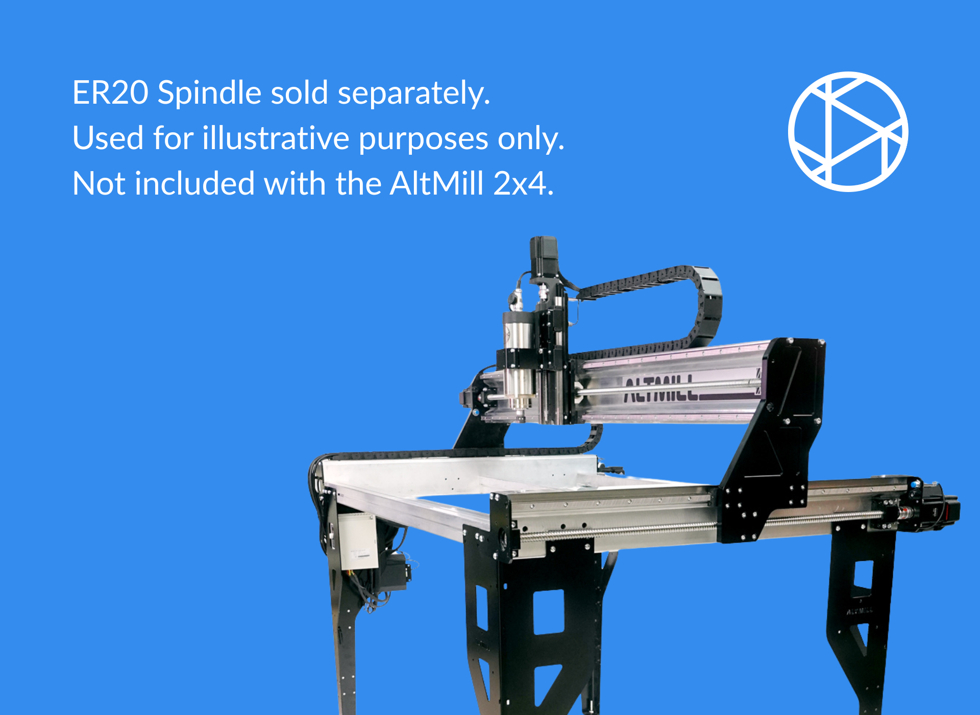

The AltMill is the pinnacle of hobby CNCing, bringing industrial-level precision to a price point and ecosystem for both beginners and advanced users. The AltMill MK2 2×4 is your go-to CNC when time, performance and precision are crucial for production-level reliability.
The AltMill MK2 2×4 comes with a standard 80mm spindle mount only. It does not come with a spindle, which must be purchased separately.
This product has a lead time. View current lead times.
Ontario, Canada Customers: Starting April 29th, we’ll be pausing sales for all sizes of AltMill. Please read further on specific plans for each machine – ESA Compliance.
Lead Time: 1 week
Description
Highlights:
  • Production level cutting speeds (approx. 600 inches/minute)
  • Closed loop motor system on all three axis to auto-correct positioning and auto-stop when necessary (reliable for production style work)
  • Requires little maintenance during project production
  • Advanced, production-style features including Y-axis auto-squaring; limit switches by default; and tram adjustment capabilities
  • Cuts materials ranging from hardwoods to plastics, foams, composites, aluminum – even steel
  • Support for 80mm spindles and routers
  • 25″ x 49″ working area with a max Z-height of 5.5″
  • Footprint of 59″ wide and 38″ deep

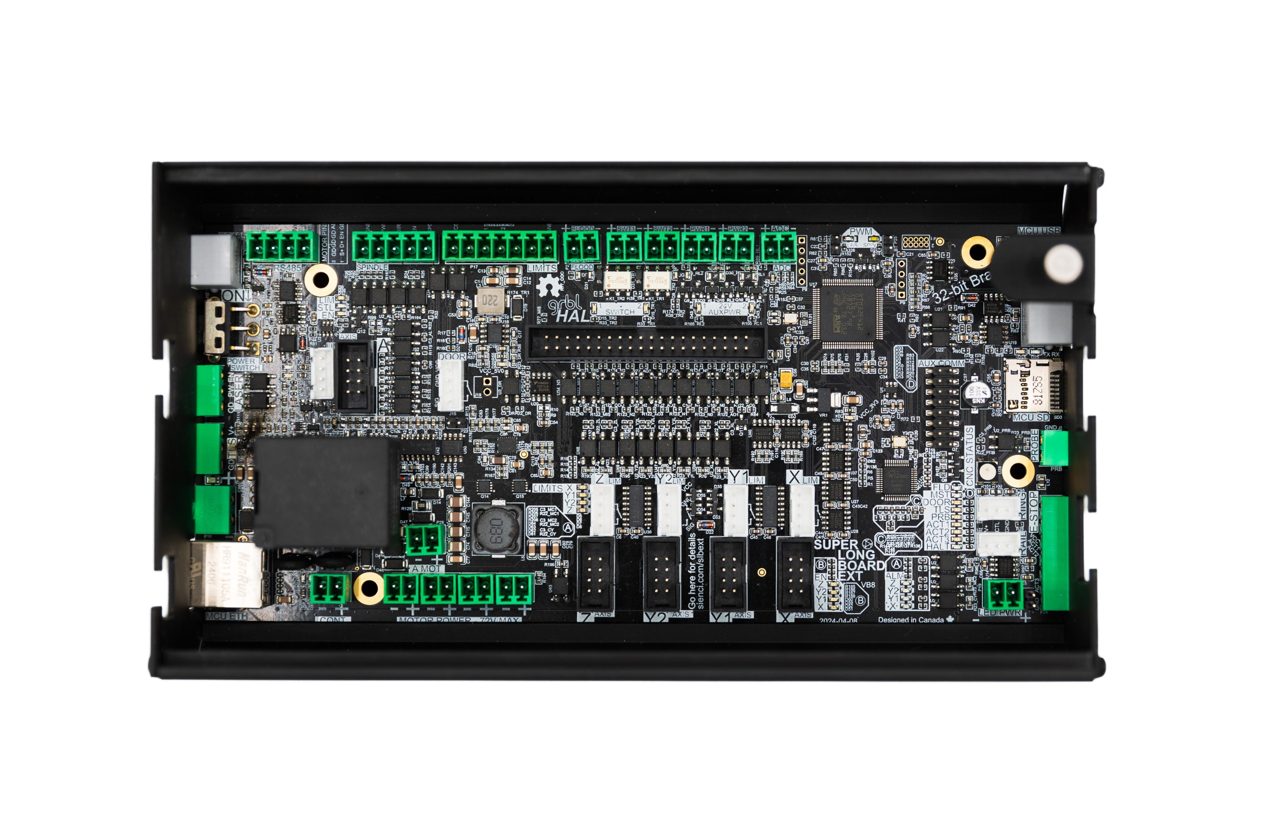

  • SLB-EXT controller and emergency stop

  • ATC Expansion Board for an SLB-EXT Controller
