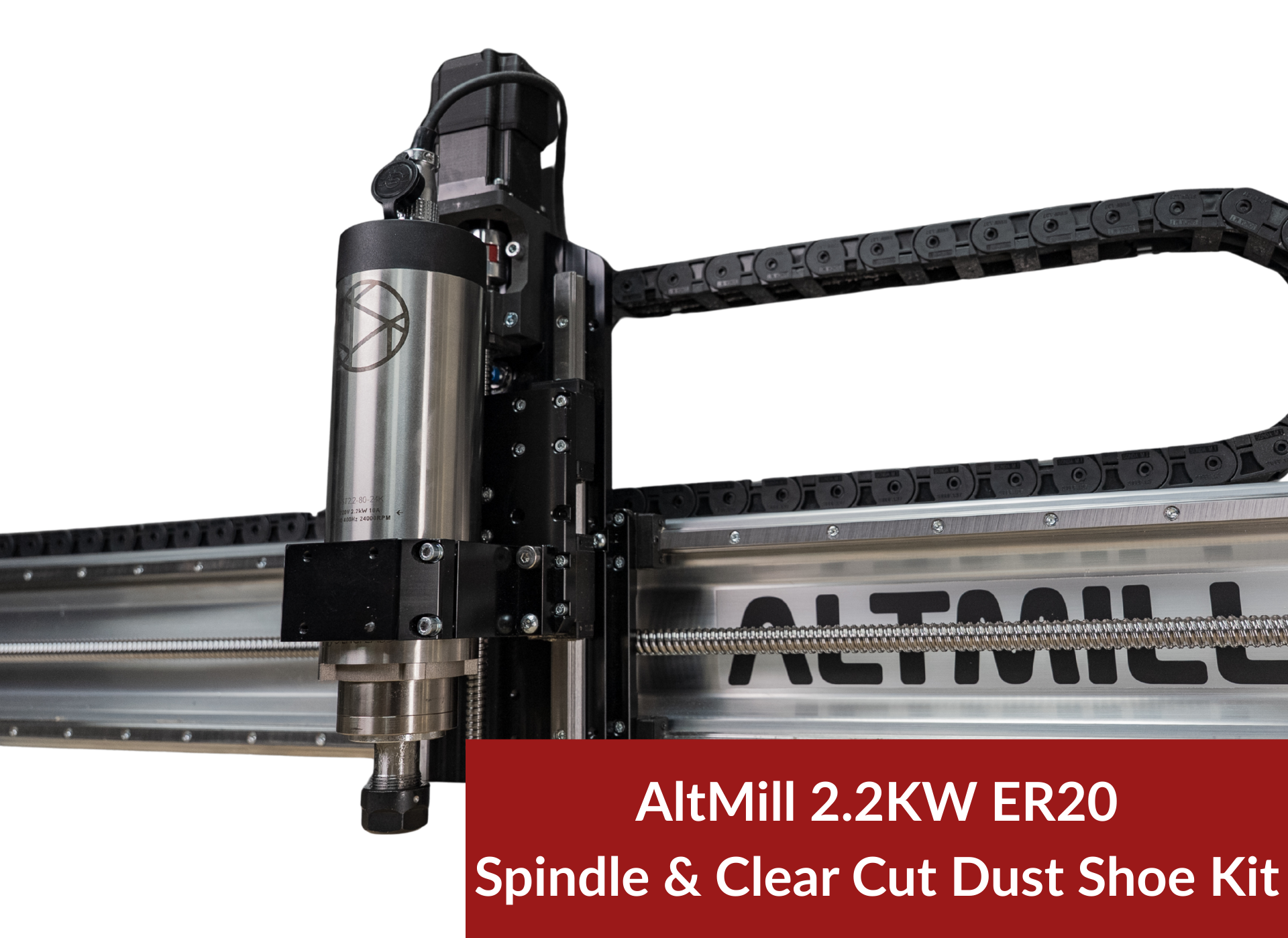

The AltMill 2.2KW ER20 Spindle & Clear Dust Shoe Kit is designed to unleash the capabilities of the AltMill cutting potential as a plug-and-play add-on. This kit features the upgraded Clear Cut Dust Shoe, which allows for easier tool changes and height adjustments, quick hose clamp connection and clear views of your carves. The enclosed VFD is easy to mount, easy to install, and has a power-on/off switch.
Each kit comes with:
  • 80mm Clear Cut Dust Shoe
  • ER20, 80mm, 2.2KW 220V Air-Cooled Spindle
  • 220V input, 2.2KW, 3-Phase output VFD

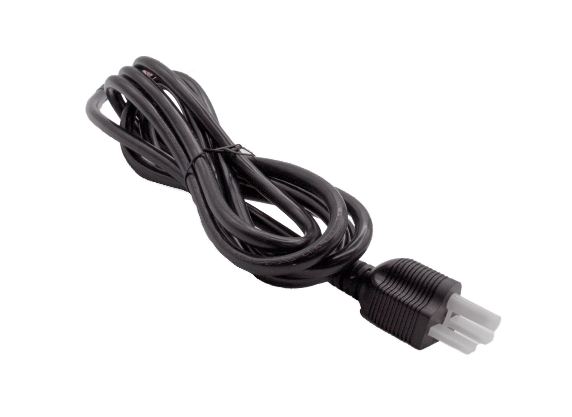

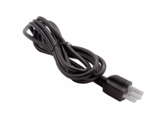

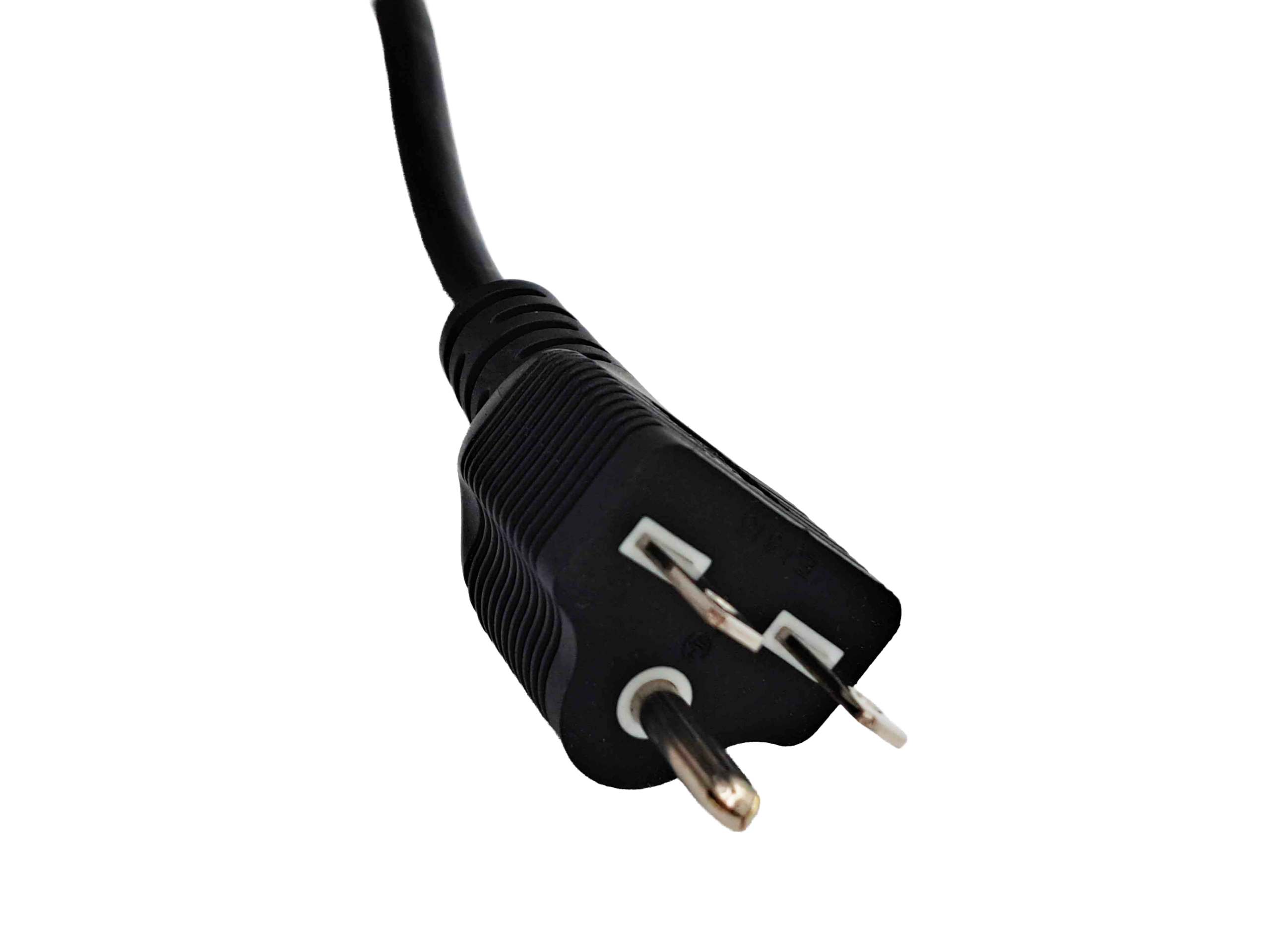

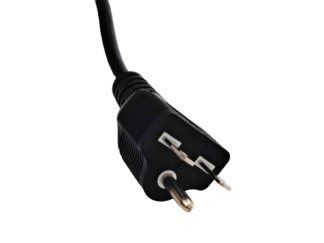

  • NEMA 6-15P AC power cable
  • Spindle power cable (5m for 2×4/4×4, 7.2m for 4×8)
  • ER20 1/8, 1/4″, 3/8″ and 1/2″ collets (one of each)
***If you are purchasing this with your AltMill, we can ship it at the same time as your machine (if applicable.)
***Please select the AltMill machine size you will be using with this spindle***
Lead Time: 1 week
Description
***Spindle and VFD Specifications***
  • Spindle body diameter: 80mm
  • ER Collet System: ER20
  • Weight: Spindle, appx 5.4KG or 11.9lbs
  • RPM range: 7,500 to 24,000 RPM
  • Power: 2.2KW (3HP)
  • Voltage: 220V/240V AC, single phase, NEMA 6-15P plug included
***Dust Shoe Specifications***
  • Spindle diameter: Compatible with 80mm spindles
  • Hose diameter: Compatible with 4″ standard hose
***Spindle VFD***
  • VFD: Canadian customers will receive an enclosed, Ontario ESA approved VFD // EMI filtering for electrical noise reduction. All international customers will receive an enclosed VFD.
