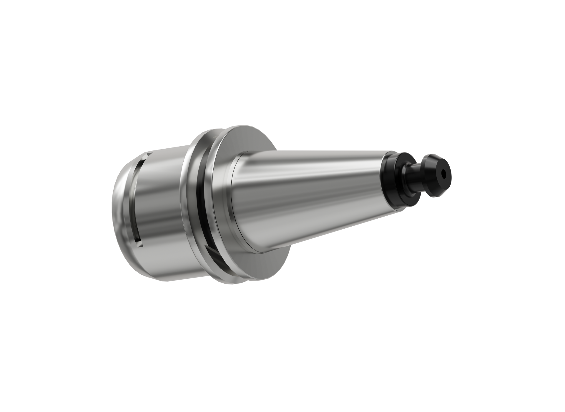

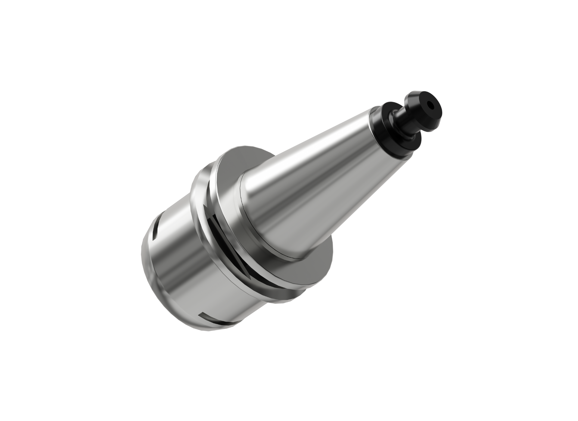

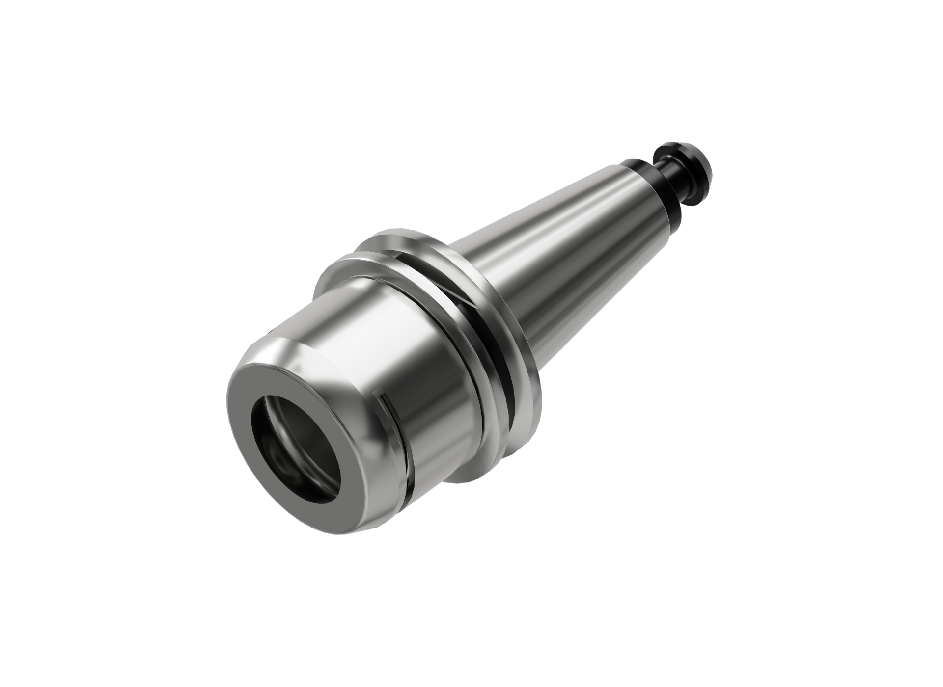

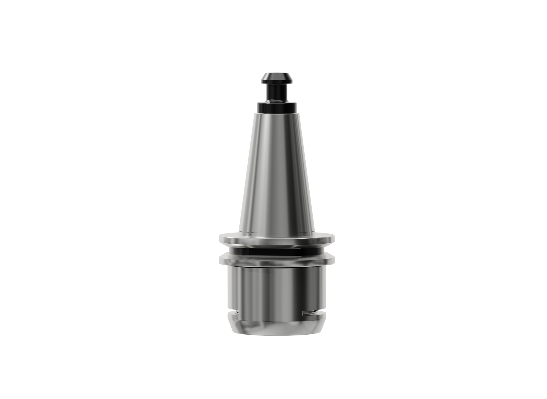

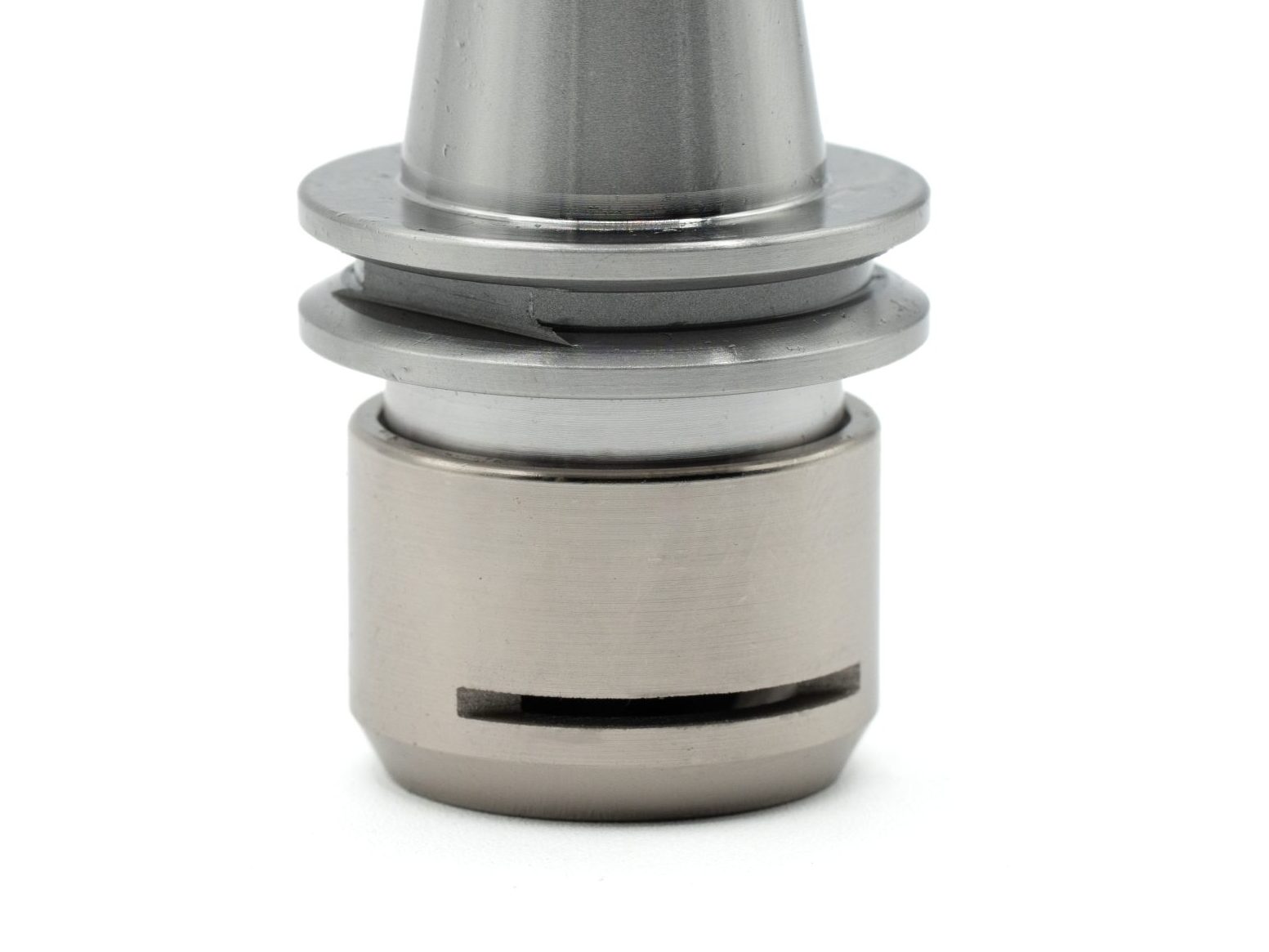

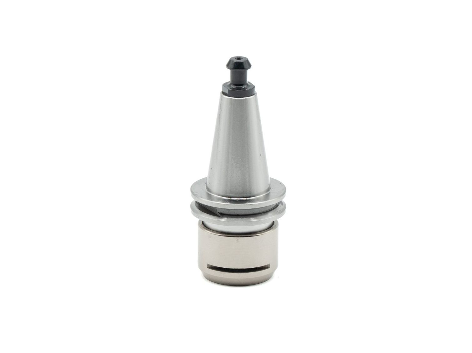

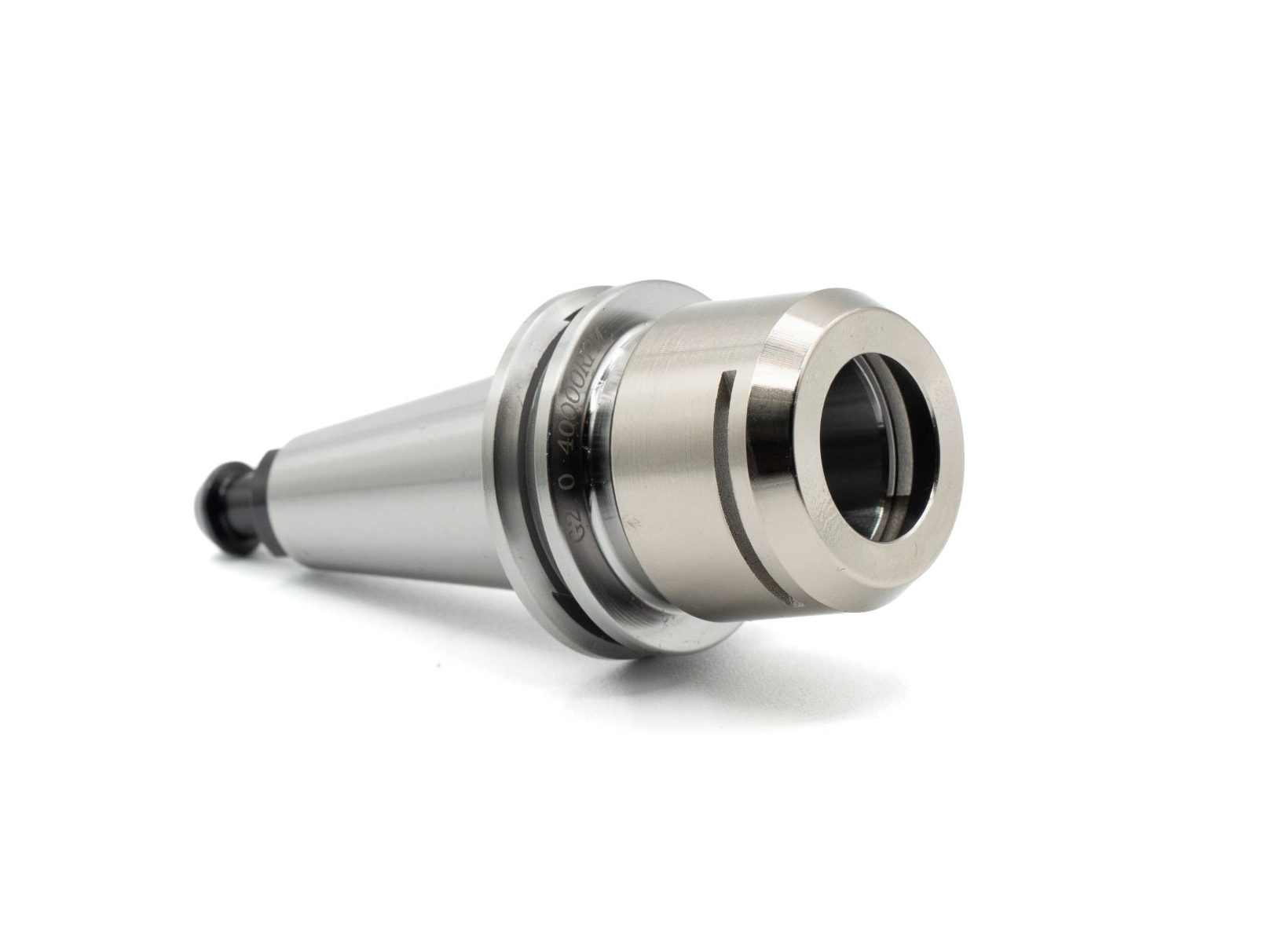

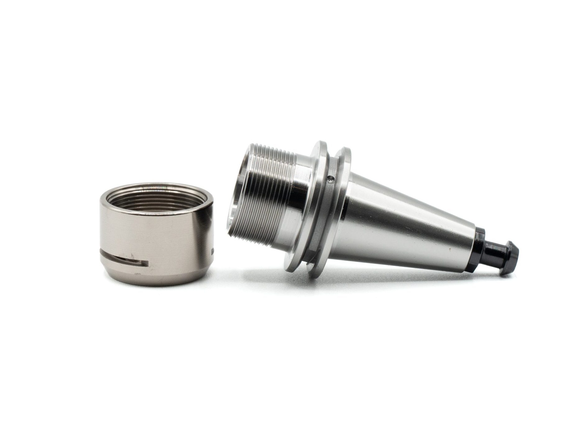

This stainless steel Tool Holder lets you easily swap tools in manual mode or have back ups ready for tool-rack mode on your Automatic Tool Changer.
Each order comes with one (1) tool holder. Tool racks and ATC sold separately. ER20MS wrenches not included.
This Tool Holder works with Sienci Labs’ Automatic Tool Changer and is compatible with other brands.
Description
  • Each order comes with one (1) tool holder, for quick, convenient bit changing
  • Store in your rack, or separately for faster rack swaps or manual tool changes
  • Standard ISO20 tool holder taper with ER20 collet system
  • Rated for 40,000RPM maximum speed
Some images are 3D renders of products. May not be exactly as shown. Some photos may contain items for illustrative purposes, such as spindles or CNCs.
Additional information
Weight 1 lbs
Dimensions 4 × 4 × 8 in
Measurements
ER20MS Collet Nut, Standard ISO20-35L tool holder size
