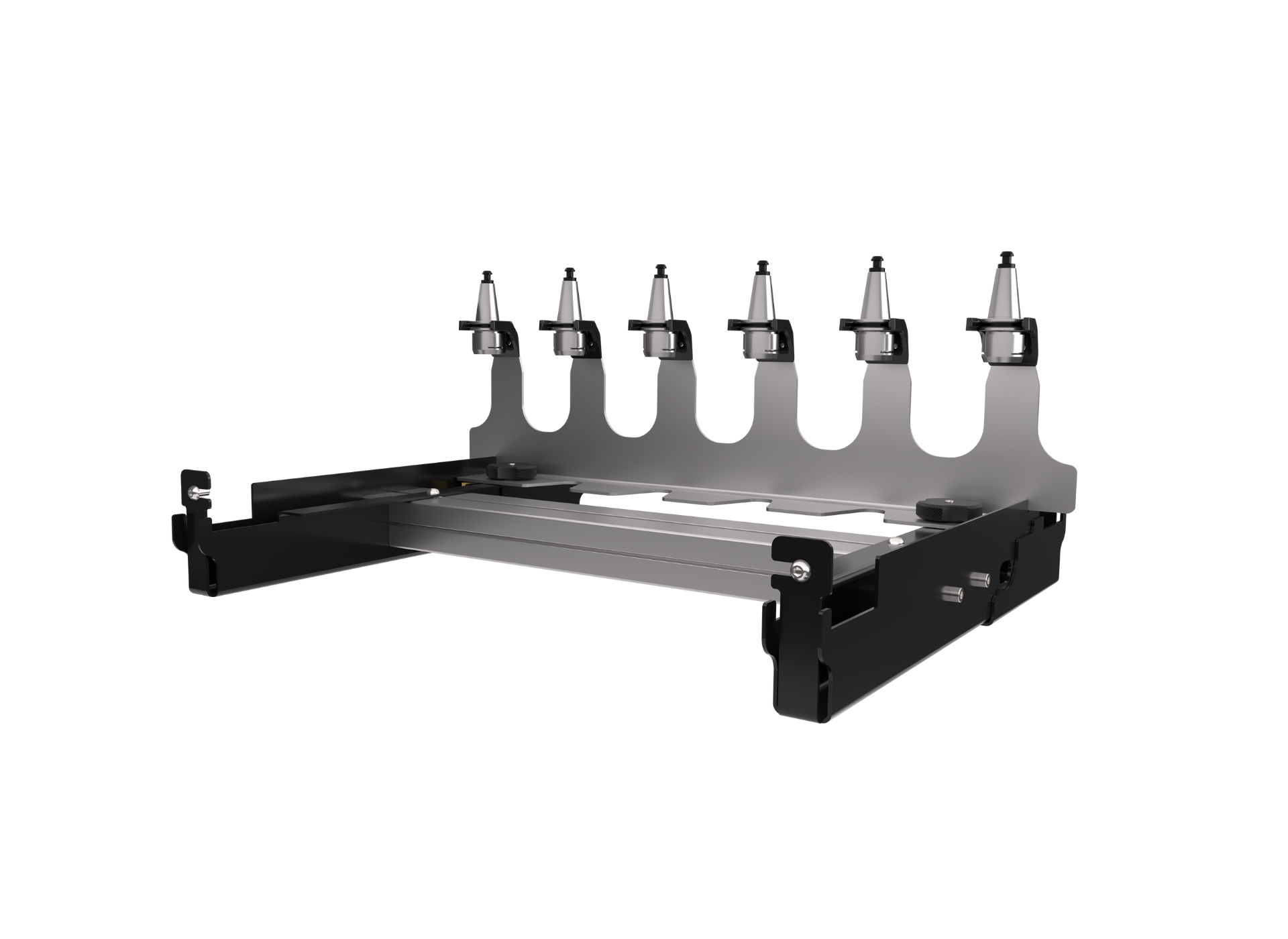

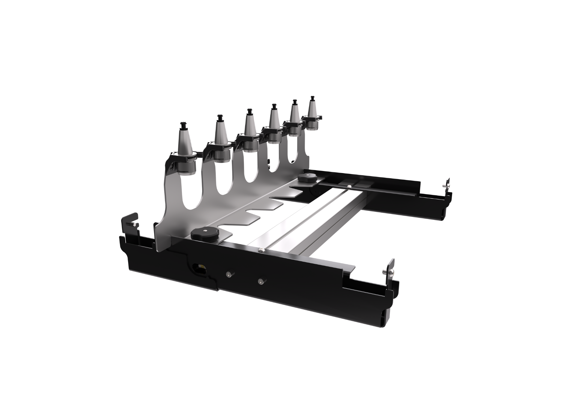

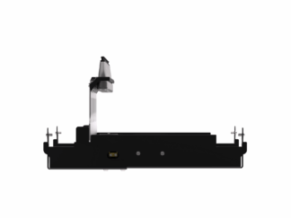

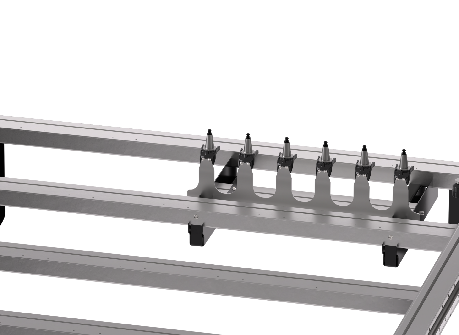

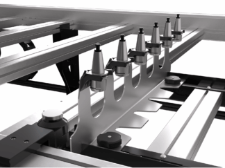

This 6 position Tool Rack lets you level up so you can go full automation mode with your Automatic Tool Changer. It can hold up to 6 tools or combine up to two tool racks to hold a maximum of 12 tools on  your AltMill. Plus, the rack can be easily removed to accommodate larger materials along with the integrated rack sensor to automatically switch tool pickup behaviour.
Each order comes with one (1) tool rack; six (6) ISO20 tool holders; twelve (12) ER20 collects (mix of 1/8″, 1/4″, 3/8″ & 1/2″). ATC spindle sold separately. Compatible with AltMill CNCs only.
This Tool Rack is designed specifically for Sienci Labs’ Automatic Tool Changer.
Description
***Included with your ATC Tool Rack (6 Tools)***

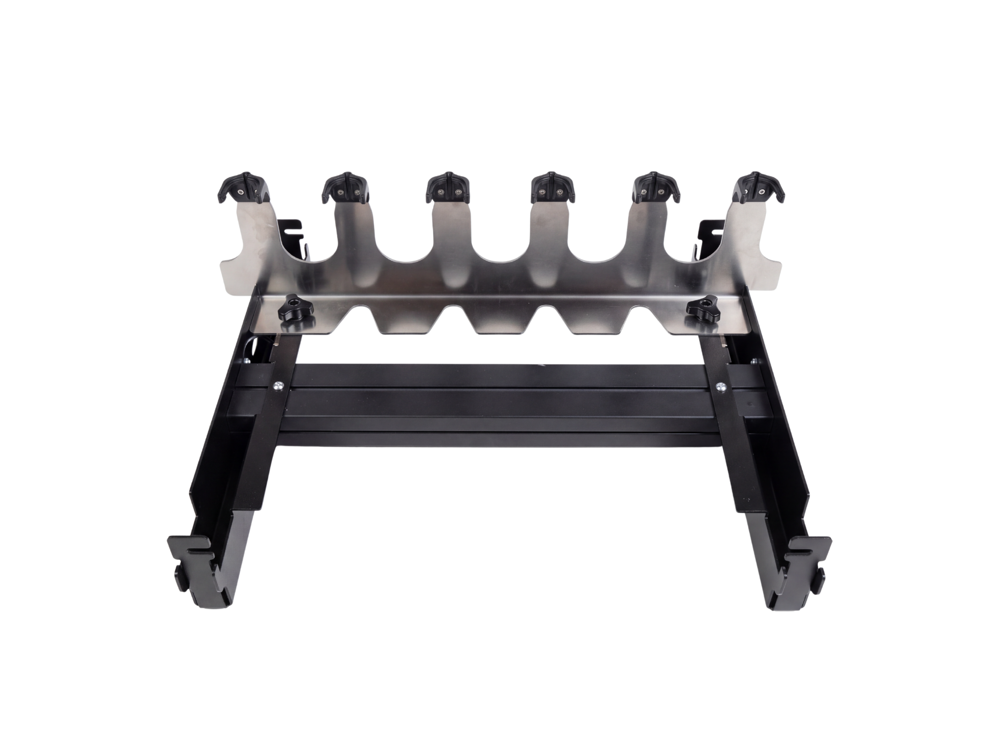

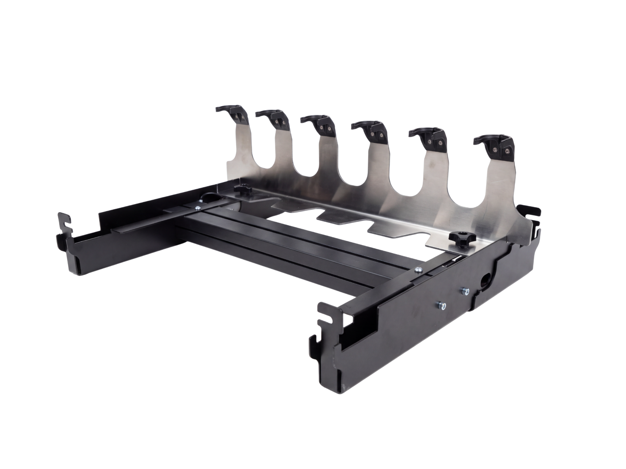

  • Each order comes with one (1) tool rack, capable of housing 6 tools
  • Six (6) ISO20 Tool Holders
  • 12 ER20 Collets (Mix of 1/8″, 1/4″, 3/8″ & 1/2″)
  • Compatible with ISO20-35L tool holders
  • Compatible with AltMill CNCs only
    • A maximum of two tool racks – 12 tools total – can be housed at the back of an AltMill CNC (any size or model.)
  • Easily removable to allow machine through-travel during manual mode
  • Made from anodized aluminum and stainless steel construction, with custom molded tool forks
