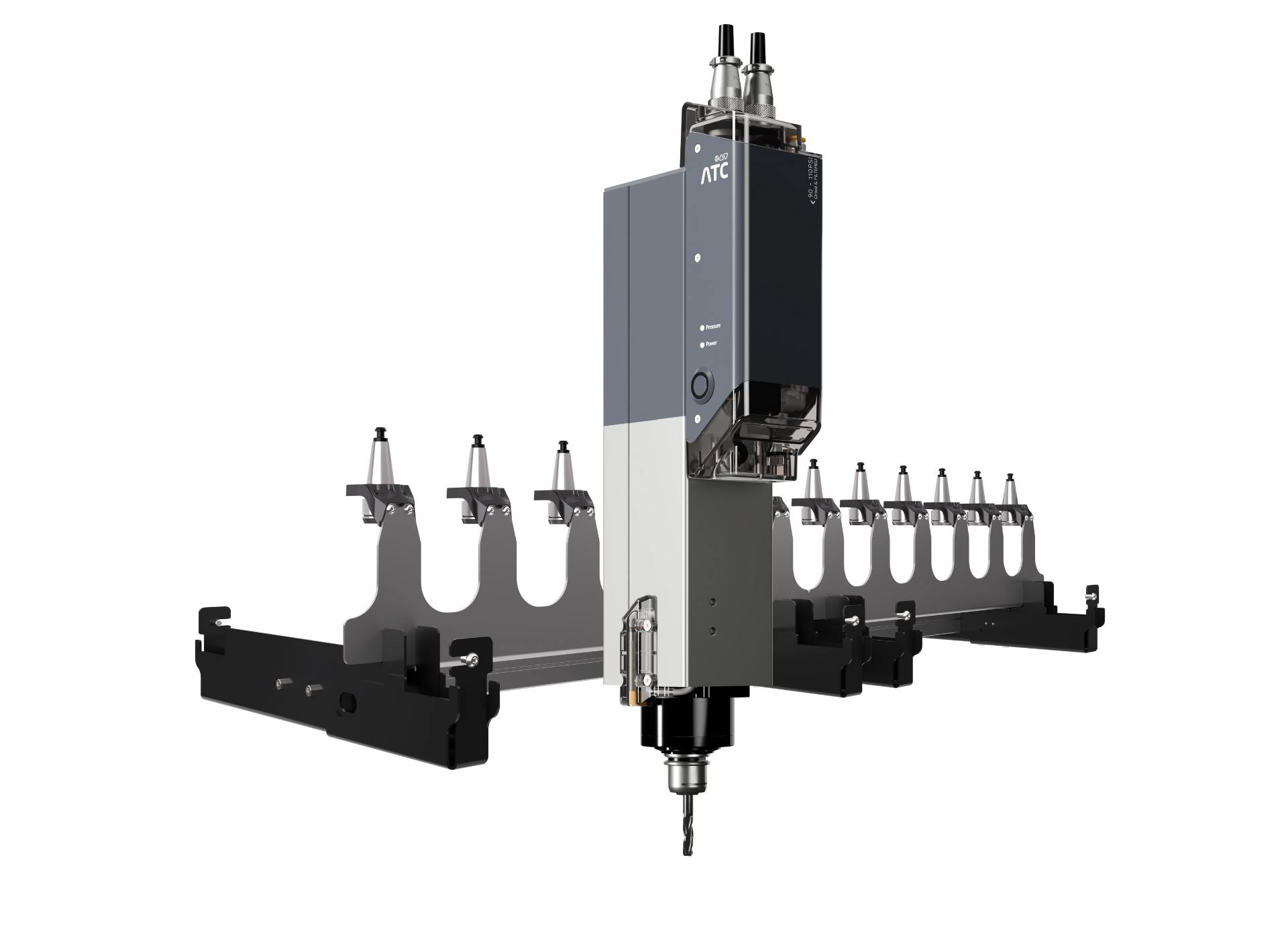

An Automatic Tool Changer makes shop life easy. With a push of a few buttons, the annoyance of swapping tools is replaced with uninterrupted, continuous operation. The ATC 2.2kW spindle has the power and precision to repeat production tasks reliably, and makes running hobby projects a breeze. Our ATC is sold in different combinations that allow for full tool automation or quick and easy manual tool change mode. Read the Description tab for full details.

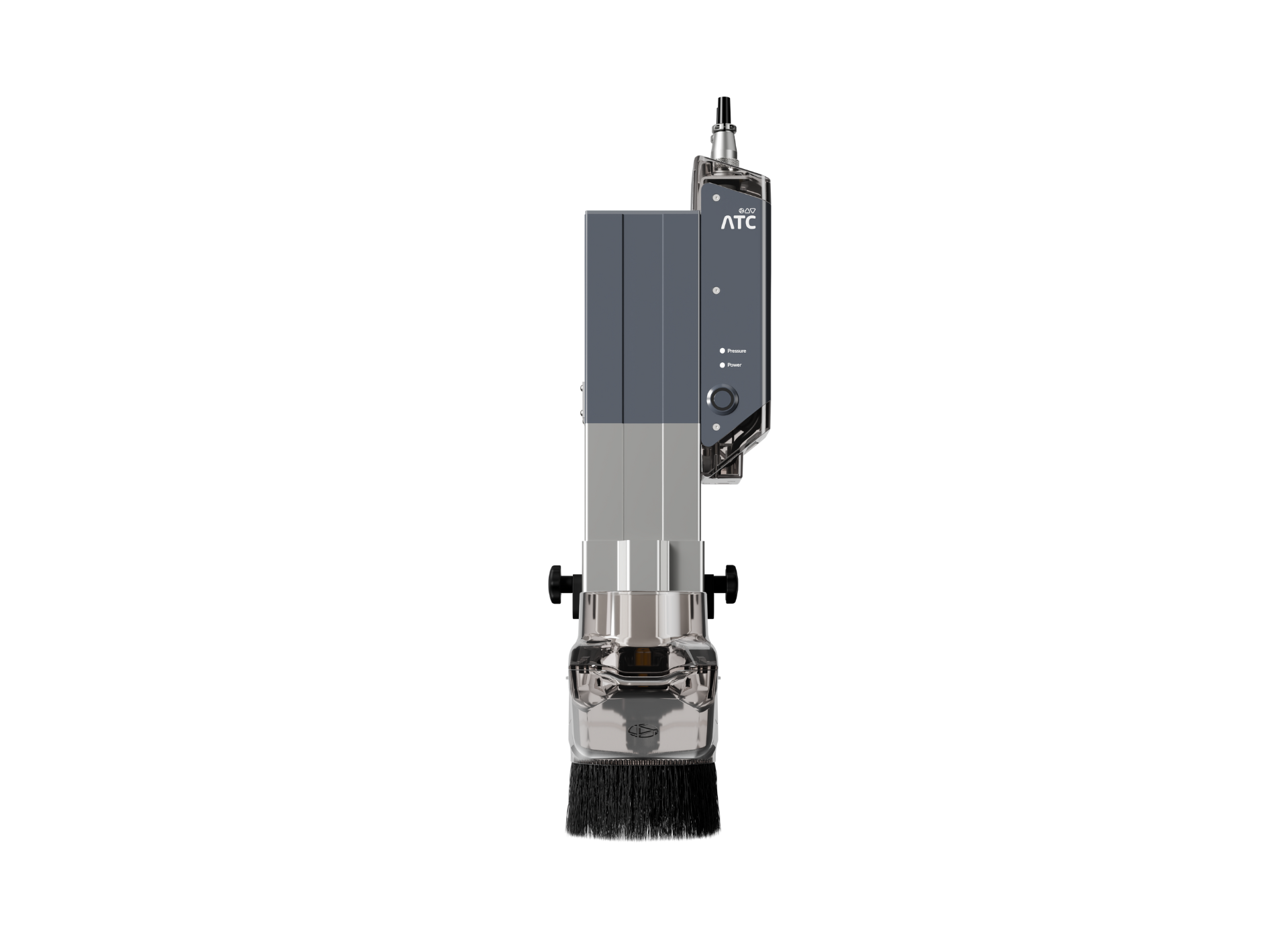

Specifications

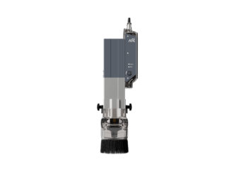

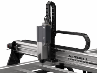

Output Power: 2.2kW
Speed: 7,500-24,000RPM / Constant torque beginning at 18,000RPM
Bearings: Ceramic
Cooling: Air cooled with 24V fan
Operating Noise: 60 dBA

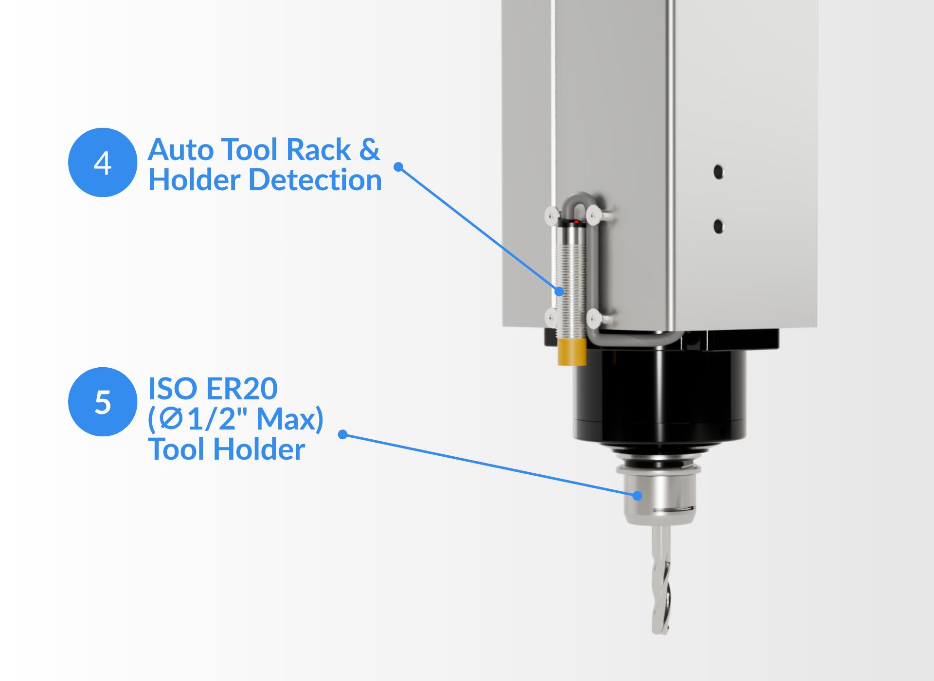

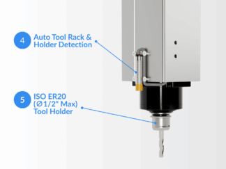

Tool Holder: ISO20
Collet: ER20
Power Requirements: 220VAC 15A single phase (spindle only)

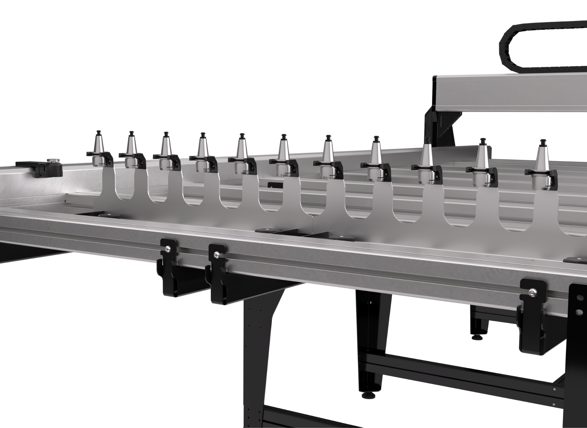

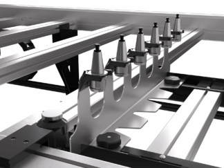

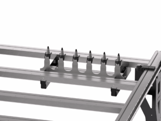

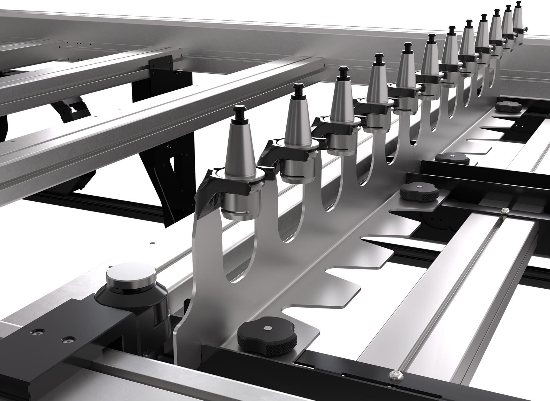

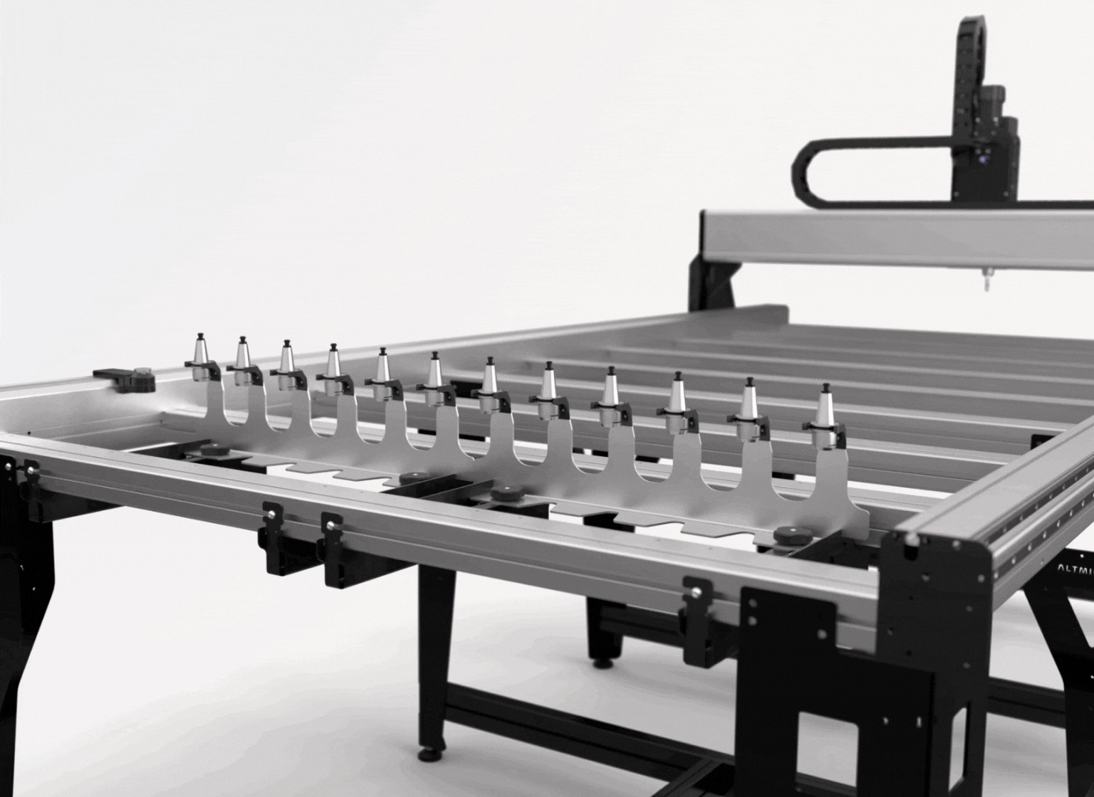

Tool Rack: Maximum shank diameter 1/2” / Maximum tool diameter 2”
Number of Slots: 6 or 12 (configuration dependent)
Impact on Cutting Area: 6.4″ Rear keep out area (accounting for clearance of the Clear Cut Dust Shoe)
Remaining Cutting Area on all AltMill models: 2×4: 19.1” / 4×4: 42.8” / 4×8: 98.7” / Detachable design allows the rack to be removed at any time to free up full cutting area under passthrough mode
Tool Setter: Included
Compressed Air Requirement (Customer Supplied): Operating pressure of 100psi / Airflow of 3 CFM (cubic feet per minute) at 90psi or better
Dryer and Filter: Compressed air should be filtered to 40 µm or better using a coalescing-type filter, unless your air source (compressor) already includes built-in drying and filtration. For use in high-humidity environments, additional drying equipment is recommended to reduce the risk of corrosion.
Machine Compatibility: All AltMill sizes and models / Not compatible with with third-party CNC machines
Must Have Add-on: ATC Air Regulator and Filter & Air Compressor

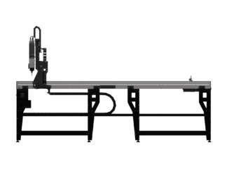

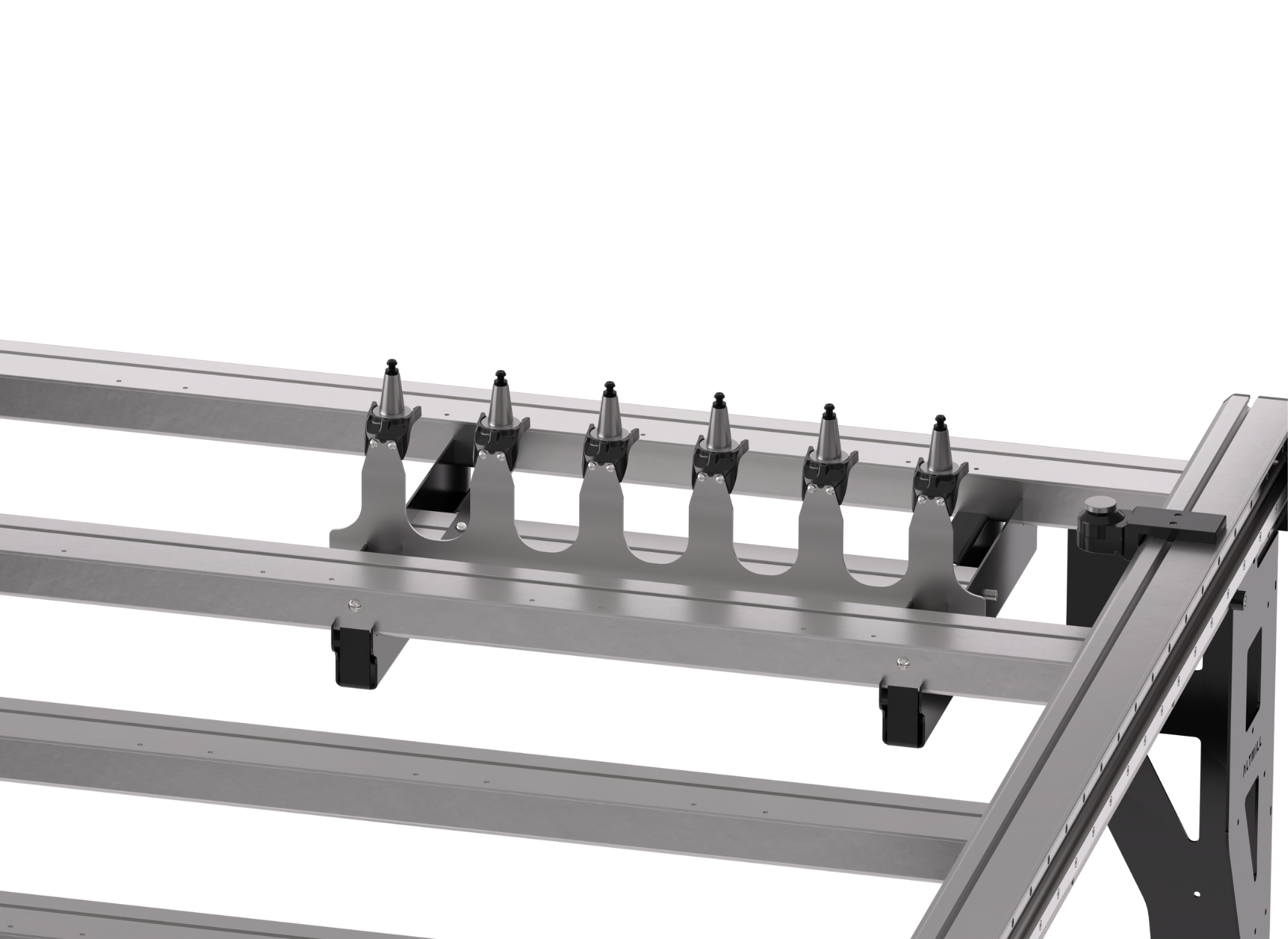

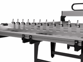

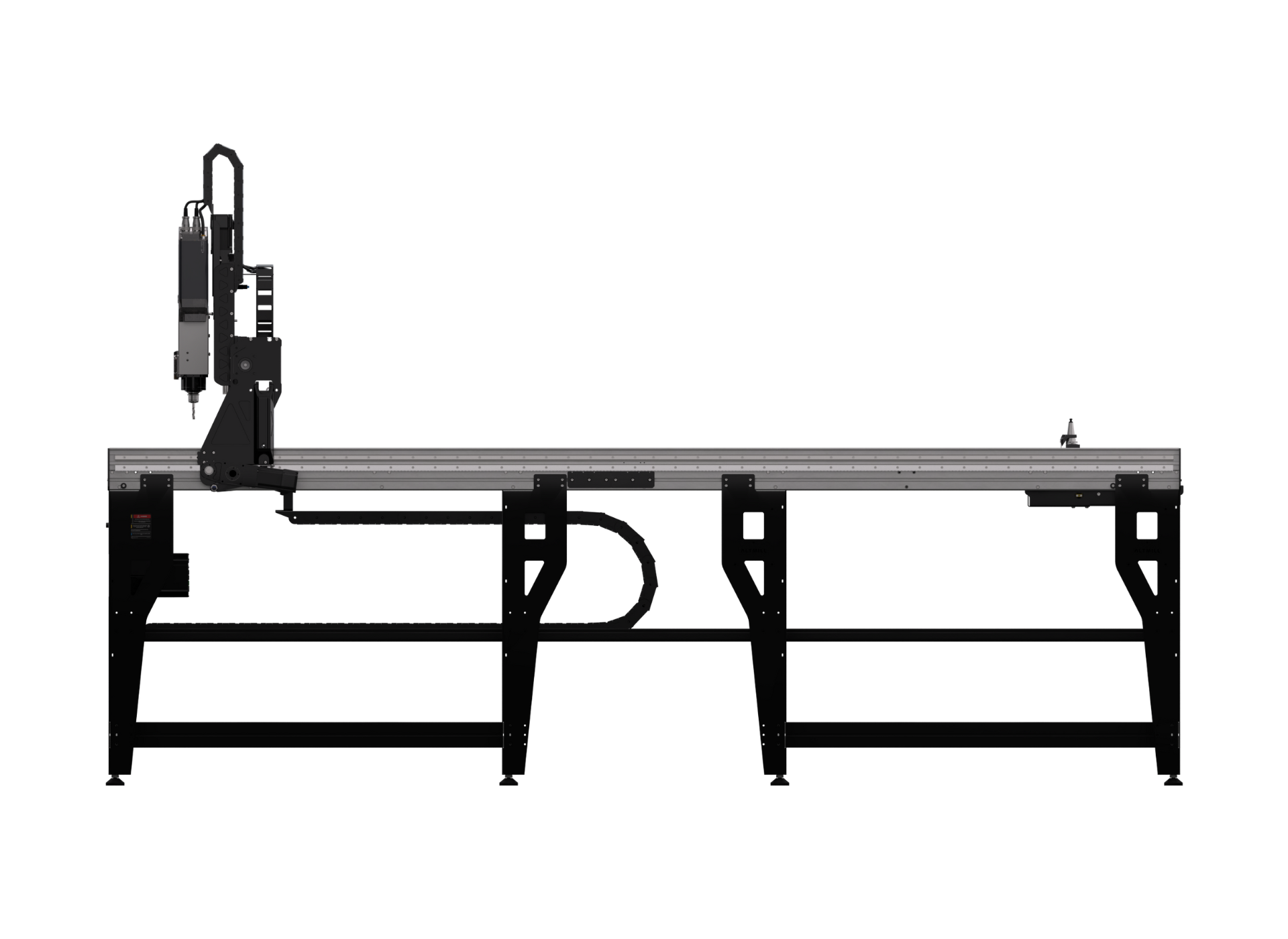

How much travel will the tool rack take away from my AltMill? You will lose some travel once the Tool Rack is installed. Here is the remaining area to play with:
2×4: 19.1”
4×4: 42.8″
4×8: 98.7”
The racks are detachable and can be removed at any time to free up full cutting area under passthrough mode, or when using oversized stock. Removing the rack will automatically configure the system to use a manual tool change workflow.
