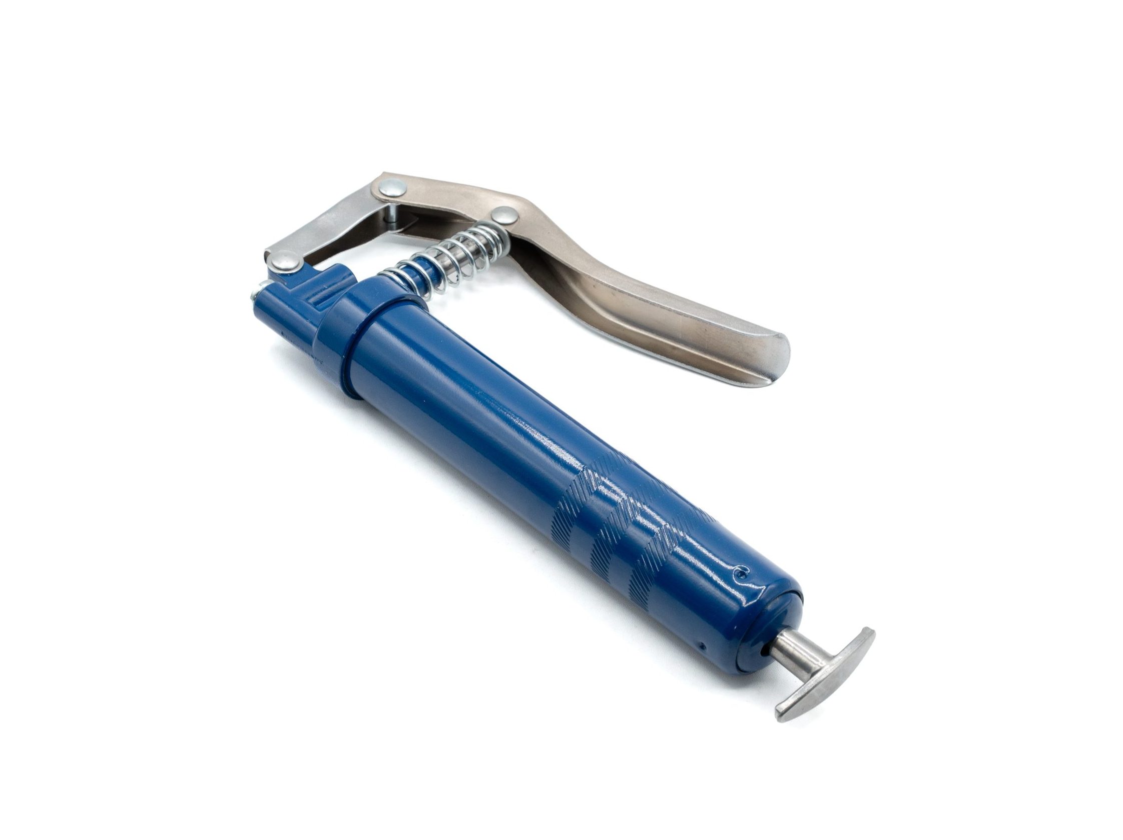

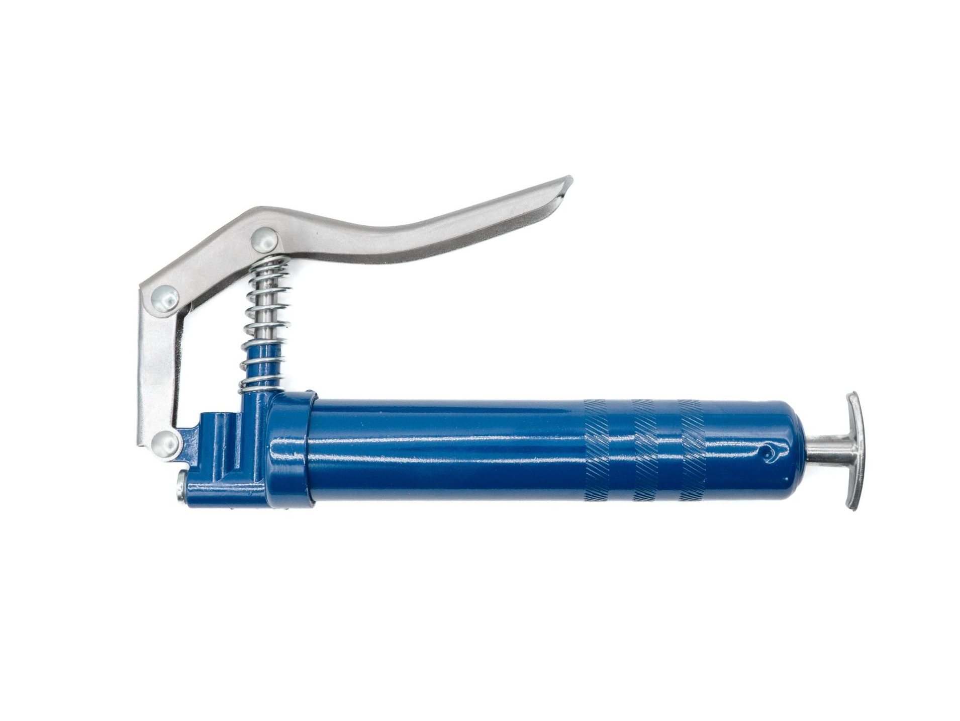

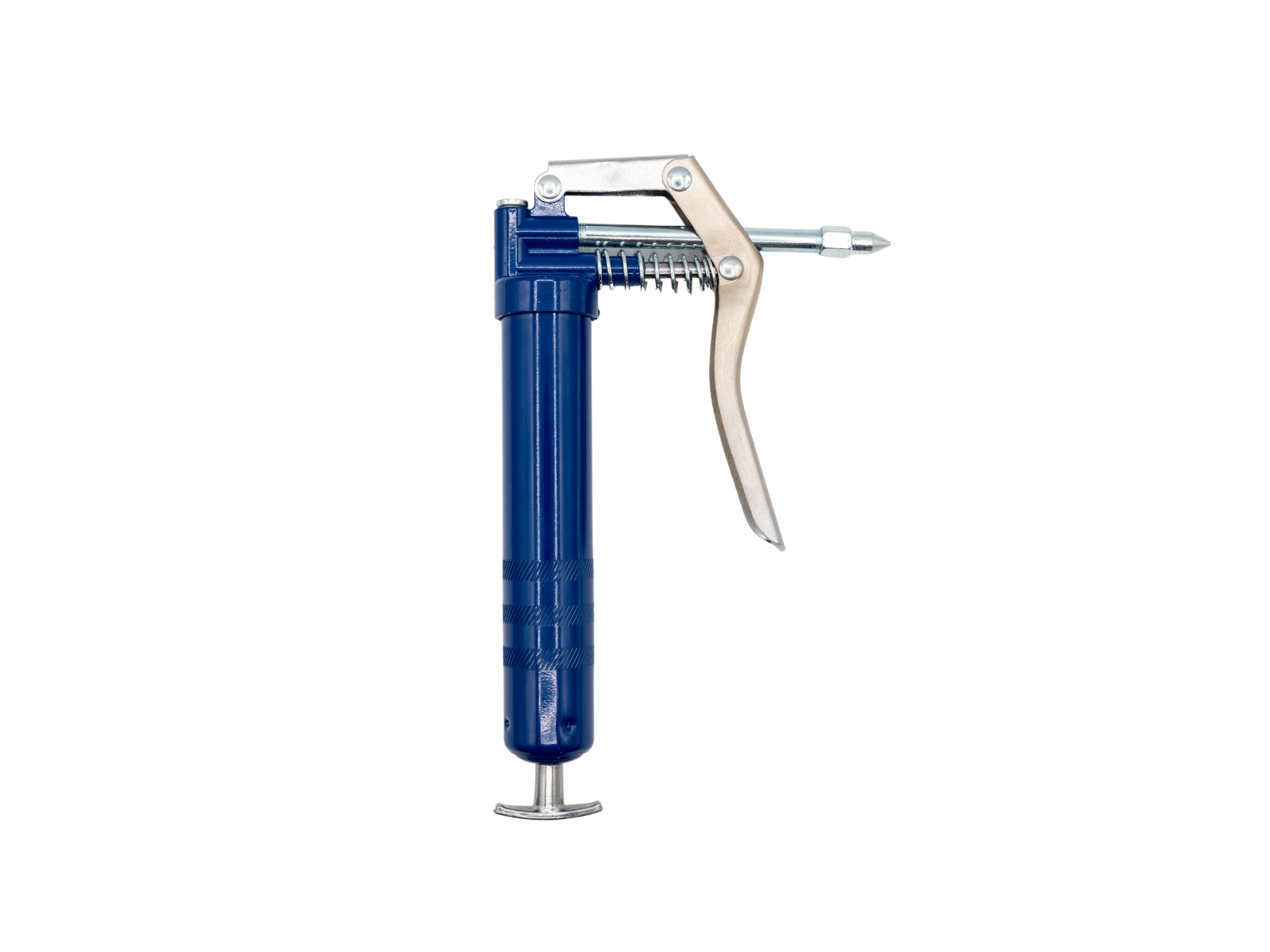

This Grease Gun Kit is intended for the regular lubrication of a machine’s linear guides, gear racks and ball screws. Regular maintenance can extend the longevity of your CNC, plus, it helps your machine run with the precision and power your projects deserve.
See the FAQs for specific LongMill and AltMill applications. They are different.
Each order contains one (1) grease gun kit, complete with nozzles, spouts and white lithium grease.
Description

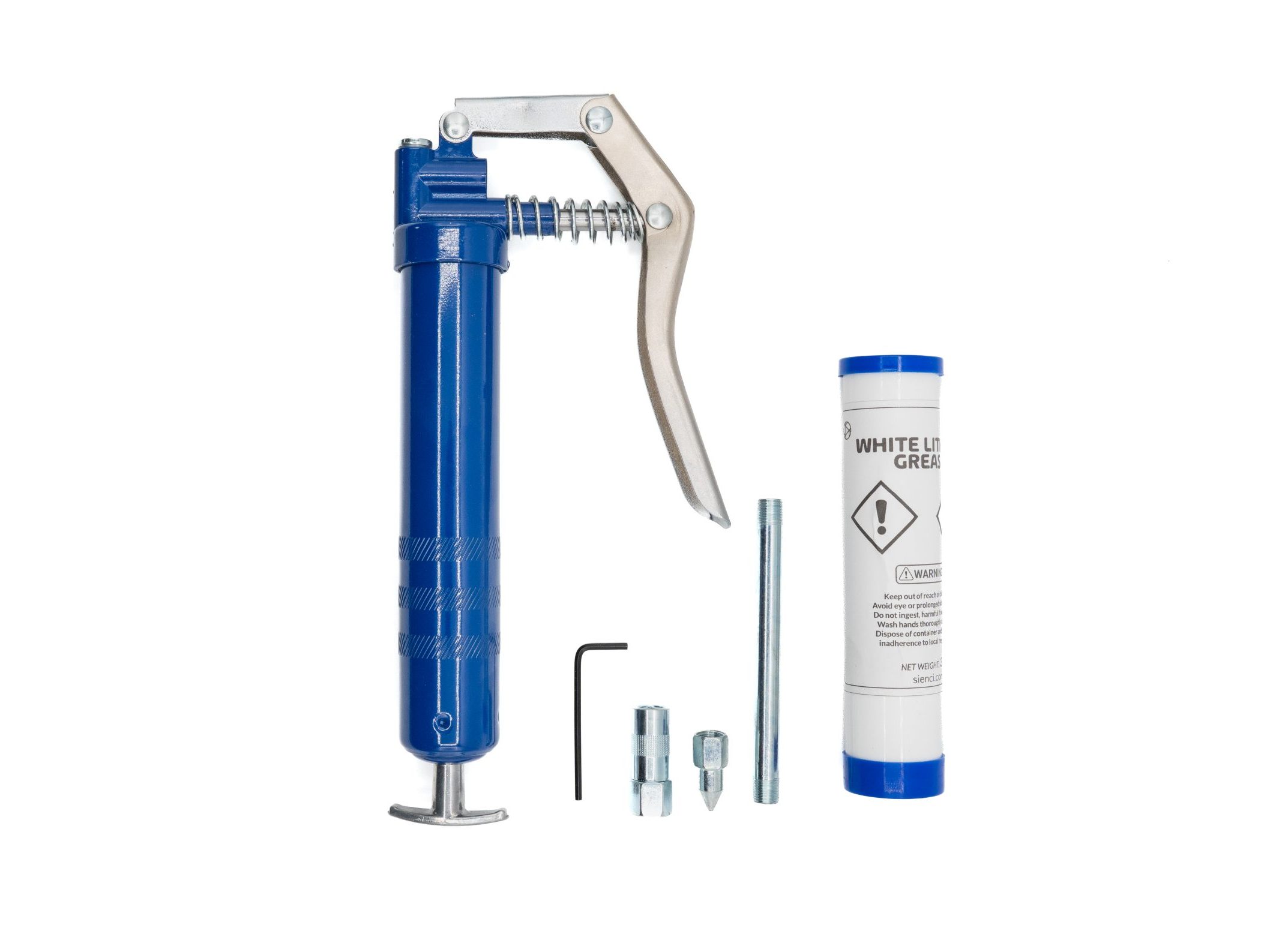

Each Grease Gun Kit includes:
  • One (1) grease gun for 3oz tubes

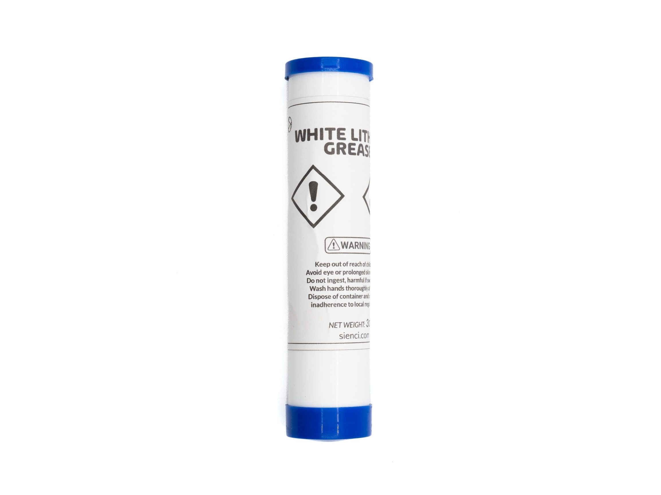

  • One (1) 3oz tube of white lithium grease

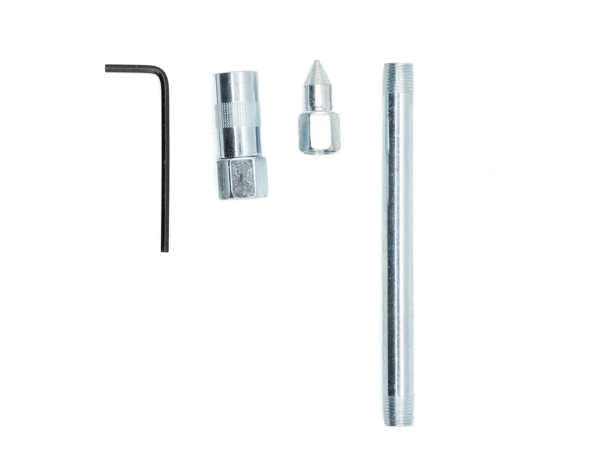

  • One (1) fine tip grease nozzle
  • One (1) zerk fitting grease nozzle
  • One (1) small gun spout
  • One (1) 2.5mm hex key

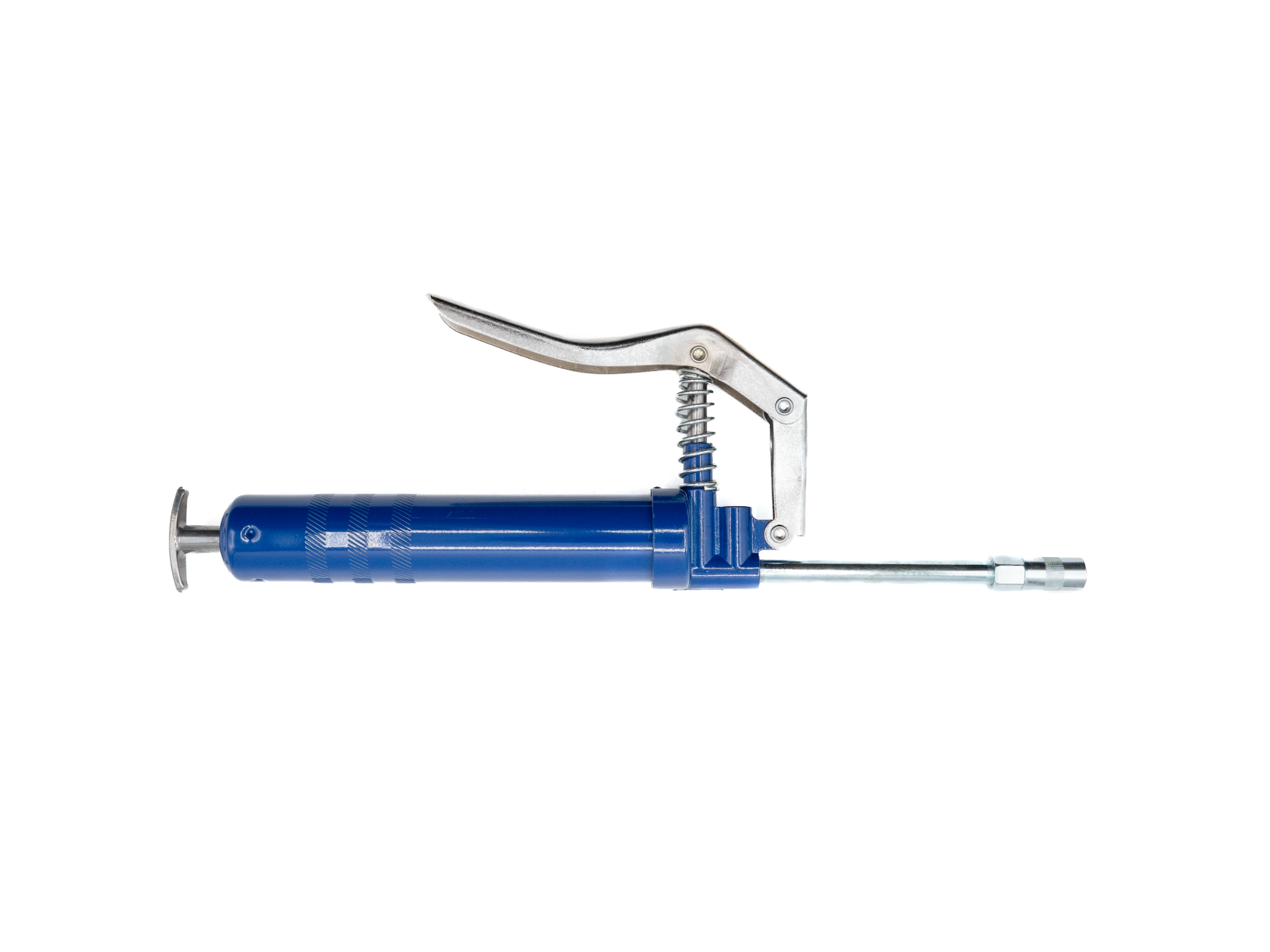

The spout can be oriented two different ways: it can extend the beyond the length of the gun, or run at a right angle relative to the gun.
