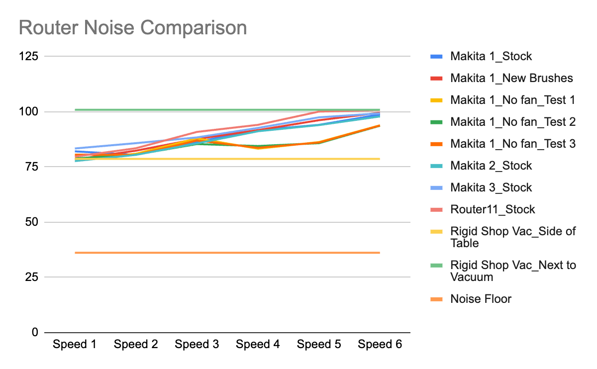

Some interesting things we found:
First is a comparison of running the Makita without a fan, which means basically ripping out the one in there already. We found that there is a decent change in volume at higher speeds. In practice, it sounds quieter as well because the frequencies coming from the fan is more perceptible (lower pitched) than the other parts of the motor.
Johann also mentioned that he found NSK bearings in some routers and CW in some of the new Makitas we were taking apart. The hypothesis is that during the pandemic, there may have been supply chain issues with getting NSK, so Makita used CW in production instead, which coincides with a larger number of bearing failures or overheating issues that we’ve seen happen in the past year.
