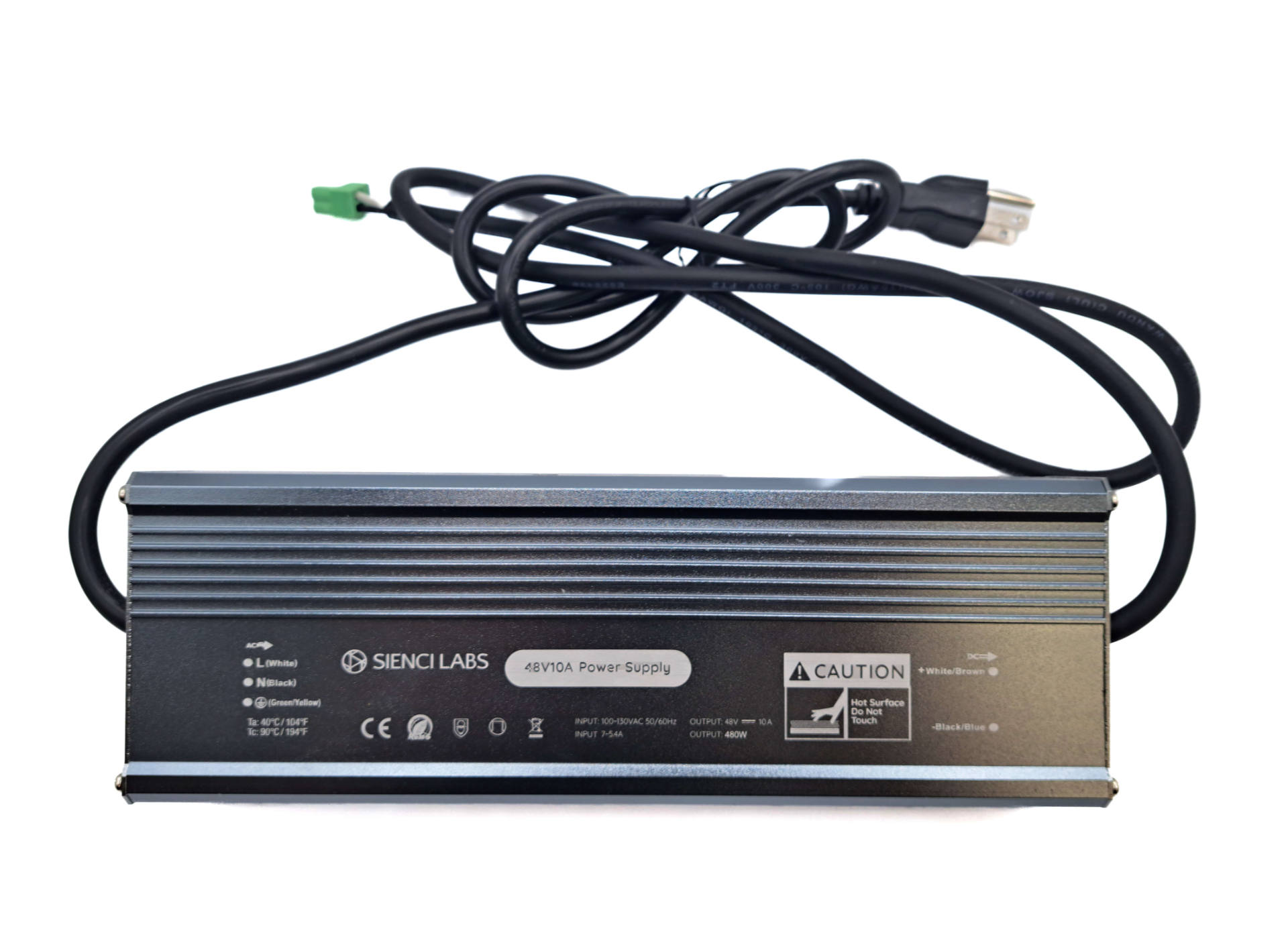

48V 10.4A Power Adapter
$53.99

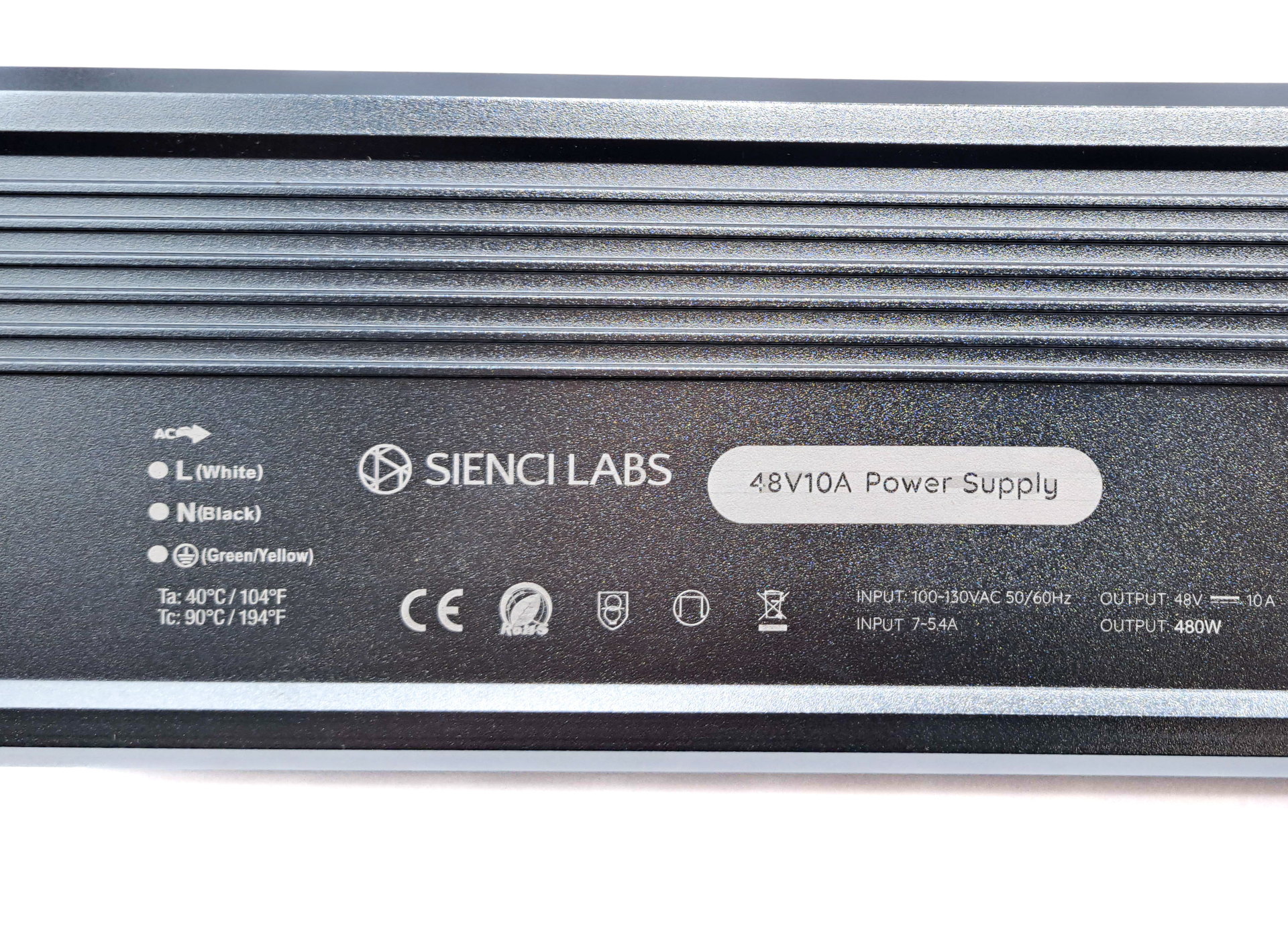

This 48V 10/4A Power Adapter provides supply power to the SLB-EXT controller, and comes with a removable terminal connector compatible with the AltMill
Available on backorder
Description

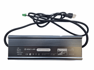

Our 48V 10.4A Power Adapter is compatible with all AltMill versions, and provides up to 480 watts of power to your CNC machine.

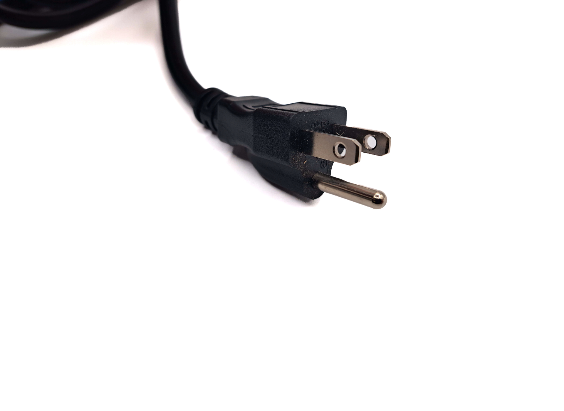

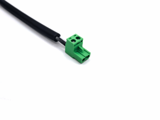

The DC side comes with a WJ2EDGK-5.08-2P connector and the AC side uses a North American Standard Type B NEMA 5-15P plug. Highlights include:
  • Higher maximum power output from 480 watts, providing additional headroom and allowing for potential future updates
  • Encapsulated electronics, for shock resistance and dust/moisture resistance

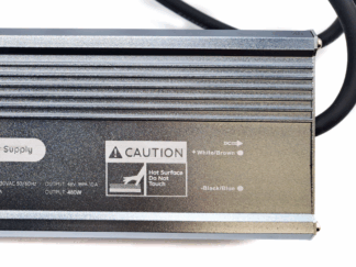

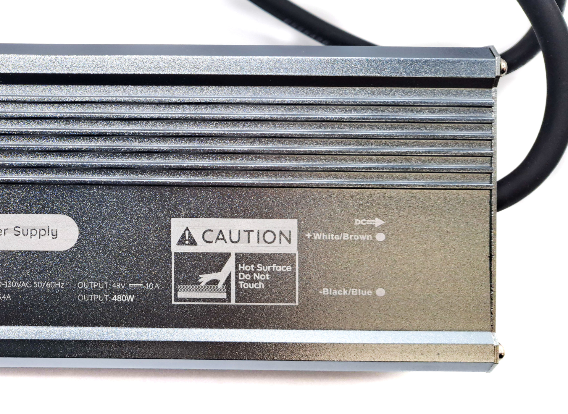

***This power adapter comes with an aluminum case that can get hot. Users should exercise caution when handling the power adapter when active.***
This power adapter is only compatible with 110-130VAC. 50-60HZ, commonly used across North America. Customers who are running other voltages are recommended to use a transformer rated for above 480 watts for this power adapter.

Specifications & Measurements
Specifications

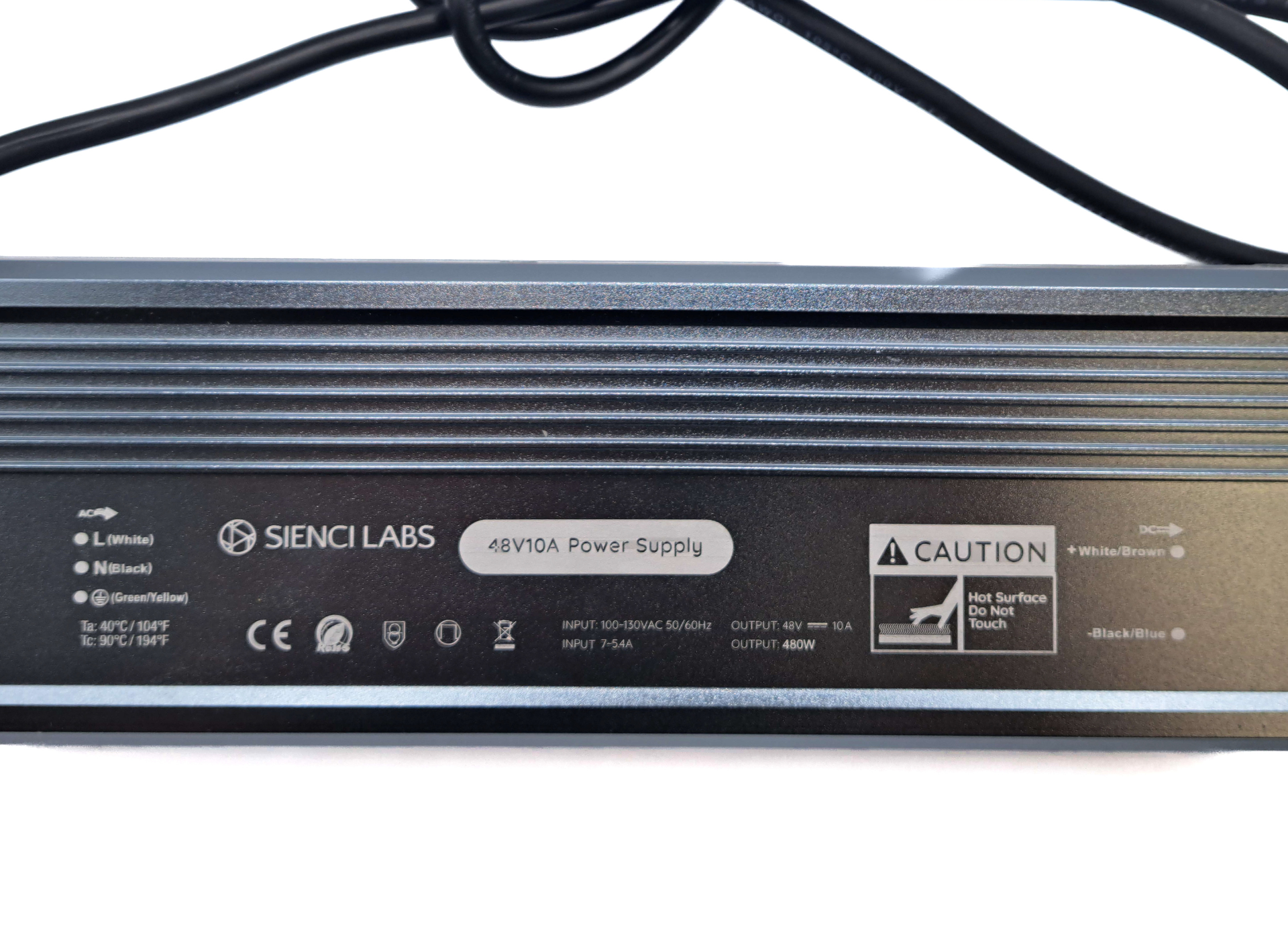

  • Input: 100-130 VAC 50/60 Hz, 7-54 Amps
  • Output: 48 VDC, 10 Amps, 480 Watts

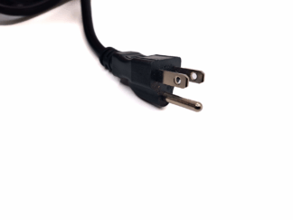

  • Input Connector Type: North American Standard Type B NEMA 5-15P plug

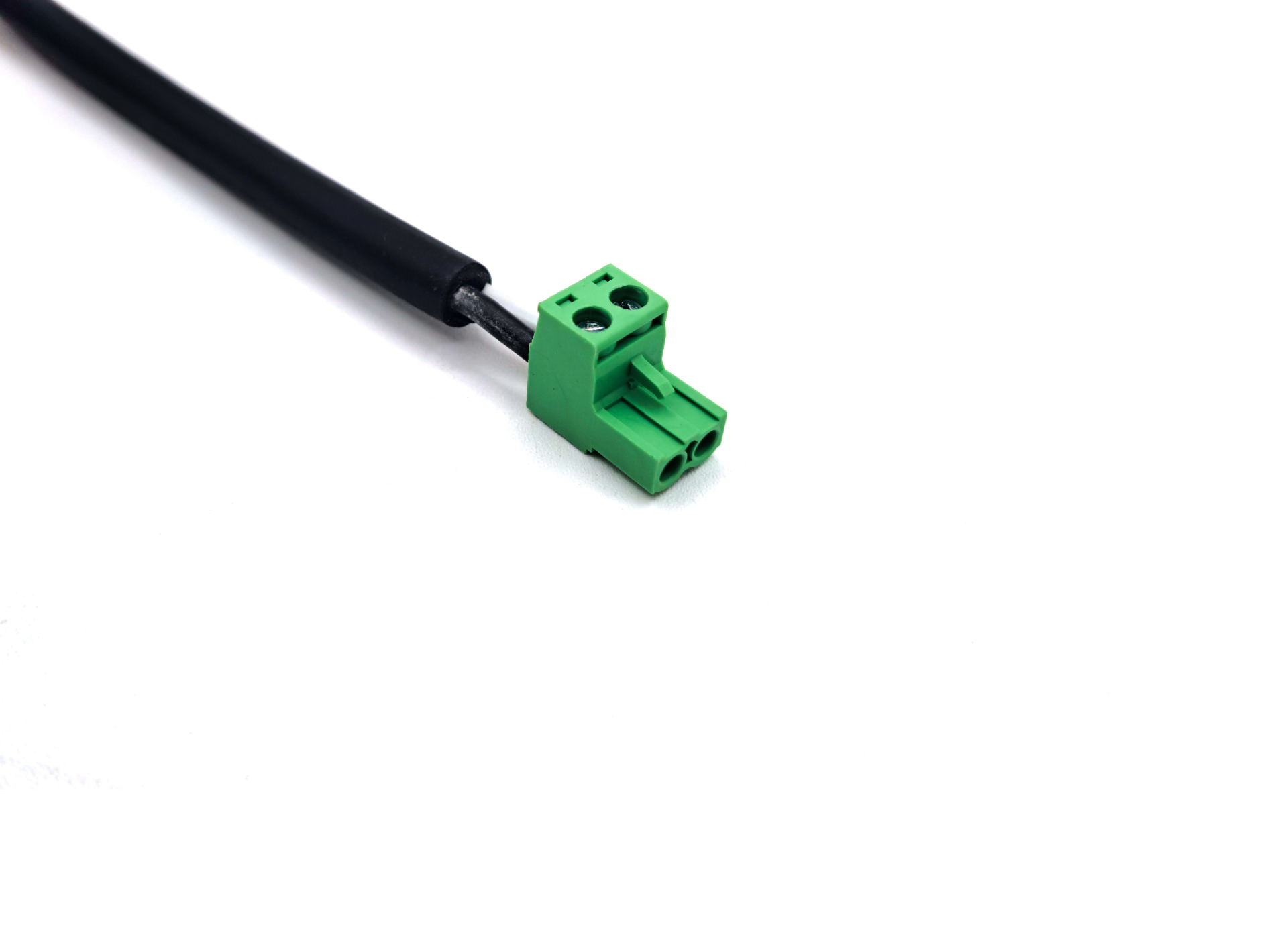

  • Output Connector Type: WJ2EDGK-5.08-2P
This power supply is not rated for countries with 220 voltage. A transformer of 500 watts or more is required for operation.
Measurements
  • Power supply Body: 11 1/2″ x 3 1/2″ x 1 3/4″ (290mm x 90mm x 45mm)
  • Input power Cord Length: 43″ (1090mm)
  • Output power cord length: 41″ (1040mm)
Q. Can this be used for countries with 200 volt power
A. No, you will need to use a transformer of 500 watts or more to use this power supply.
