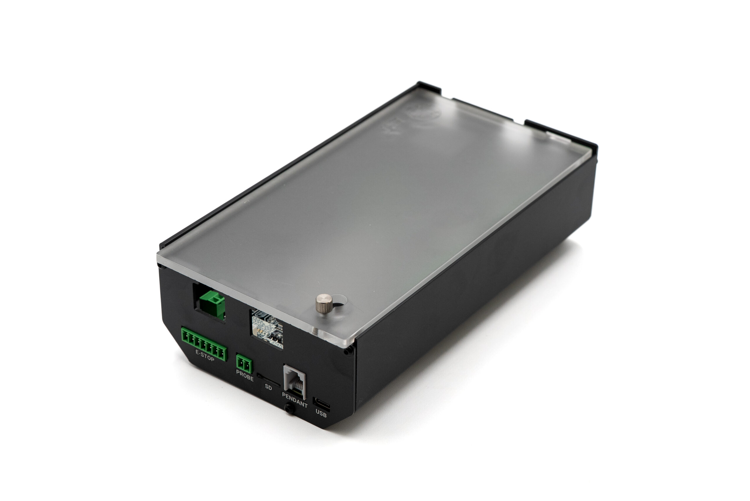

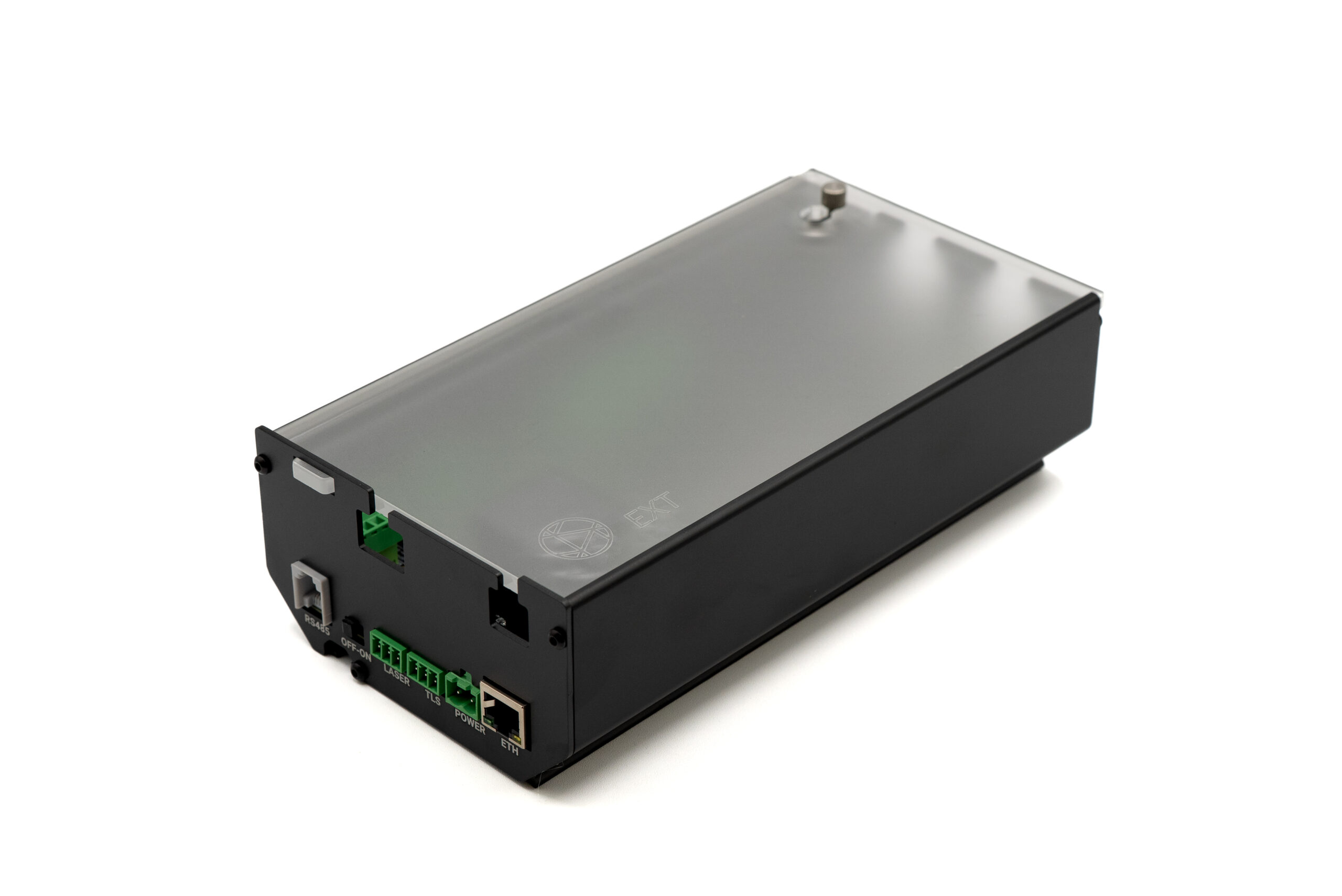

The SLB-EXT 5xHAL is a next-generation 32-bit controller for use with the AltMill, and is open source for other CNCs brands using closed-loop stepper motors.
Our SLB-EXT features:
  • Faster movement and jogging speeds
  • Quieter motors
  • CNC status lights with support for external lighting
  • Safe E-stop depowers motors and disables accessories
  • Programmable action buttons to suit your workflow
  • Faster probing and higher sensitivity with touch plates
  • Higher level spindle control using RS485**
  • Smoother and faster laser motion and engraving
  • Independent 4th axis rotary output for simultaneous 4-axis cutting
  • USB-C and Ethernet connectivity to computer with extensive shielding and onboard ferrites to improve communication reliability
*Huanyang v1 and P2A, and H-100 currently tested to work out-of-the-box. More to be added in the future.
Note: The SLB-EXT does not ship with a power supply. The SLB-EXT requires a 48 volt DC 10 amp power supply.
For board specifications and wiring requirements, please see the tabs below.

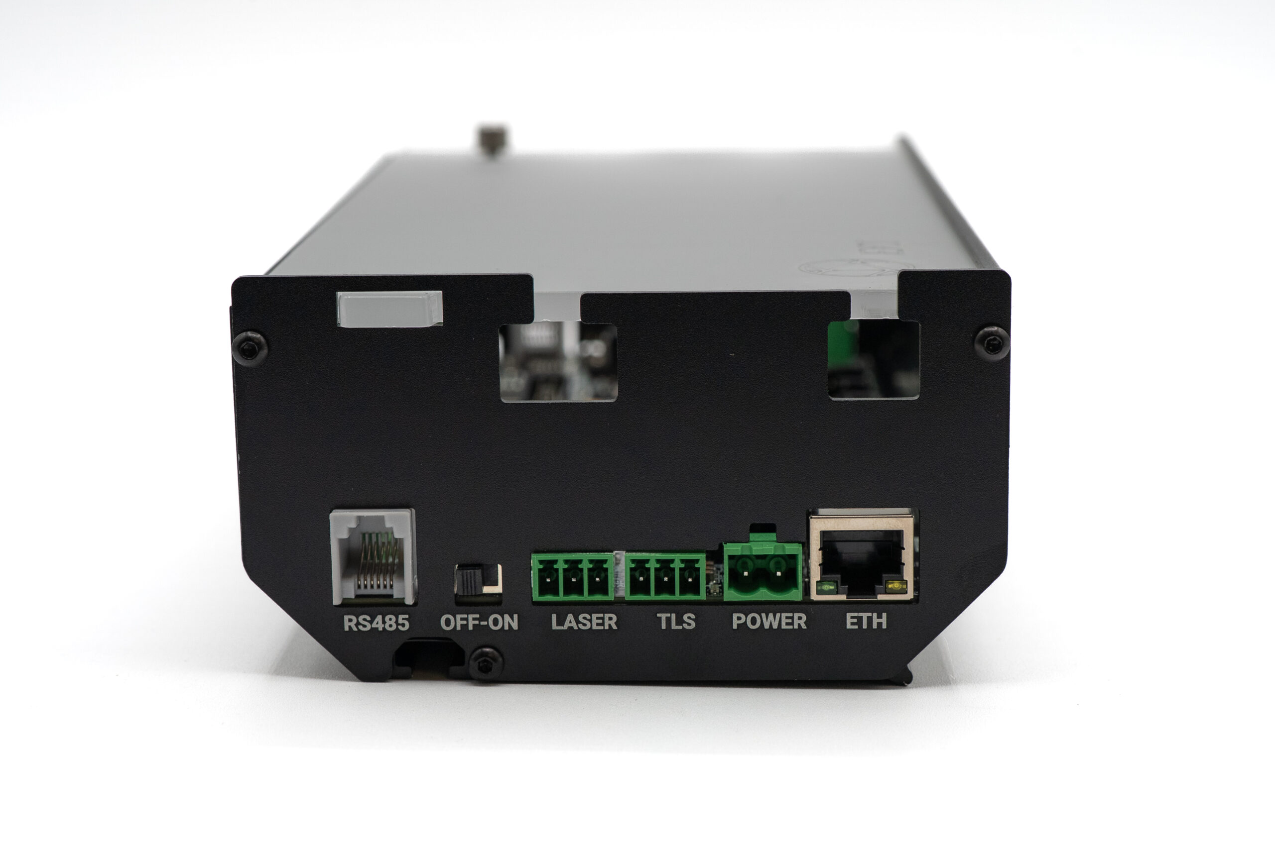

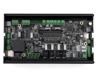

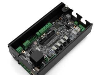

The SLB-EXT is an advanced, next-generation, plug-and-play, CNC controller for all generations of the AltMill CNC. The SLB-EXT allows your AltMill to run faster and more reliably. The SLB-EXT is a significant upgrade in functionality and performance.

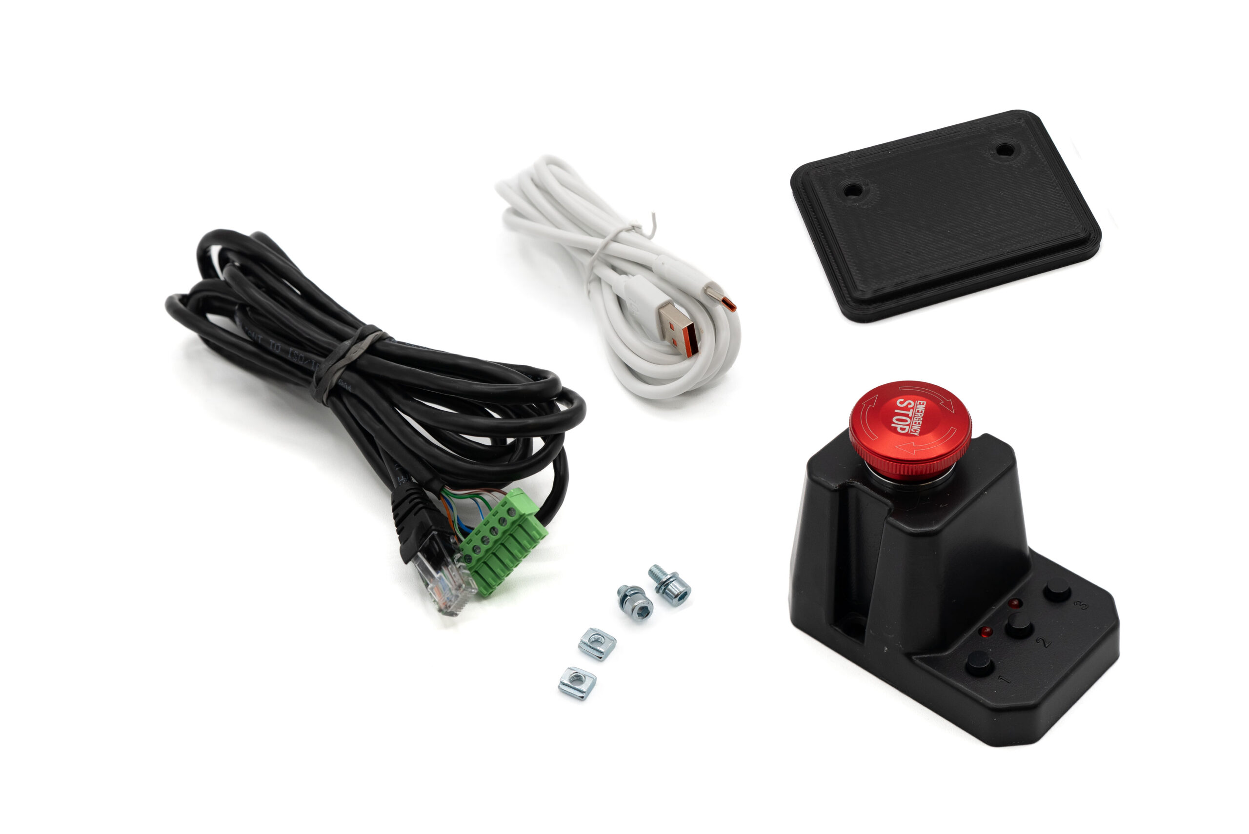

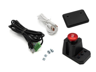

Each order comes with:

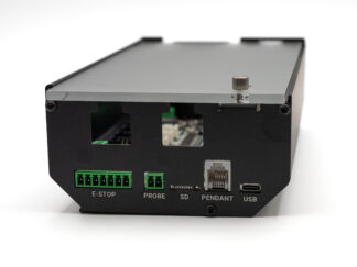

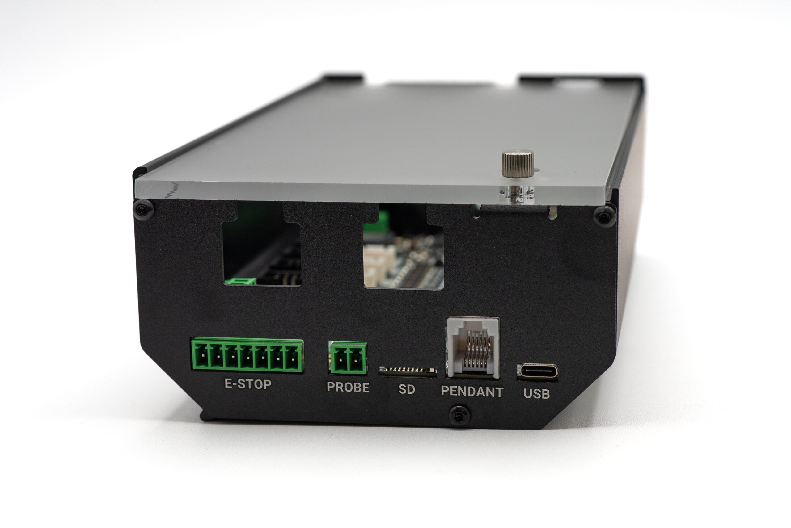

  • An SLB-EXT in a robust aluminum enclosure
  • Independent E-stop with 3 customizable action buttons
  • 2.5m E-stop cable
  • 1m USB-C to USB-A cable
  • Mounting bracket for AltMill

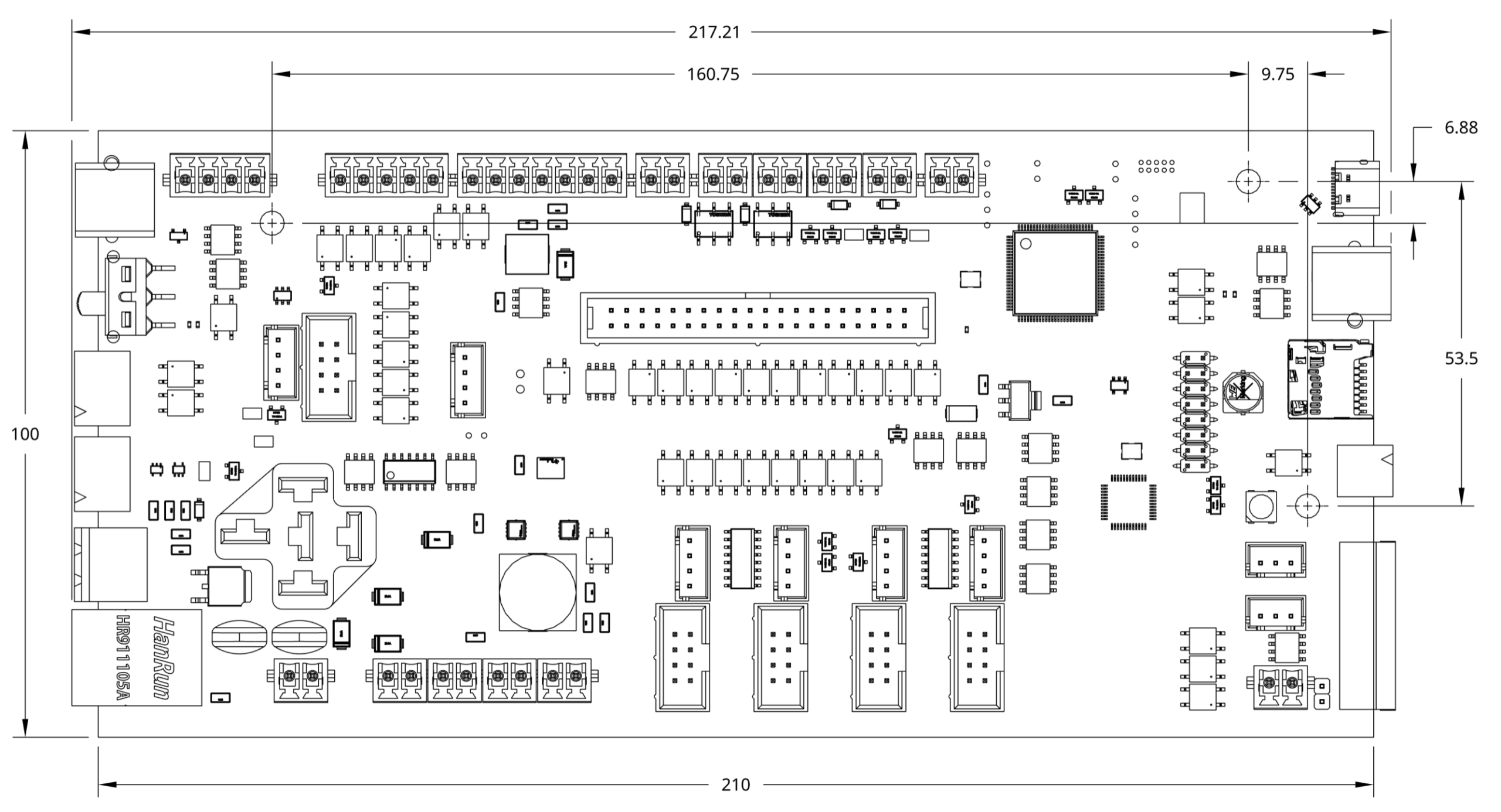

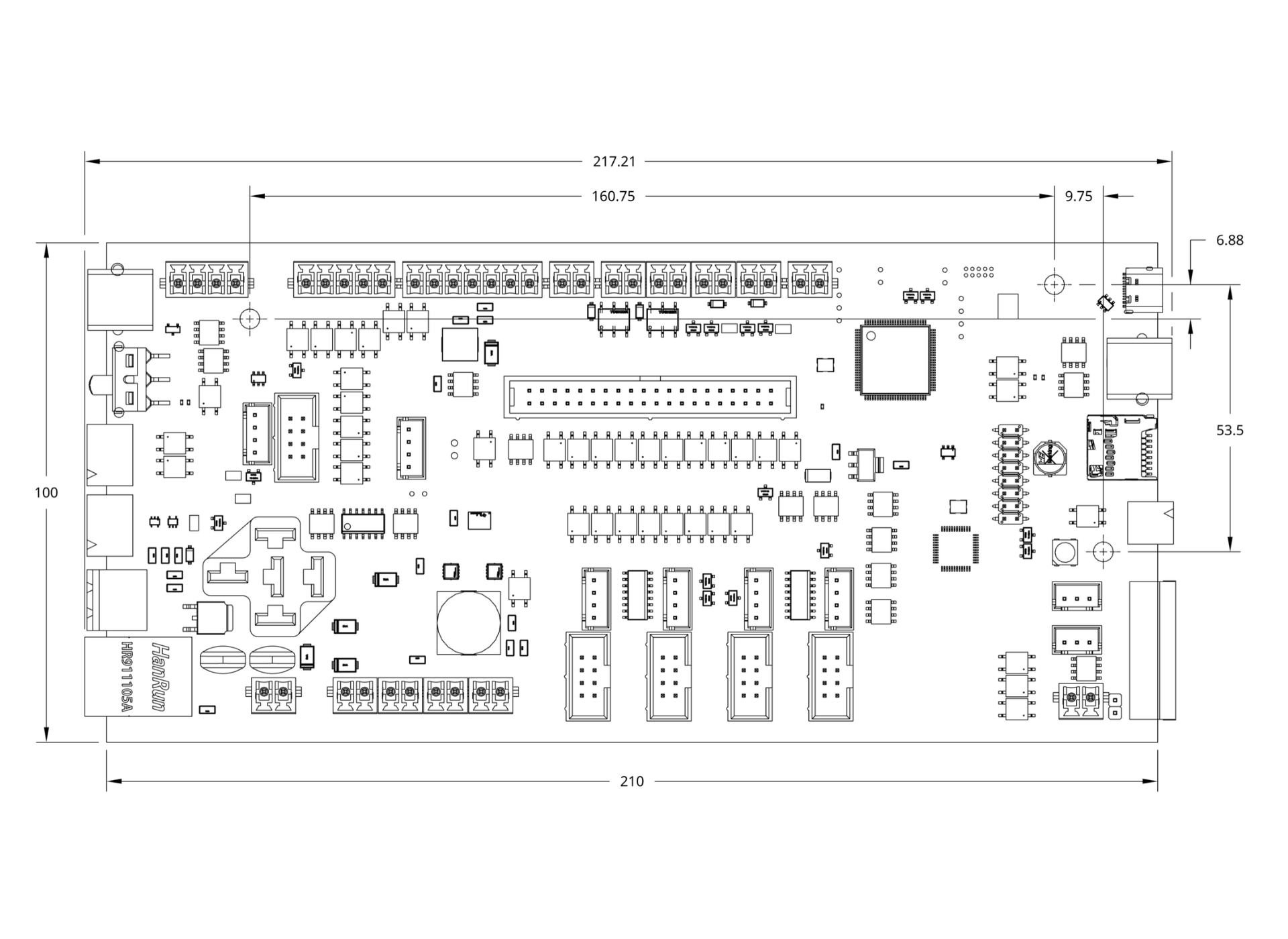

Downloadable Detailed Specifications
Looking for detailed information about the SLB-EXT for to modify your current CNC or to make your own?
Download the Hi-Resolution Dimension Drawing

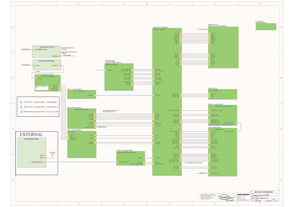

Download the SLB-EXT Schematics PDF
Download the SLB-EXT Connector List PDF
Download the SLB-EXT Pinout List PDF

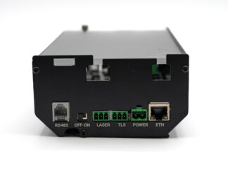

    It works fine. One of the cables can fall out when brushed up against. I wish the on/off switch was on top.

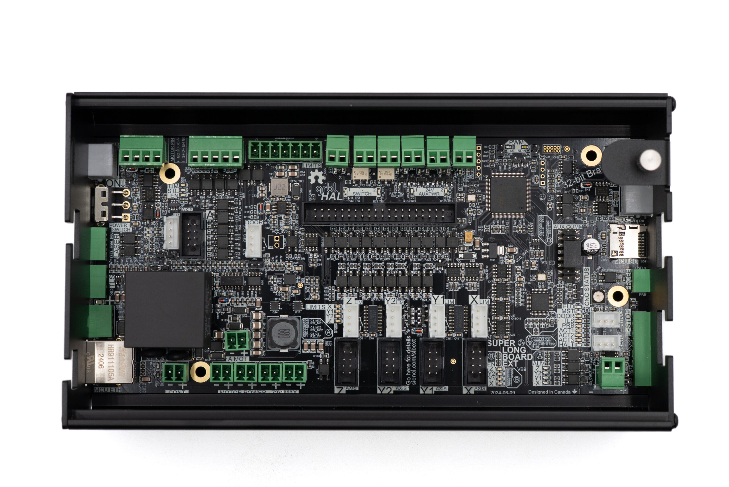

    Space for the connections is very tight.
