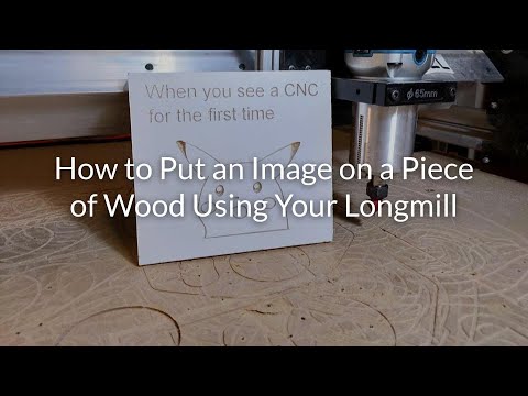

How to Put an Image on a Piece of Wood Using Your Longmill
Hey guys, check out our latest tutorial for your LongMill!
Taking images (JPEGs and other bitmap images) and carving them into wood and other materials is an awesome way to make signs and other projects. In this video, we’ll be walking through the steps on how to turn an image found on the web, making a v-carving, and carving it into a piece of material.

Having a contrast between the surface of the material and inside of the cut is important in ensuring that your carving is visible. For this particular project, I used melamine covered particle board, which has a reasonable contrast between the top white layer and the underlying brown particle board. Some methods of increasing contrast can be pre-painting the surface (paint outside of the cut), painting and sanding the surface (paint inside the cut), or choosing materials that have contrasting layers or surfaces (such as with color core HDPE)
