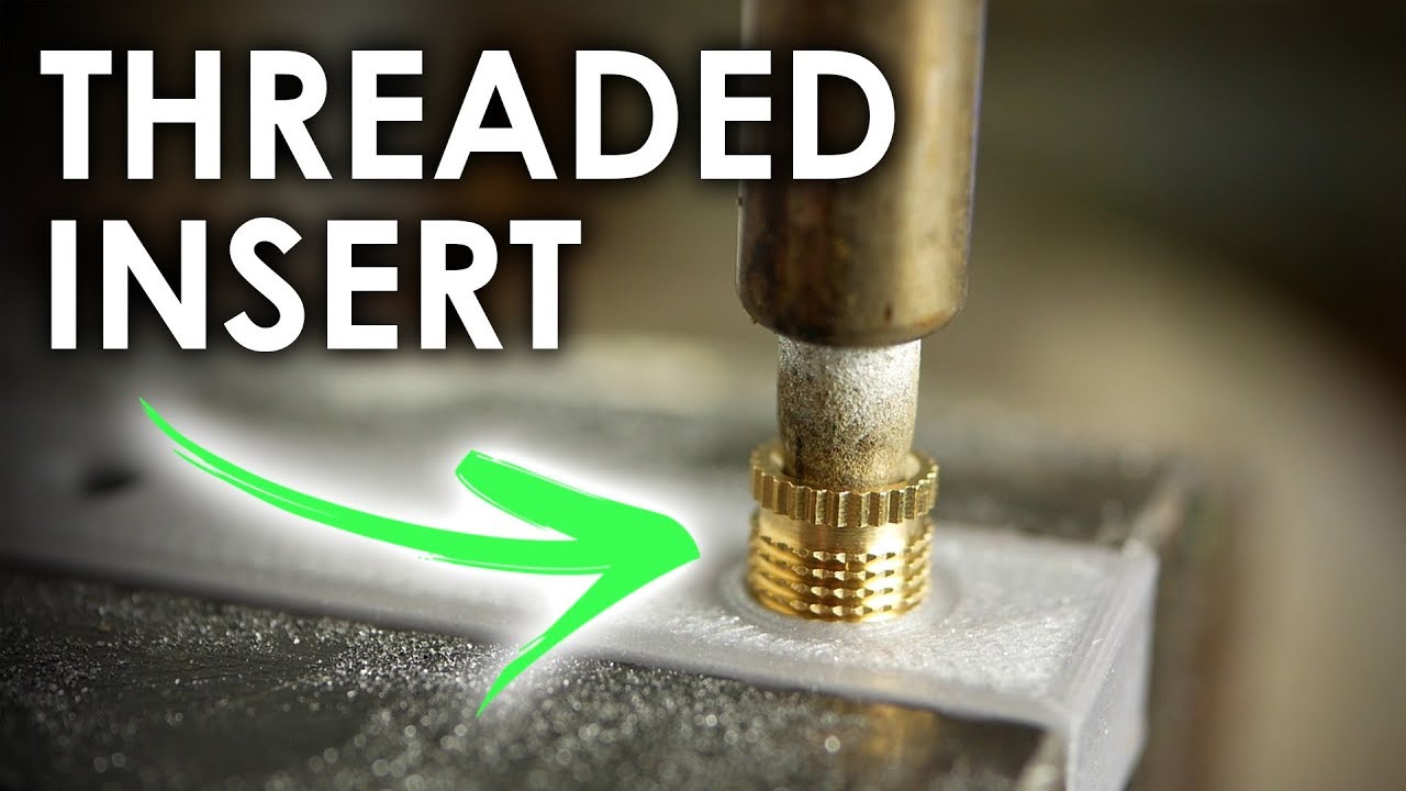

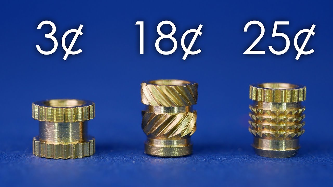

All of the mounts use a pair of M3 heatset inserts. CNC Kitchen has a couple of videos on using threaded inserts on 3D printing that are awesome which talk about them in general as well as how to install them.
Threaded Inserts in 3D Prints - How strong are they?
Threaded Inserts for 3D Prints - Cheap VS Expensive 💰
For our application, we found a fairly inexpensive and commonly available insert that works great. A drawing of the insert can be found below.
