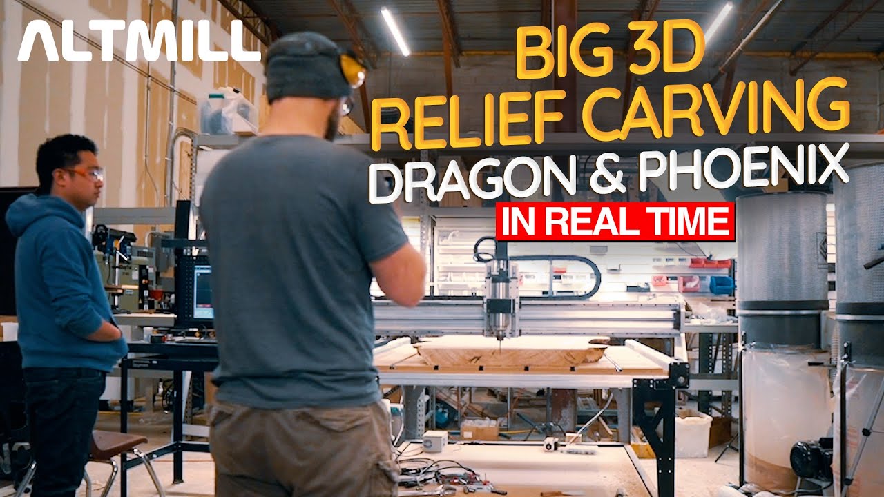

Hey guys, it’s Andy here. We’re excited to be launching a new CNC machine, the AltMill! This article is designed to tell you everything about the AltMill that we possibly can.
Dragon and Phoenix Carving

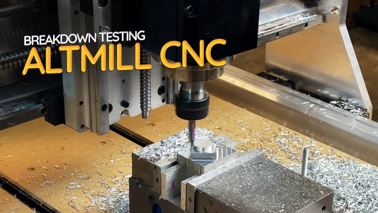

Here are some spec comparisons to highlight the differences between AltMill and LongMill:
  • We’ve tested the AltMill to over 830IPM (although regular cutting speeds are in the 250 to 500IPM range) in cutting speed, while most projects we run on the LongMill run at 100IPM.
  • Based on our deflection testing, the AltMill is approximately 8x more rigid than the LongMill.
  • While the LongMill’s main bottleneck in cutting speed is in motor power and rigidity, the AltMill’s bottlenecks are in spindle power and the strength of the endmills. We estimate that the AltMill could handle upwards of 6KW of spindle power (although it’s not likely we’ll dive into that anytime soon because there are a lot more expensive electrical requirements we need to tackle to get this set up for the average user).
