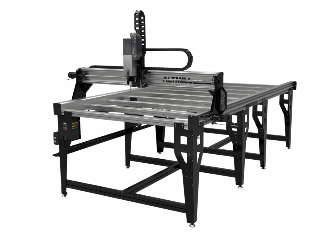

What is the AltMill 4×8?
AltMill 4x8 Product Shot
AltMill 4×8 Rendering
Our goal for the AltMill platform was to find the best balance between cost and performance, offering production level productivity at a price point affordable to beginners and hobbyists. The 4×8 variant takes this to the next step, allowing users to process full 4ft x 8ft sheet materials.
The AltMill 4×8 has some similarities with the 2×4 and 4×4 sizes, but uses redesigned components to extend the Y axis travel to just over 8ft. The fundamental design of the original AltMill was scaled up to achieve high performance with a larger working area, including increased Z-axis travel and clearance.
The 4×8 format is especially important as it represents one of the most standard sizes used in professional and industrial shops, for most materials like plywood, MDF and plastics. We expect more users to focus on building a business and scaling up their work for making money with this type of machine.

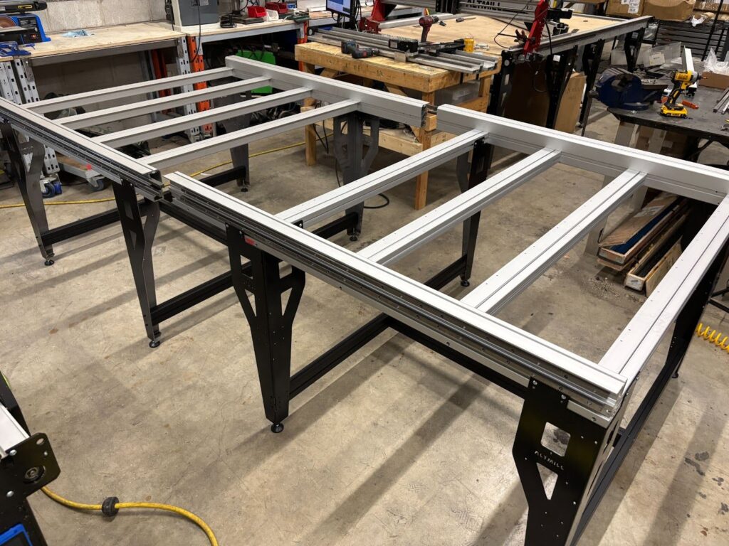

Linear Rail, Rack and Rail Coupling
One of the main challenges of bringing a 4×8 form factor machine to market is getting it to the end user. Simply put, limitations to the size and weight of packages shipped through courier cannot allow linear motion components used in the Y axis to be shipped in a single piece, unlike with the 2×4 and 4×4 machines. This means that these components need to be aligned and coupled together by the user. A significant amount of engineering was done to ensure the smooth and accurate coupling of these components.
Some designs and innovations in this space include developing:
  • A special bracket and process for joining the two lengths
  • Adjusting the spacing between linear motion parts and tolerancing to reduce the impact of gaps in between components
  • An easy to follow process to reduce assembly error
Easy assembly identical tables halves, joined together

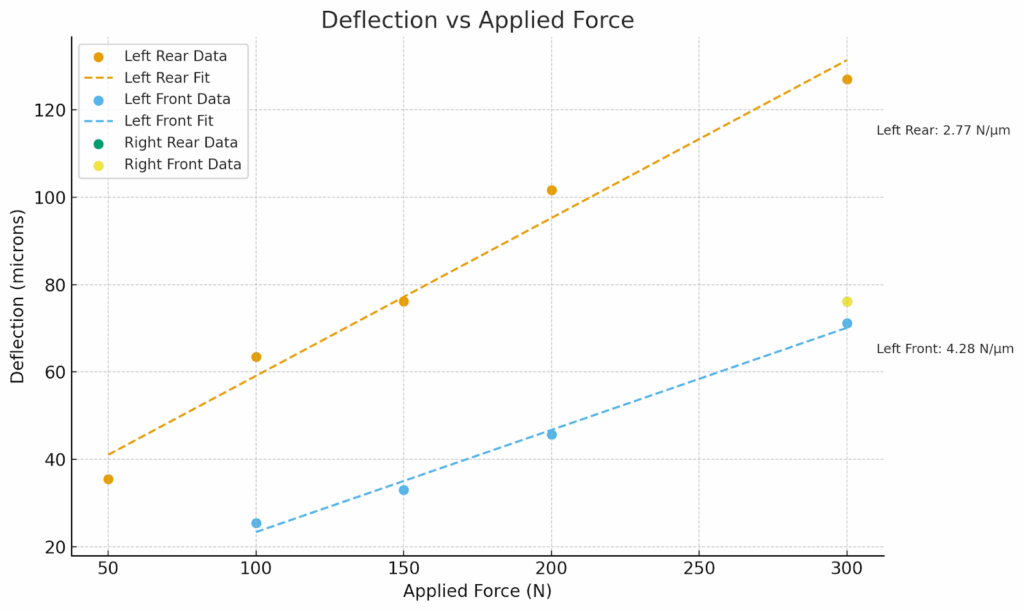

Rack and Pinion Engineering
A big debate when it comes to choosing rack and pinion versus ball screw has revolved (haha) around the accuracy and precision differences between both tools. While ball screws can generally achieve higher precision, ball screws come with several downsides that make them less accurate over longer distances.
First is that a longer ball screw can flex more easily. Since the ball screw is only secured at each end, it means that it can bend from cutting forces. This also can be exacerbated with any whipping that happens, which can introduce vibrations and limit the speed of which the machine can move.
Rack and pinion on the other hand is mounted along the length of the rack. This means that there is much less flex in the system.
Additionally, ball screws cannot be joined together. Due to shipping limitations, the Y-axis parts must be separated and shipped in segments. Since racks can be butted together to make longer racks, this is not a problem with rack and pinion.
It’s also important to note that the theoretical differences between rack and pinion are more relevant in very high precision applications such as commercial vertical machining centers, and less so in the application of CNC routers, where your material and cutting tool is more likely to influence the accuracy of your parts.

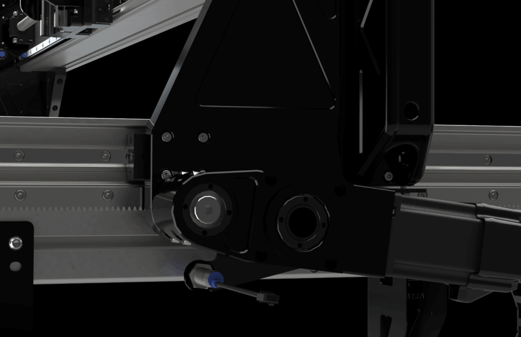

Pinion Tensioning System
To ensure proper meshing of the pinion to the rack, we’ve also developed our own pinion tensioning system, which allows for the pinion to have the proper preload for eliminating backlash against the rack and adjusts for wear over time. This also allows for slight misalignments and tolerances in the machine and assembly process.
Gearing
To ensure high levels of precision, the motors are geared down to increase torque and increase resolution of the motor. We found that stepper motors also have a small amount of “elasticity”, which means that when they are held stationary, they can turn very slightly when a load is applied. Given the lower friction and higher distance to rotation ratio, this effect makes a bigger impact to the precision of the machine position while it is stationary. By gearing the motor down approximately 5:1, it effectively reduces the impact of “elasticity” as well.

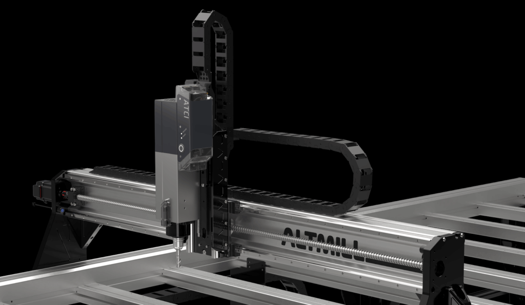

ATC
For those who don’t know, we have been actively working on an ATC spindle. We’re wrapping up development and production, but here’s some details to share before we do a full announcement:
  • Price: 2500USD-3000USD
  • ISO20 toolholders with ER20 collets
  • Capable of expansion up to 12 slots/tools
  • 220V, 2.2KW
  • Air-cooled via low-noise electric fan
Users must provide an air compressor and dryer (such as a desiccant dryer). The ATC has been developed specially to be compatible with most consumer grade compressors (around $300).
ATC Spindle Rendering

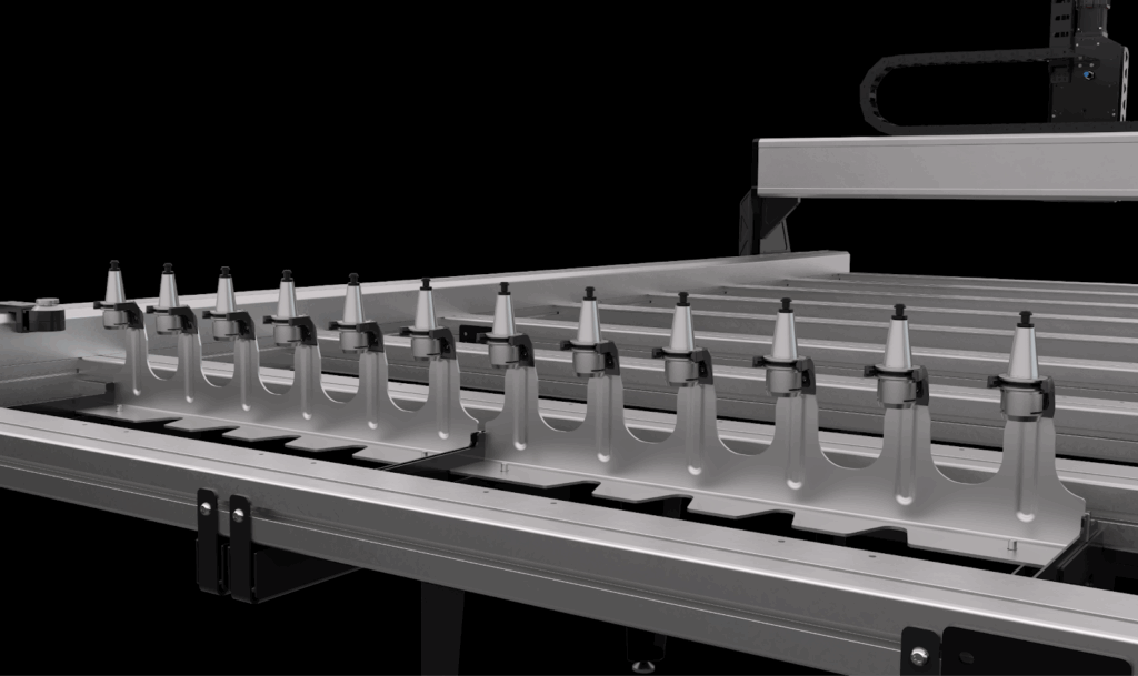

ATC Tool Rack Rendering
Our ATci is specially developed as one of the most integrated, advanced, and beginner friendly ATC systems, with features including:
  • Plug and play operation, with native integration with gSender allowing easy re-mapping/selection of tools for a given job
  • Advanced safety features, including integrated: pressure sensing; temperature monitoring; tool in spindle check; and tool in rack sensing to monitor the state of the spindle at all times
  • Easy to remove toolrack to allow users to switch to allow passthrough/tiling operations
  • Designed for quietness. Low noise cooling fans and air seal that turns off when not in operation
