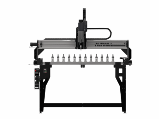

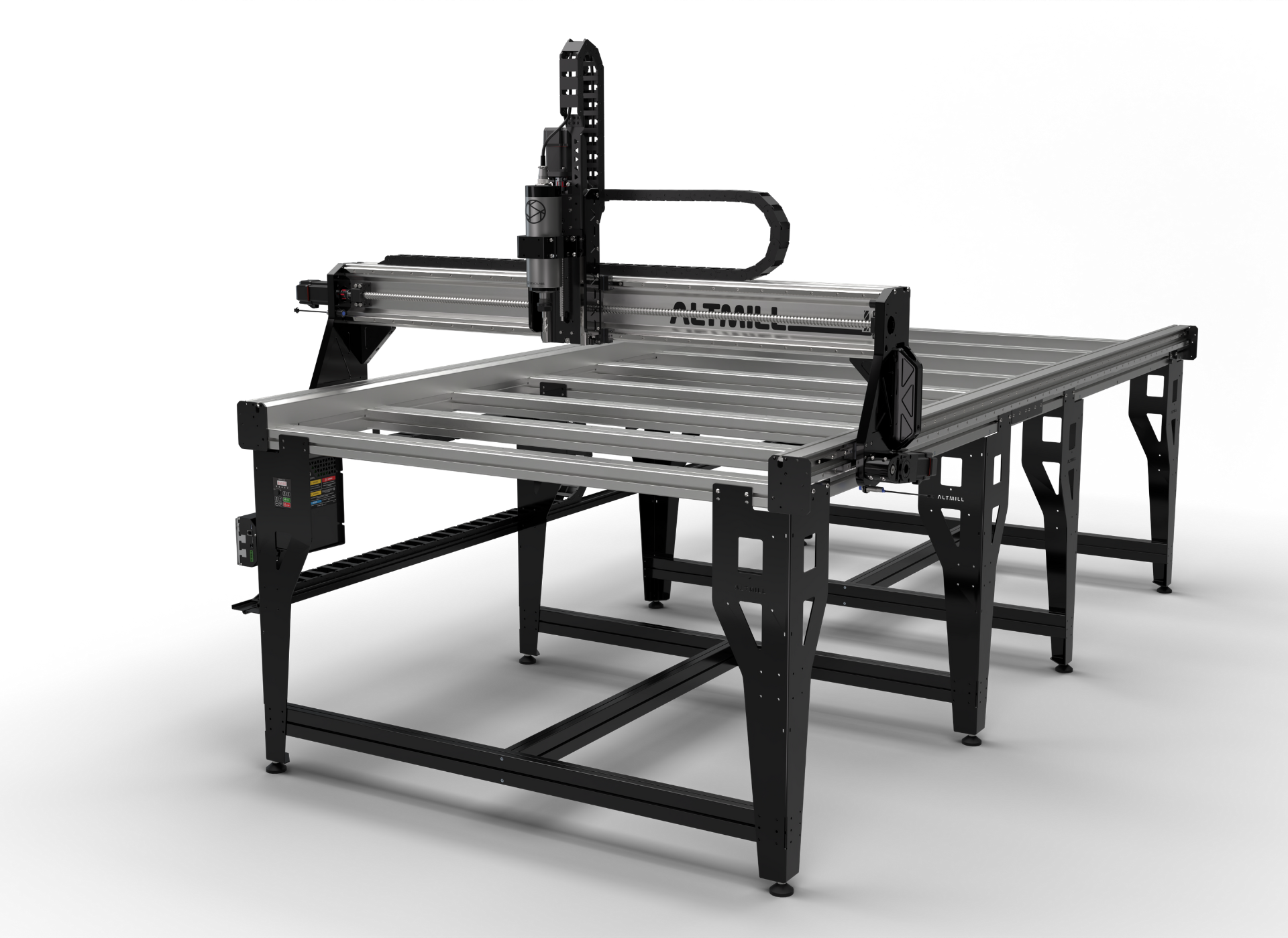

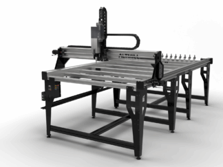

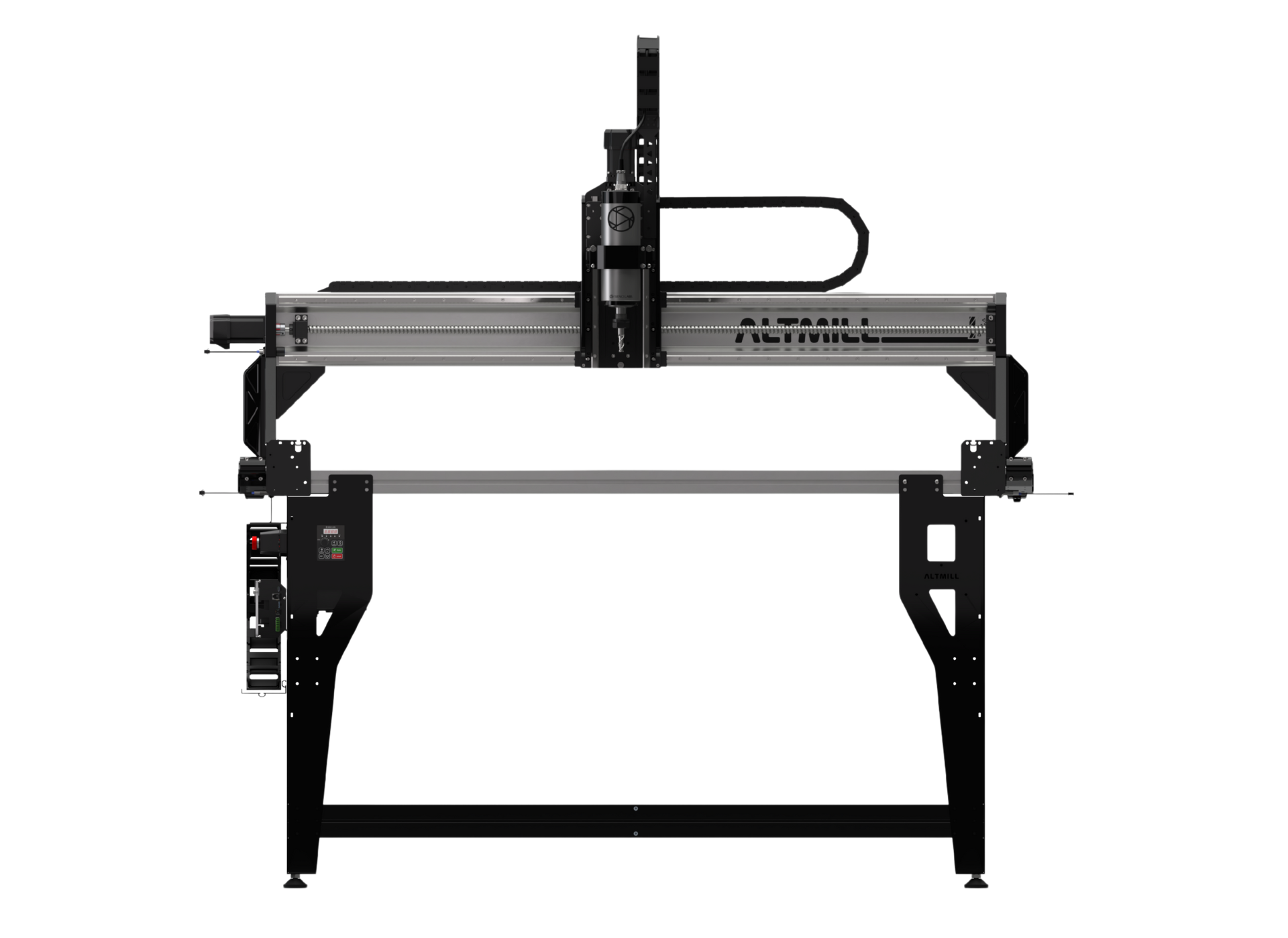

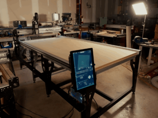

The AltMill 4×8 is the next generation of prosumer CNCing. Designed for power, precision and production, the 4×8 has the production reliability and rapidity professionals need, and the value and rigidity advanced users want. Built for sheet goods, the AltMil 4×8 is a turnkey CNC that makes large format cutting a breeze.
The AltMill 4×8 comes with a standard 80mm spindle mount only. It does not come with a spindle or an Automatic Tool Changer system, which must be purchased separately. If you purchase an ATC you will lose cutting area. See FAQs.
Ontario, Canada Customers: Starting April 29th, we’ll be pausing sales for all sizes of AltMill. Please read further on specific plans for each machine – ESA Compliance.
Lead Time: 4 weeks
    Description

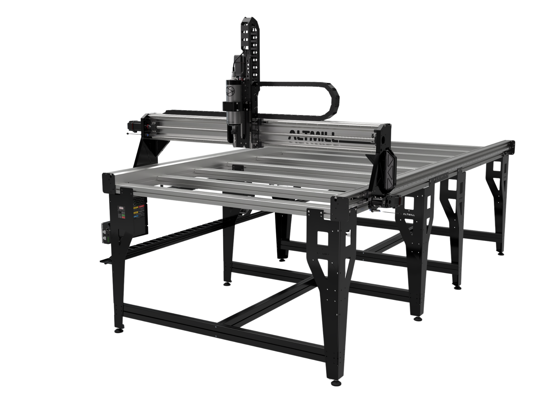

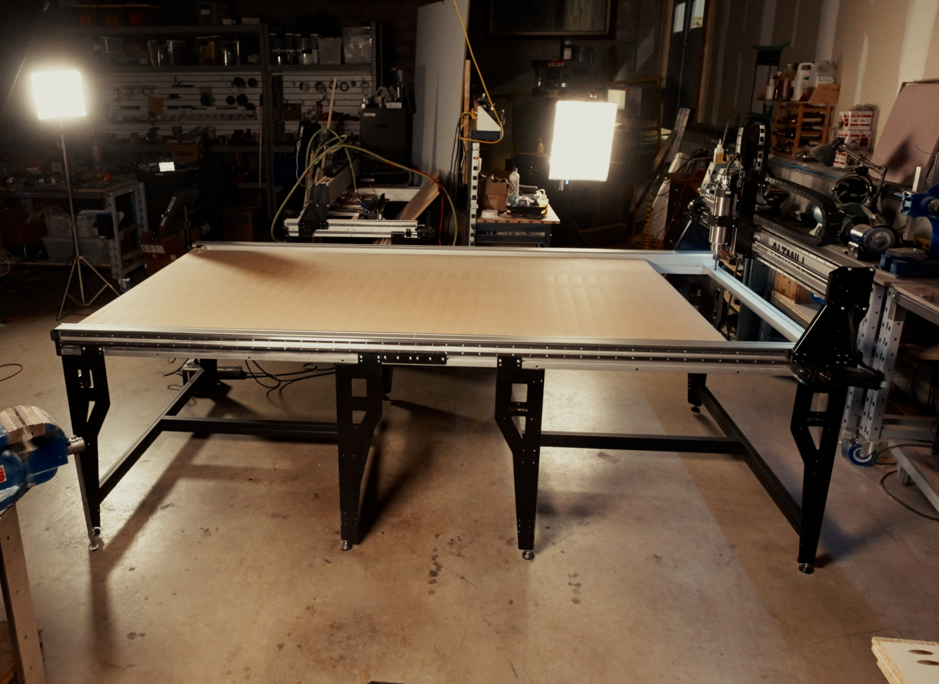

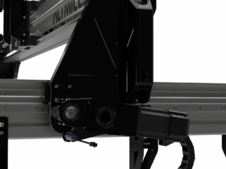

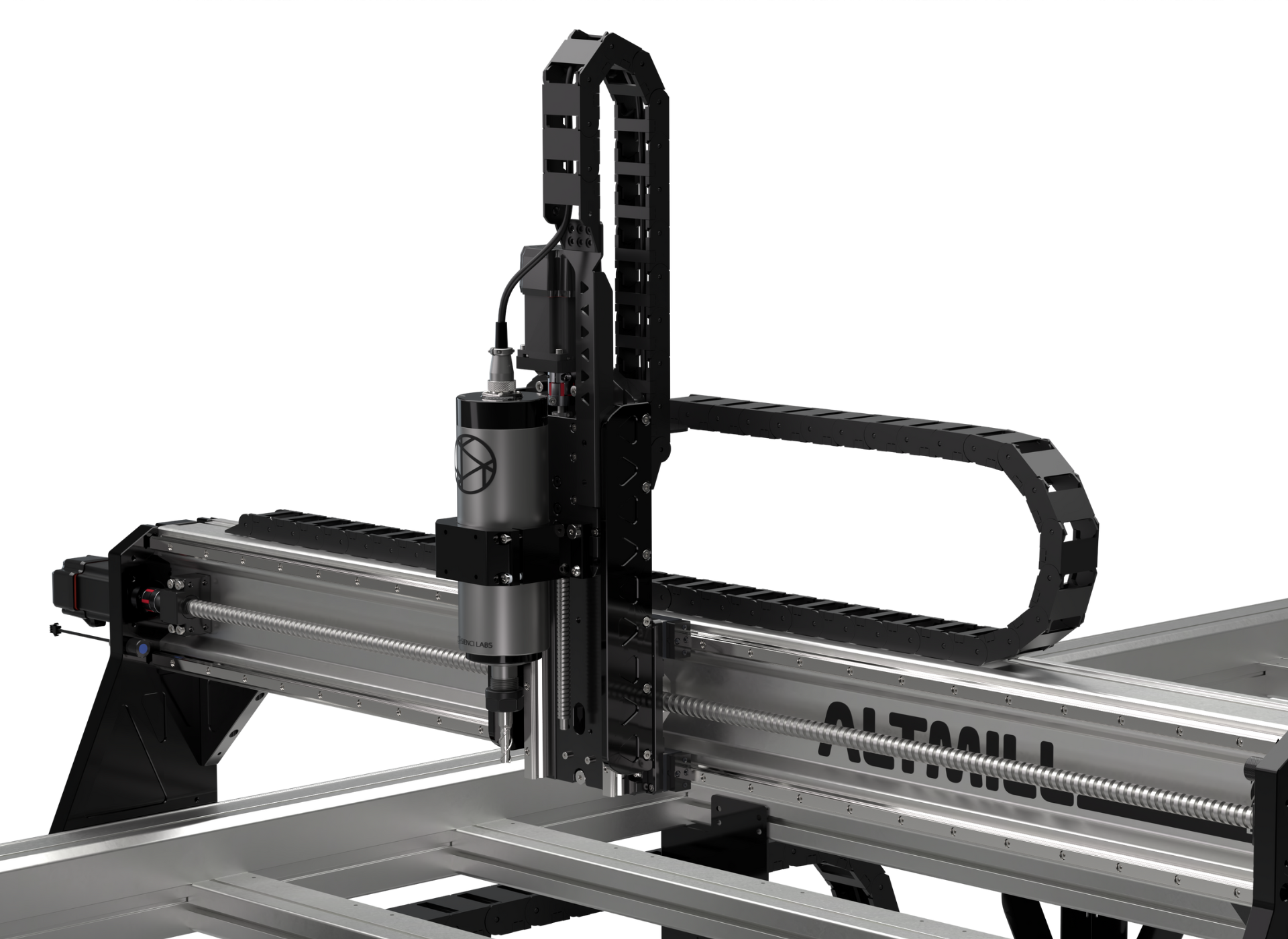

    Highlights:

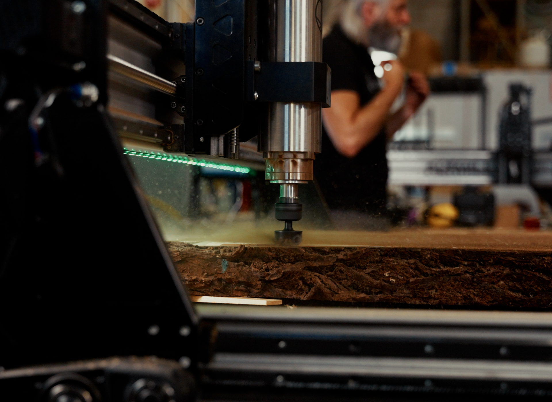

      • Production level cutting speeds (approx. 1,000 inches per minute)
      • Closed loop motor system on all three axis to auto-correct positioning and auto-stop when necessary (reliable for production style work)
      • Requires little maintenance during project production
      • Advanced, production-style features including Y-axis auto-squaring; limit switches by default; and tram adjustment capabilities

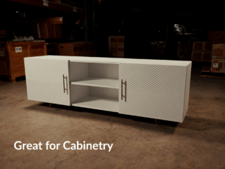

      • Cuts materials ranging from hardwoods to plastics, foams, composites, aluminum – even steel
      • Support for 80mm spindles and routers

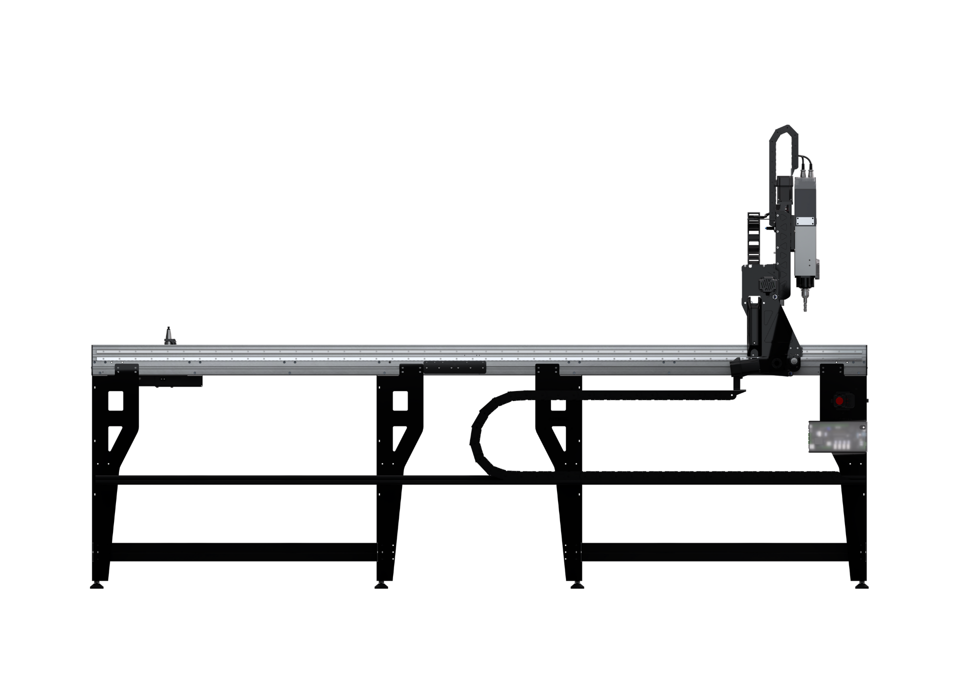

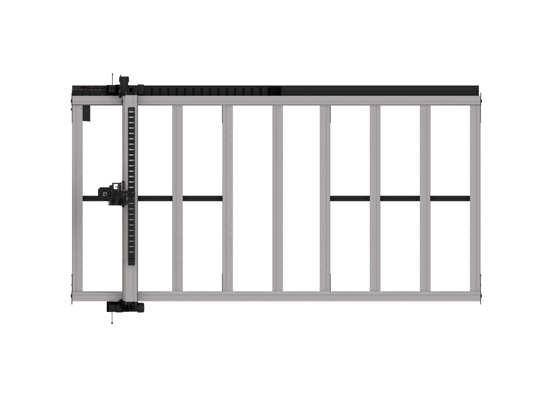

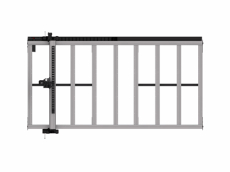

      • 49.8″ x 104″ working area with a max Z-height of 8.3″ (1265 mm × 2640 mm × 210 mm)

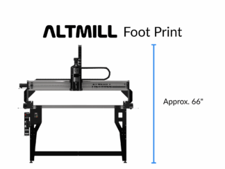

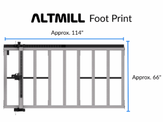

      • Footprint of roughly 66″ wide and 114″ deep

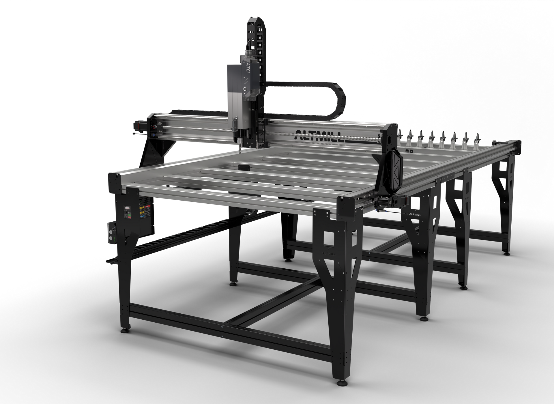

    What's Included
    ***Included with your AltMill 4×8***
    • SLB-EXT controller and emergency stop
    • Partially pre-assembled rigid frame
    • Inductive sensors for homing
    • Sturdy metal legs with the ability to add 4ft wide shelving underneath
    ***Not included with your AltMill 4×8***
    Check out our recommended products tabs for an ideal set up, but note the following ARE NOT included with your order:
    • Computer or laptop
    • Spindle
    • End mills or bits
    • T-tracks
    • Waste board (e.g. MDF 4ft x 8ft sheet)
    • Set of metric Allen keys, standard bits or drill for assembly
    • LED strip lights (Learn how to install)
    The AltMill 4×8 does not come with an ATC System or Spindle Kit. They must be purchased separately. Images may contain items for illustrative purposes, including but not limited to: spindles, ATC systems, caster wheels, t-tracks or additional shelving. There may also be cosmetic differences between the machine in the photo and the production version of the AltMill. Some photos may also be engineering renders of the machine.

    • Footprint: Roughly 66″ wide and 114″ deep
    • X, Y, Z Axis Working Area: 1265 mm × 2640 mm × 210 mm (49.8″ x 104″ x 8.3″)
    • Z-axis Maximum Stock Clearance: 203 mm (8″)

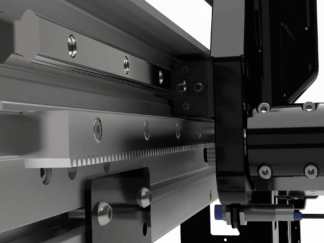

    • Rapid Traverse Speed: Approx. 25,000 mm/min (1,000 IPM) in Y-axis; 16,000mm/min (590 IPM) in X-axis; 6,000mm/min (236 IPM) in Z-axis
    • Repeatability: ±0.05 mm (±0.002″)

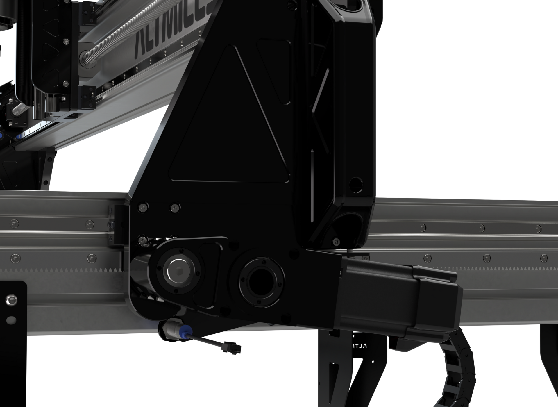

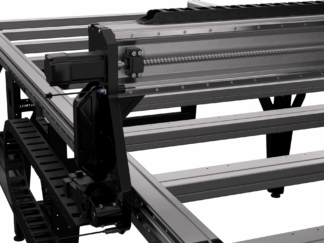

    • Motion System: Rack and pinion using precision gearbox reduction on Y-axis; 16mm precision ball screw on X-axis; 12mm precision ball screw on Z-axis
    • Linear Motion: 15mm profiled linear guide rails and bearing blocks on all axes
    • Drive Motors: High-Torque NEMA 23 Closed-Loop Stepper Motors. 3NM torque on Y-axis; 2NM torque on X and Z axes.
    • Control System: SLB-Ext 32-bit controller with grblHAL firmware
    • Power Requirements: 120VAC, Single Phase, 4A (Spindle power requirements listed separately)
    • Weight: Approximately 400lbs as assembled, not including weight of add-ons such as spindles
    • Spindle Mount: Supports 80mm spindles and routers
    • Frame Construction: Rigid frame and linear motion design using HGR15 linear guides and custom-designed, machined aluminum extrusions; with sturdy metal legs with the ability to add 4ft wide shelving underneath for sheet goods

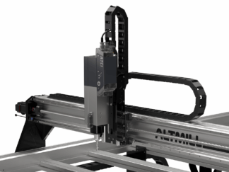

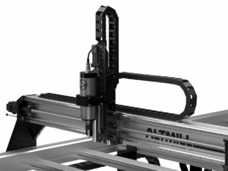

    Must Have Add-on: 1.5kW, 2.2kW Spindle or 2.2kW ATC Spindle
    Unlock the full potential of your AltMill with a 1.5W or 2.2KW ER Spindle and Dust Shoe Kit, or, an Automatic Tool Changer Spindle Kit
    Each 1.5KW ER20 Spindle & Dust Shoe Kit comes with:
    • 80mm Dust Shoe
    • ER20, 80mm, 1.5KW 110V Air-Cooled Spindle
    • 110V, 1.5KW, 3-Phase VFD
    • AC power cable and 5m spindle power cable
    • ER20 1/8″, 1/4″, 3/8″and 1/2″ collets (one of each)
    • Data cable to connect to the AltMill/SLB-EXT controller for remote speed control

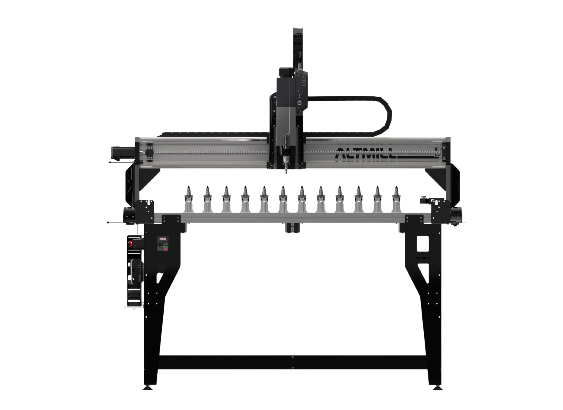

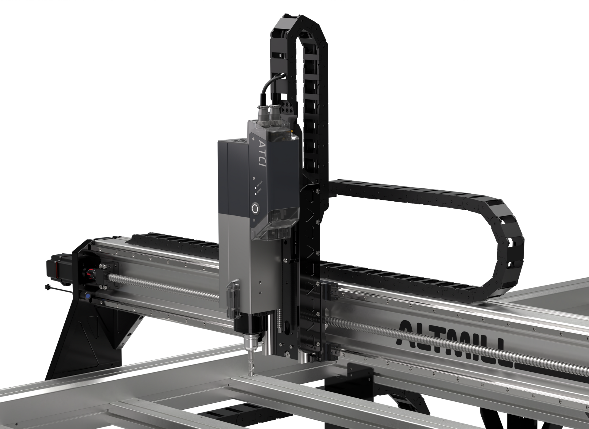

    Each ATC Spindle Kit comes with:
    • 2.2kW ATC Spindle
    • ATC Spindle Mount
    • Enclosed 2.2kW VFD and Mount Adapter
    • Clear Cut Dust Shoe
    • Tool Length Sensor
    • ATC Expansion Board for an SLB-EXT Controller
    • 2.2kW VFD NEMA 6-15P Power Cord
    • 10m Length 8mm Air Line Tubing
    • Male ¼” NPT to 8mm Air Line Push Fitting
    • ER20 Collet Wrench
    **Each ATC Spindle Kit comes with a variety of tool holders, collets or racks (or no rack.) Read for more details.

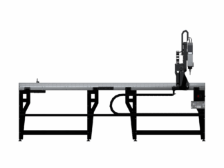

    How much travel will the ATC tool rack take away from my AltMill?
    You will lose some travel once the Tool Rack is installed. Here is the remaining area to play with:
    • 4×8: 98.7”

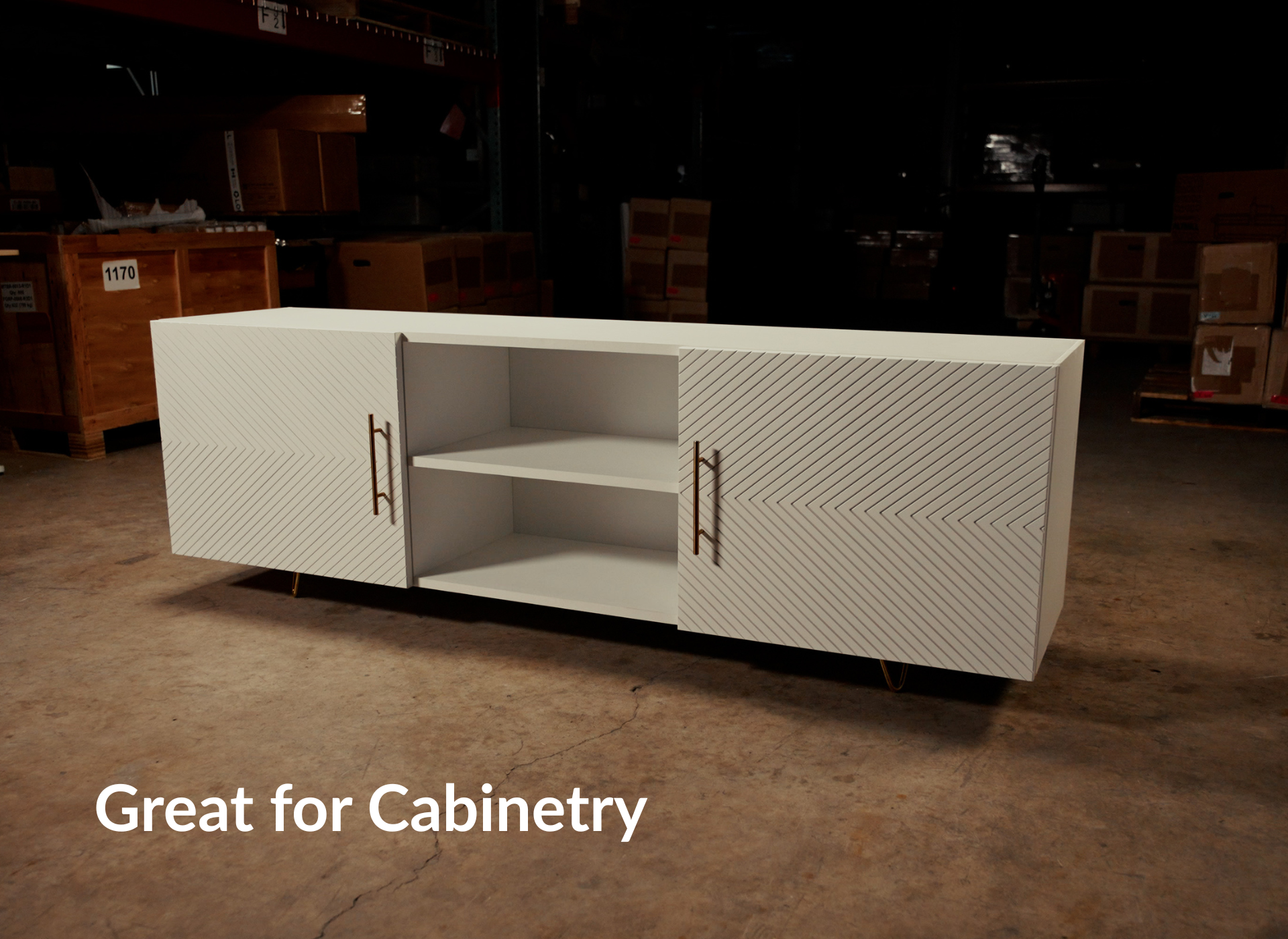

    What materials can the AltMill 4×8 cut?
    If you can name it, the AltMill pretty much has it covered:

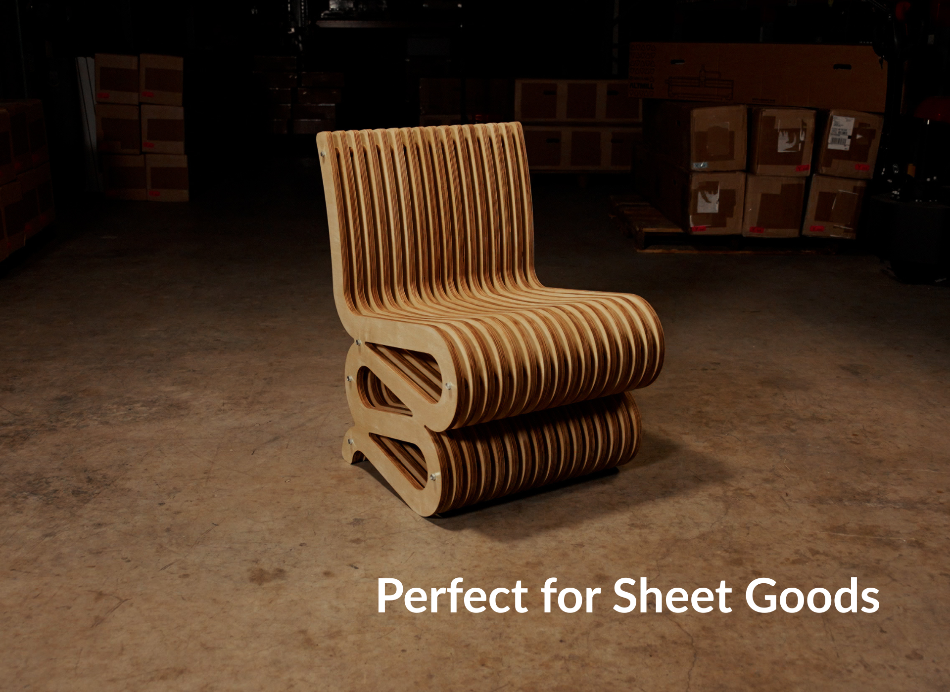

    • Woods: Softwoods, hardwoods, plywood and  MDF
    • Plastics: Acrylic, PVC, HDPE, Polycarbonate and  ABS
    • Composites: Carbon Fiber, Dibond and ACM
    • Non-Ferrous Metals: Aluminum, brass and copper (with appropriate lubrication/misting and cutting strategies)
    • Ferrous Metals: Carbon steel, alloy steel and  cast iron (with appropriate lubrication/misting and cutting strategies)
    • Foams: High-density sign foam and insulation foam

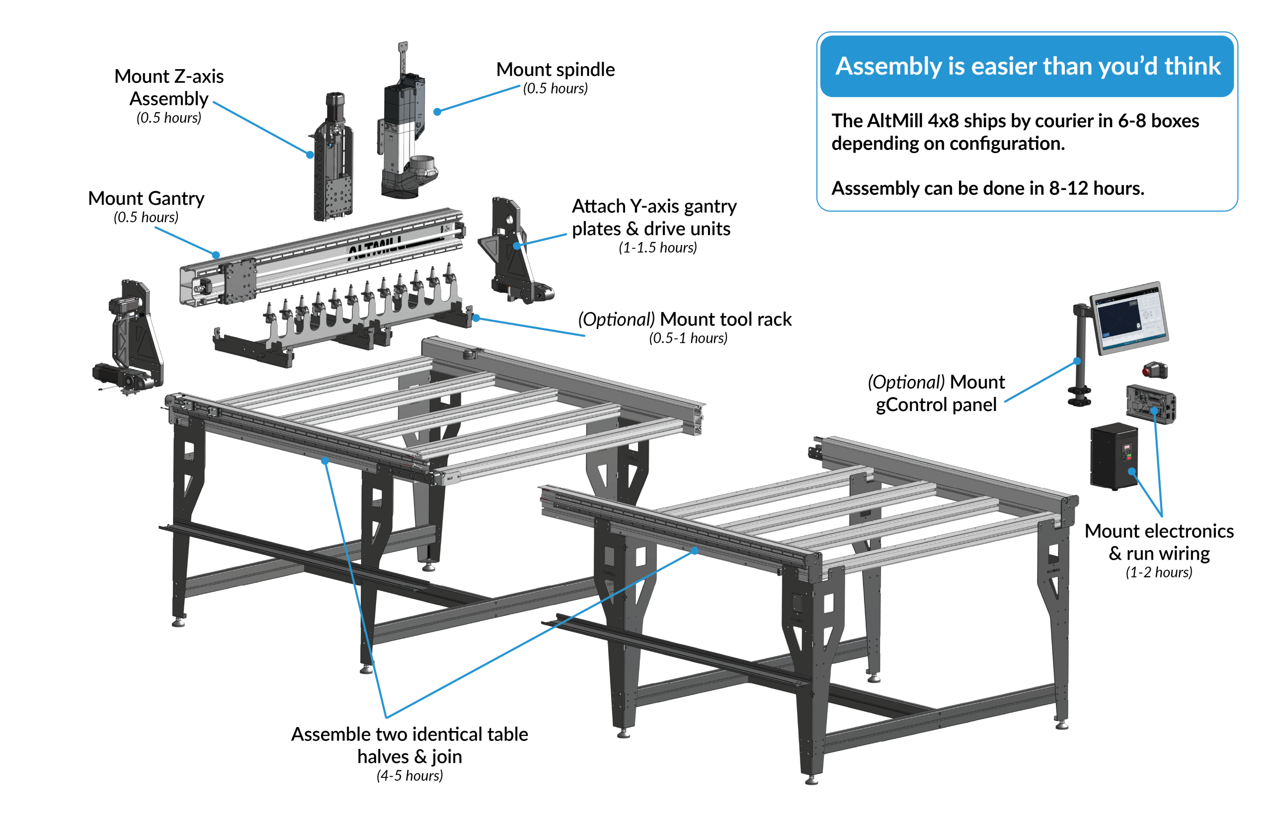

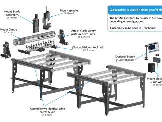

    How much assembly is involved and how long will assembly take?
    The 4×8 is big, so it’s going to take some extra time. Grab a partner to make assembly easy, and it’ll take roughly one day to fully set up. It will come with all major subassemblies, pre-assembled and precision components are pre-aligned. Check the “Assembly Instructions & Help Resources” tab for more info.

    Will the AltMill 4×8 work with an ATC?
    Heck ya. Our ATC system will be fully compatible with the 4×8 and all other sized AltMills.

    How big is the AltMill 4×8?
    The footprint of the AltMill is approximately 114″ long x 66” wide, and over 66” tall (when including spindle height).
