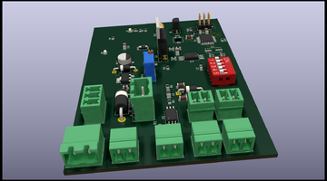

  • Laser Driver: I have our first 2 pcb driver designs. Will be ordering assembled prototypes this week
  • Laser Driver Enclosure: Now that I have a few pcb designs, I will begin designing an enclosure

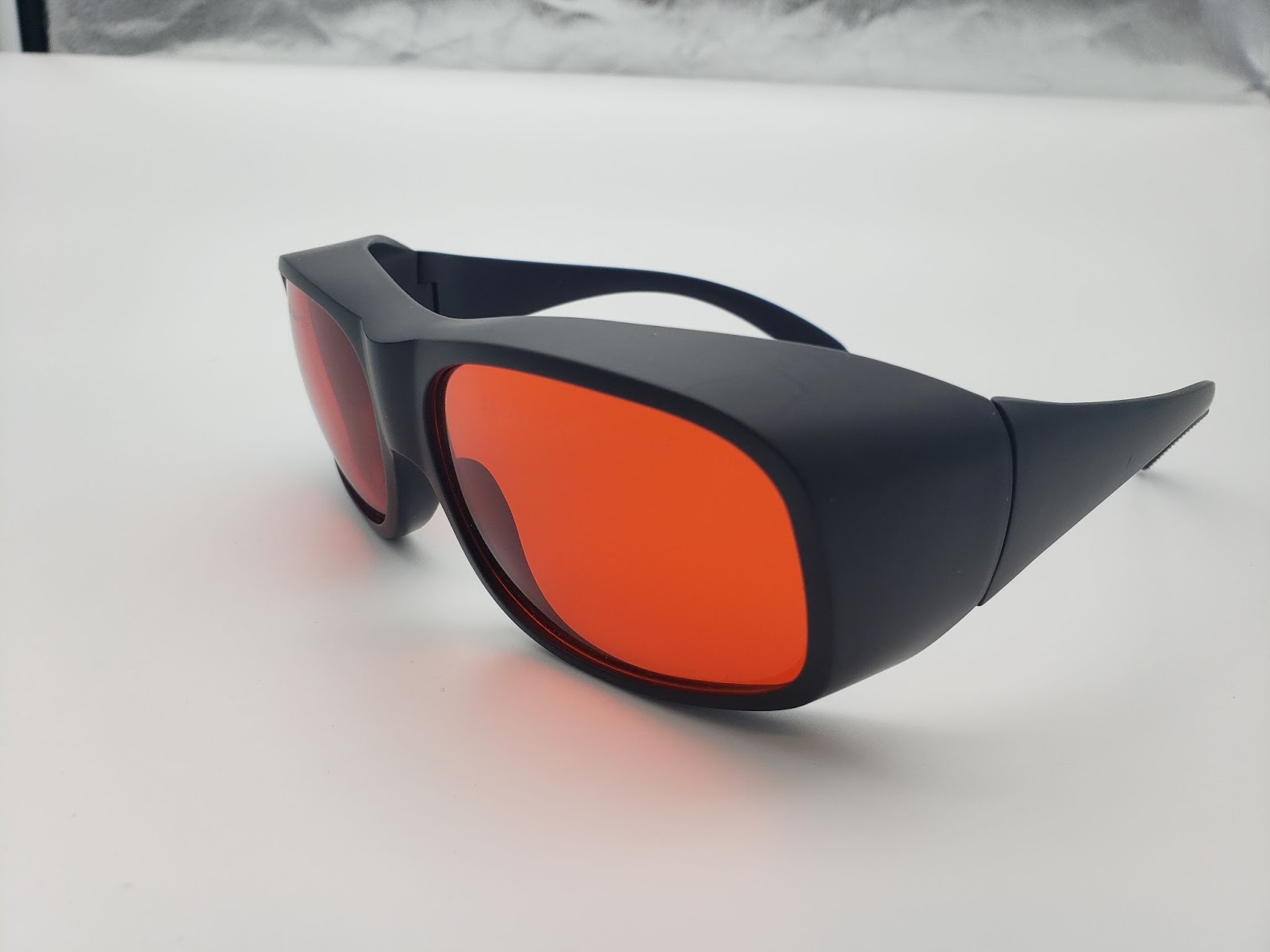

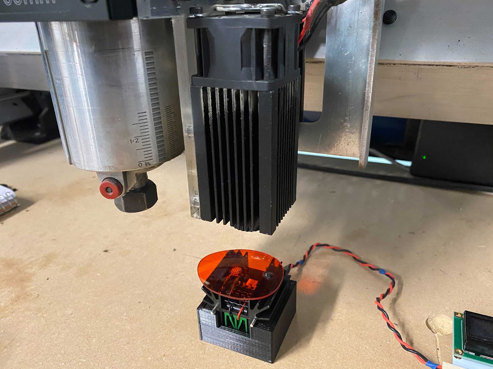

  • Safety Goggles:Testing safety goggles is complete and I will be looking to place an order in the next week.
    • To summarize the testing procedure: I used a laser power meter to measure optical power and then ran the same test with the safety goggle lens between the laser power meter and the laser. This effectively tested how much optical power made it through each lens of the safety goggle. Although most suppliers kept it under the FDA recommended limit of 5mw, there was one supplier that stood out.
