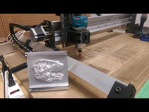

Our real life testing
Over the last couple years, we’ve heavily abused our Makita routers, such as by cutting large amounts of aluminum and wood at a time. We do run tests as well that involve crashing the machines while the Makita is still running to test the effects of changes in the electronics which can completely stall the router. We also have built custom industrial-focused machines that use the same router. Here’s an example of a project where we used a Makita router to cut aluminum.
Some of our tests include cutting through upwards of half an inch of hardwood using our 22mm surfacing bits to stall the router.
