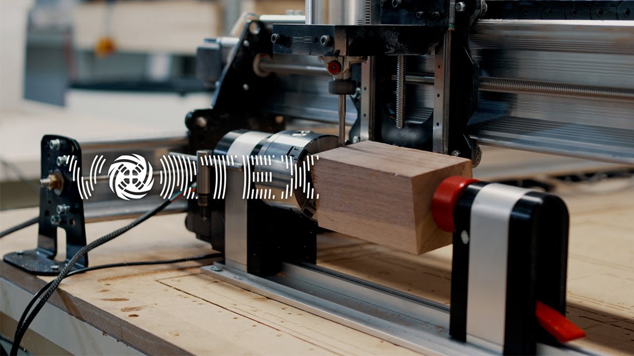

The Vortex Rotary Axis is an add-on created to allow users to integrate a rotary axis into their LongMill.
Most CNC routers like the LongMill use a 3-axis system, which consists of an X, Y, and Z linear motion system that is used to position bits and end mills. One of the limitations of a 3-axis system is the fact that 3-axis machines cannot make “undercuts” without flipping or material manually. Since the machine only can orient the bit vertically, there are limitations to the types of geometry it can carve.
Source httpswaykenrmcomblogsundercut machining for cnc machined parts
To address these limitations, CNC machines can come with additional degrees of motion, typically including a 4th or even 5th axis. In the case of the LongMill, a rotary axis positioned along the X direction allows the machine to turn a part as the X and Z axis can move in sync as the material turns and rotates.
On a mechanical level, the 4th axis for the LongMill will come with a chuck to hold the material as well as a series of bearings and pulleys connected to a stepper motor to rotate the material as the machine carves. This allows for users to make projects like:

In the current configuration, the Rotary Axis uses the X-axis and Z-axis to move along the rotational axis of the material, with the Y-axis drivers disconnected and reconnected to the Rotary Axis motor to provide rotational movement. This means that in this configuration, the system is not a full 4-axis machine, but more of a 2-axis + rotary system. Each kit will come with a switch to toggle 3-axis and rotary axis modes.
In the future, we are planning to provide full simultaneous 4th axis motion through the SuperLongBoard, expected to launch at the end of the year (at an added cost).
