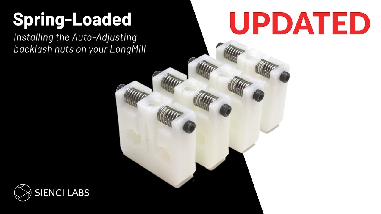

Spring Loaded Anti-Backlash Nuts
Spring Loaded Anti-Backlash Nut Update | Sienci Labs LongMill MK2 CNC
I’m excited to say that the first set of the injection molded nuts has arrived. To learn more about this project, please see the long post about them here (put link here). While the T8s overall look good and function properly, unfortunately, we are still experiencing some warping and inconsistent threading on the T12 nuts. Since not all the nuts are affected, we’ve put on the store all of the nuts that are currently ok. We will work with our manufacturers to iron out the issues with the T12 nuts.
Demand for the new nuts has been super high, with all of the T8s already sold out, and with T12s expected to be close to selling out by the time this post goes out. Not to worry, however, we are working on making another batch of a few hundred sets and make sure we don’t run out.
It should be noted that existing LongMill kits will continue to ship out with the original style of nut. Once we catch up on orders sold for replacement, we will start moving to making them a default option for new machines. We currently don’t have a specific timeline for it, but likely in about 2 to 3 months, since production and assembly of the nuts can take a long time.
Spring-Loaded Backlash Nut Installation Guide for LongMill CNCs by Sienci Labs, Updated
