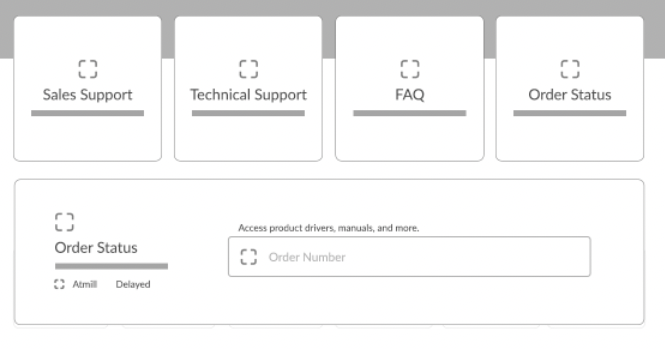

Test site
Example wireframes

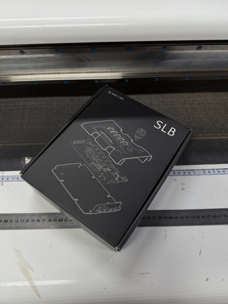

Packaging samples for the SLB-EXT V2

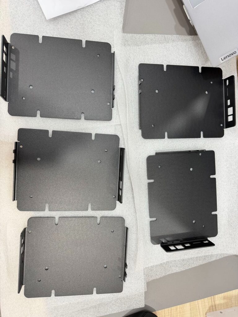

  • Manufacturing of key components, such as the front and back plates of the controller enclosure
Back panel samples

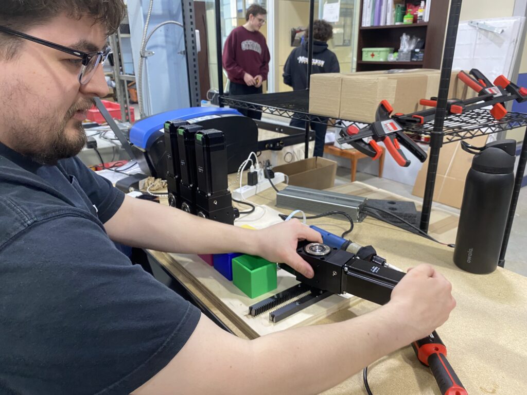

As mentioned in our last update, we’re in the process of ordering another 300 machines for the new batch. Otherwise we’ve been continuing to do long term accelerated wear testing for the AltMill 4×8, essentially running the machine constantly back and forth 100,000 times at high speed and acceleration, with sudden stops and starts. For context, this is a super extreme condition and we expect no one to ever come close to running it at these conditions.
Here are some of the findings:
  • Change in backlash is essentially non-existent, under 2 thou
  • Motors heat up to 92C, which is close to the 90C limit that the gearbox can handle
  • Besides the bearing retaining ring on the gearbox starting to come loose, all other components are still at the torque they need to be
Overall, this means:
  • Under normal operating conditions, it’s unlikely for users to see any significant decline in performance or accuracy
  • Motors only heat up to their limit at the most extreme conditions
  • We can reduce the chance of the bearing retaining ring coming loose with adding some locktite during assembly. However, given that the machine was run at extreme conditions where the amount of vibration is significantly higher than normal operating conditions, we believe that this is not an issue. We will include in maintenance documentation for users to check the ring during regular maintenance. The good thing is also that when this item becomes loose, it is visually obvious, which makes it easy to address if needed.

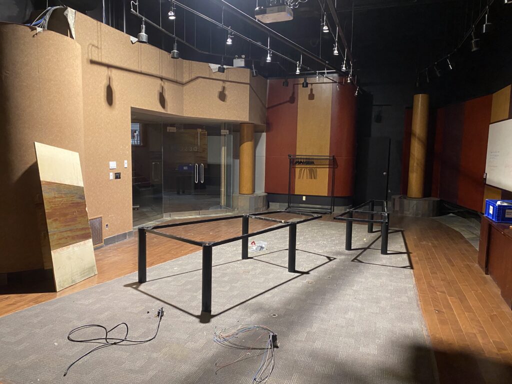

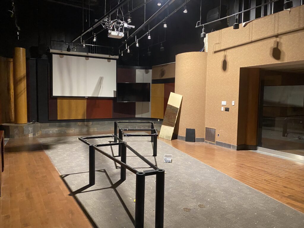

More Space Expansion
Back in the March 2026 Production Update, we mentioned that we added about 2500sqft of production space to our shop. I’m excited to announce that our office expanded again this month by another 3500sqft. This includes around 2100sqft downstairs, which used to be a large boardroom to be turned into media space, where we’ll use as a dedicated filming space for the marketing team. We’re also looking to potentially host classes and events there down the line as well.
The upstairs ~1400sqft is expected to be used primarily as desk space, with some focus for the customer service team, as the space has a couple of enclosed offices, which should allow them to make and take calls in a quieter environment.

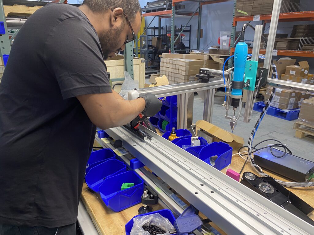

We have been full swing on AltMill 4×8 production, with a bunch of stations now set up for assembly of the new machines. However, we have been delayed a few weeks, and current first machine shipping date is set at April 10th April 17th. Due to some components being off tolerance and needing rework, we are putting extra effort to make sure that the first batch of machines don’t have early stage issues. Some things that are being addressed include:
  • Pitch error on the racks
  • Tooth profile tolerances on the pinons
  • Gearbox backlash
On the bright side, we have ordered enough extra parts so that even with a higher than typical number of QA rejects, we are able to fill a substantial number of the first batch. We are also working on remaking parts to ensure that we can complete the rest of the production batch. We are building and assembling as much as we can as we work through the process in the meantime.
We are also now in production of batch 2, bringing additional considerations and QA processes to reduce potential issues and delays.
In other news, the engineers and marketing team have been working on putting together the full assembly resources and videos over the last few weeks, getting ready to post once the machines start shipping.
Filming and creating content for the assembly process
Assembled units for the gearbox and swing arm mechanisms

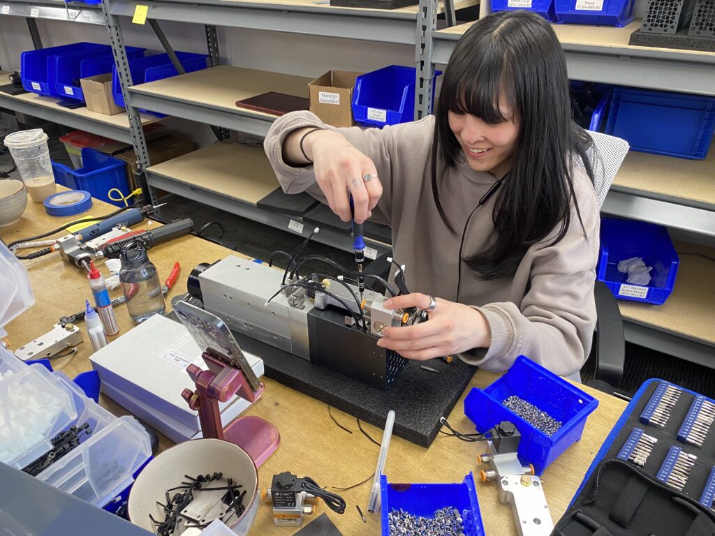

I’m also excited to share that we’ve also implemented a new station with the ATC to machine some aluminum parts in house. We’re expecting to slowly integrate more parts over time that we can machine in house to give us an opportunity to stress test our machines and products, as well as give us more production flexibility or adjust designs more quickly as needed.
Nini prepping ATCs for testing
Ethan checking for Tool Rack defects with a jig
Next step is testing before shipment
