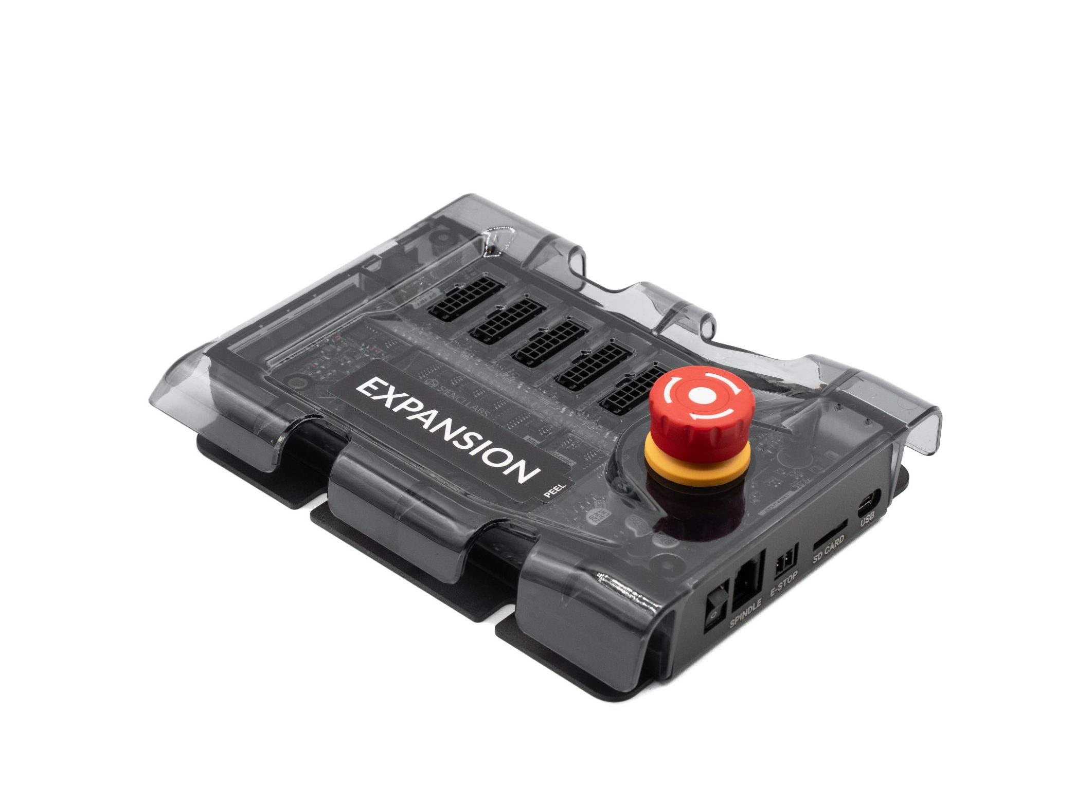

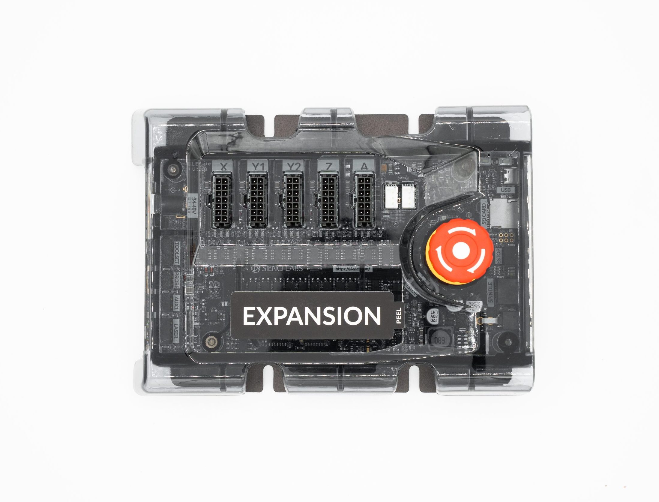

  • An SLB-LITE 32-bit grblHAL Controller with E-stop

  • Control System: SLB-LITE controller with grblHAL firmware

What controller does the MK3 come with?
The LongMill MK3 comes with the SLB-LITE, a newly redesigned version of our original SLB. It uses a 24V power supply, and can support motors (open and closed-loop) with external drivers.
