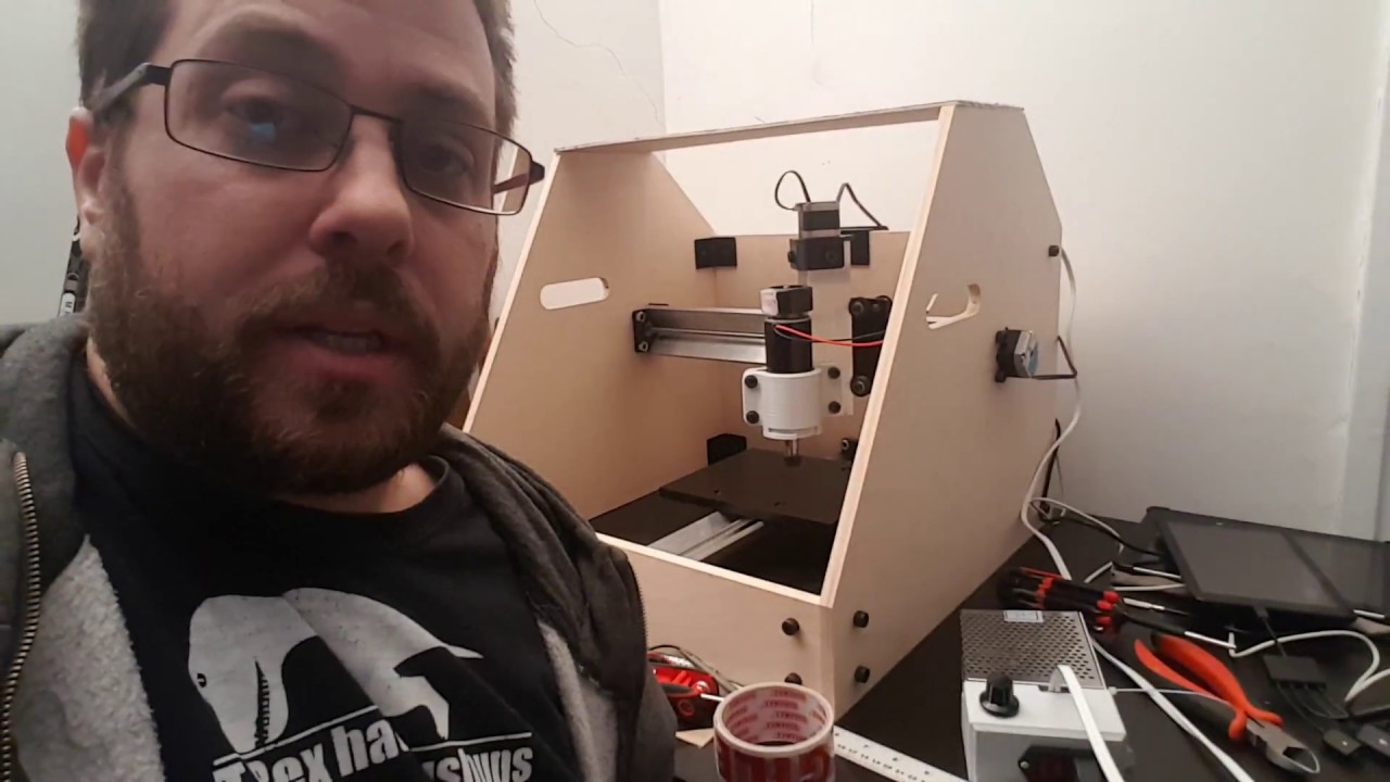

Another pretty cool mod is the one that David has created by extending the axis to 500mm and creating a new frame around it. .
David has also started a Youtube channel to talk about his CNCing adventures. Make sure to check it out and follow along on his adventure.
Here’s his latest video from yesterday!
Spindle is installed - CNC Newbie
