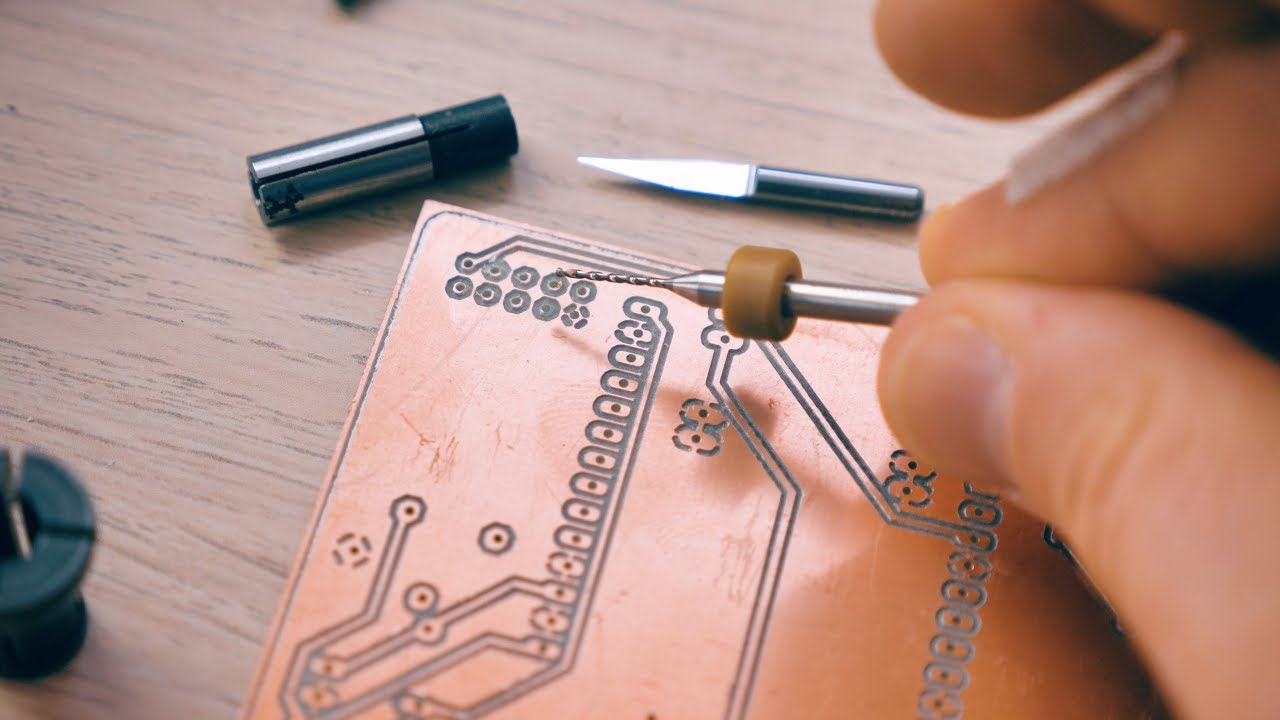

Tom makes PCBs with his Mill One
I thought I would share this since it is making its rounds on Hackaday and Hackster.io.

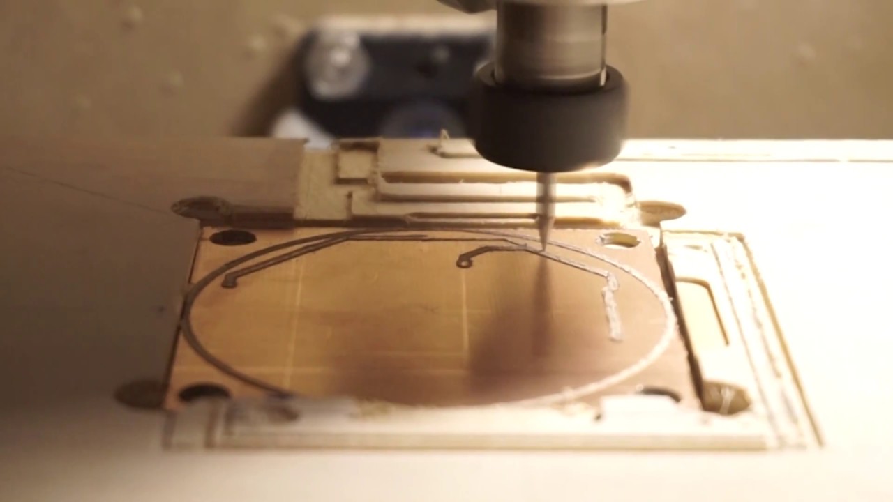

One of the main uses for CNC machines like the Mill One is of course, isolation milling, which uses very fine bits to cut traces for circuit boards. There are a few ways to do this, one of which is to use FlatCAM.
You can of course, also check out Ayesha’s tutorial on PCB milling (https://sienci.com/2018/08/23/pcb-milling-tutorial/), which goes through a similar process.
Looks like according to comments online that the next frontier to getting good milled circuit boards is to use a mesh leveling system. This would of course map out all of the points on the PCB and automatically raise and lower the Z axis to compensate for any irregularities in the thickness of the board.
