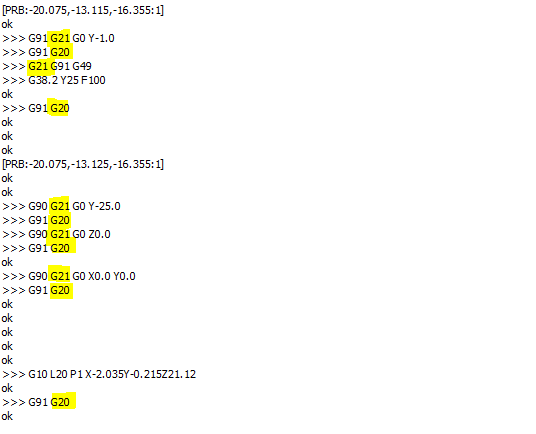

If you are using UGS, there is a bug that can cause the touch plate to move farther than the expected origin of your workpiece, which can plunge the bit into the machine bed. This is due to how the probing module is programmed. When you press “Measure outside corner,” UGS enters the probe cycle process, where it sends commands to the machine to move at a specified speed until either the touch plate is contacted or the machine is done travelling the specified distance. This repeats twice for the X, Y, and Z axes, once fast and once slow.
For the probe process, whenever UGS is specifying co-ordinates for movement, it dictates that the coordinates are in millimeters using the “G21” command. Immediately afterward, it will call the default units from the jog control with either “G21” (mm) or “G20” (inches), which is handy because if your probe cycle fails midway, you can still jog your machine the proper amount. This basic pattern of [mm] [action] [co-ordinates] [inches] continues but stops at the last few lines, where the co-ordinates of the measured offset distances were supposed to be in millimeter values, but because UGS did not put “G21” to call it out in millimeters, UGS assigned the co-ordinates to be in inches, as it was the last command to have been sent. Therefore if the machine was supposed to move 2 mm to get to the origin of the workpiece, then it will now move 2 inches.
