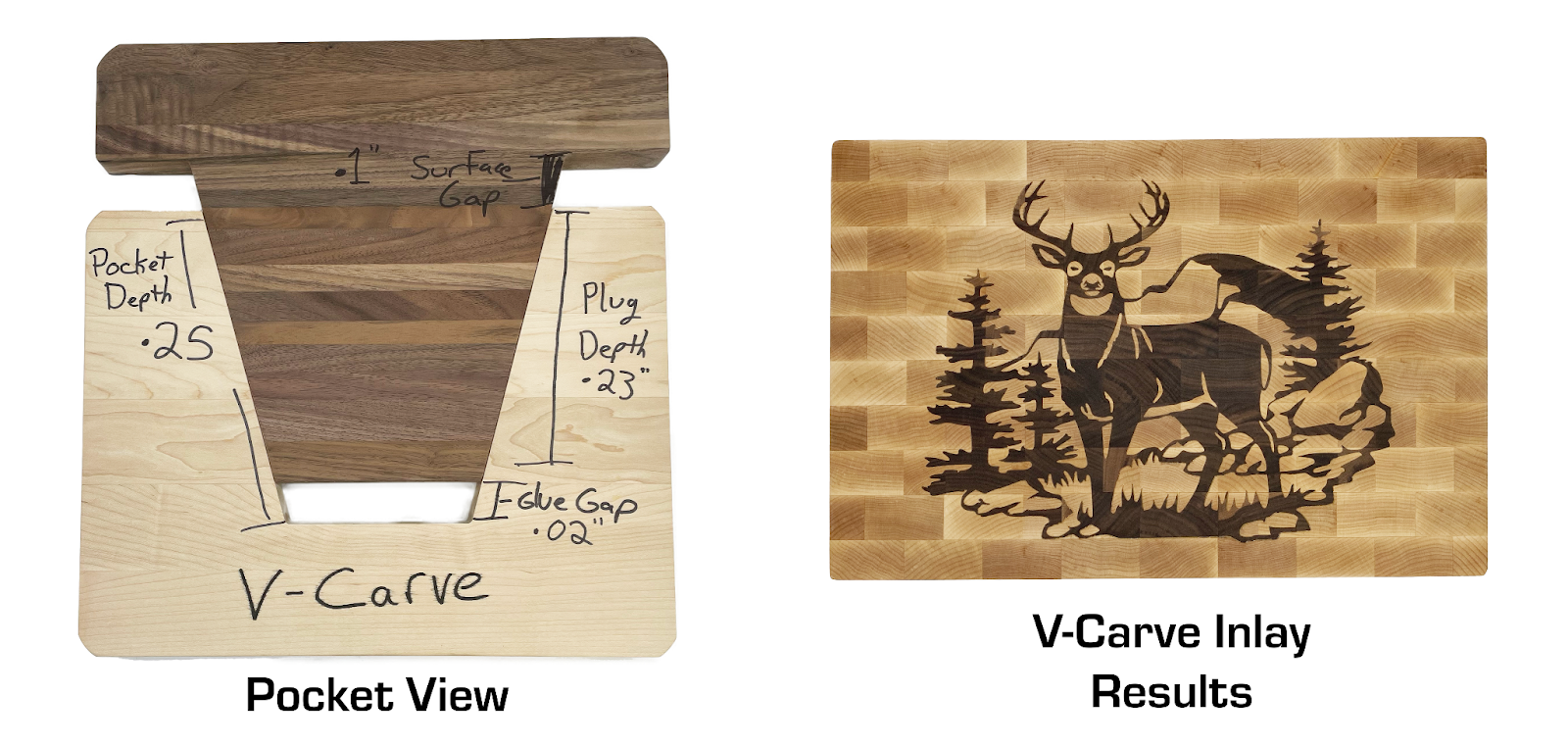

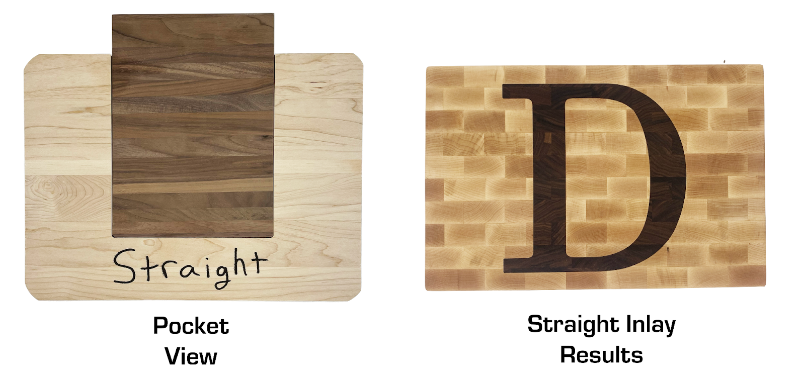

Understanding V-Carve Inlays vs. Straight Flute Inlays
Before diving into the process, it’s essential to understand how V-carve inlays differ from traditional straight flute inlays.
  • Straight Flute Inlays involve pocketing material with a straight bit and inserting another piece of wood into the pocket. However, they limit fine detail work due to the bit’s diameter.
  • V-Carve Inlays, on the other hand, use a V-bit that cuts at varying depths and angles, allowing for intricate designs. The angled cuts form a tight bond between the male and female parts of the inlay, providing a seamless and professional finish.

Step 2: Program the Male Inlay Piece
  • Mirror the Design: To ensure a perfect fit when assembled.
  • Key Parameters:
    • Glue Gap: 0.02 inches (provides tolerance for minor errors and prevents hollow sounds).
    • Plug Depth: 0.23 inches (pocket depth minus glue gap).
    • Surface Gap: 0.1 inches (prevents glue from sticking to the base, making sanding easier).

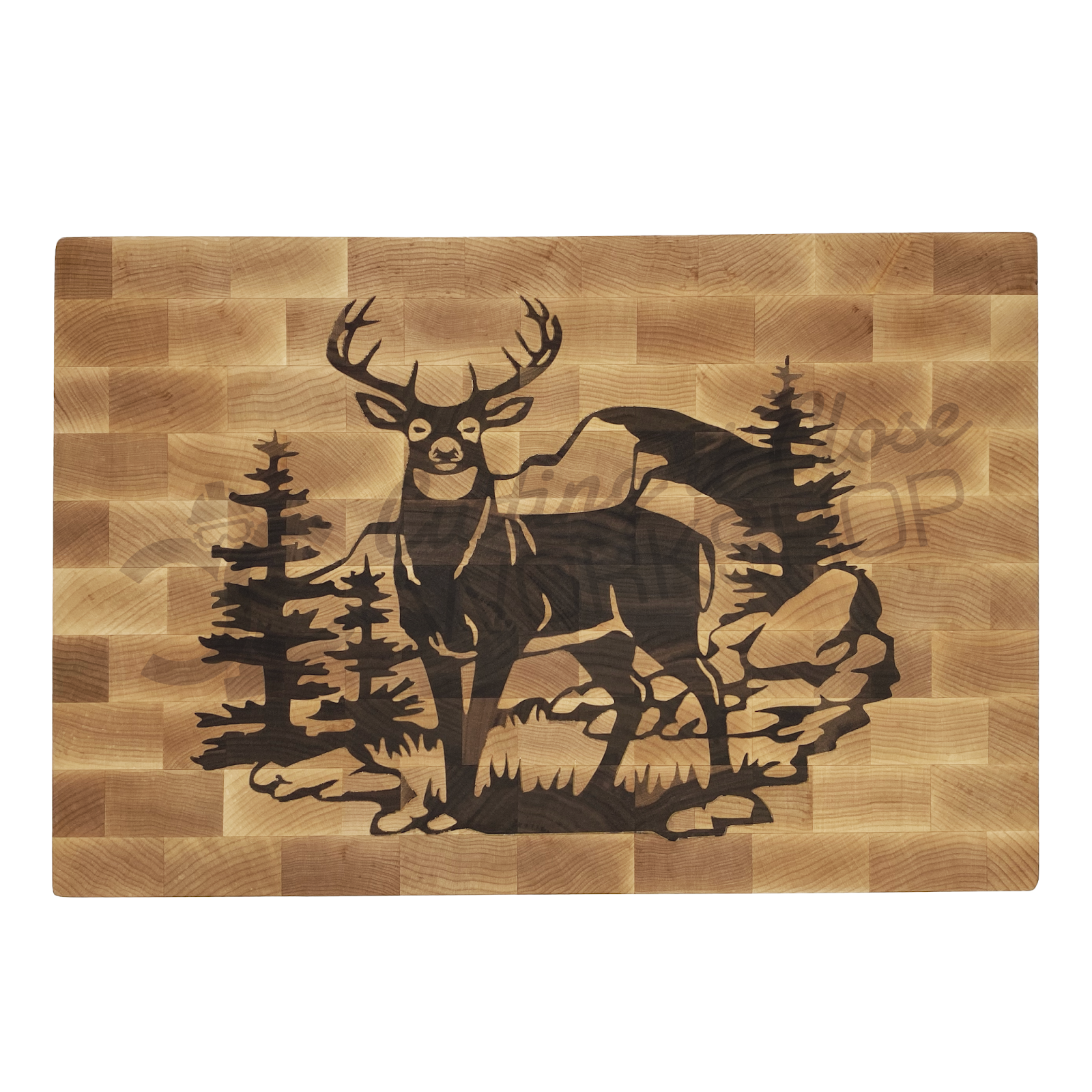

The digital file for the deer scene used in this guide is available for free at cicworkshop.com. Download it and follow the steps outlined here to create your own stunning V-carve inlays.
With the right tools, materials, and this straightforward guide, crafting detailed and professional V-carve inlays is entirely achievable.
