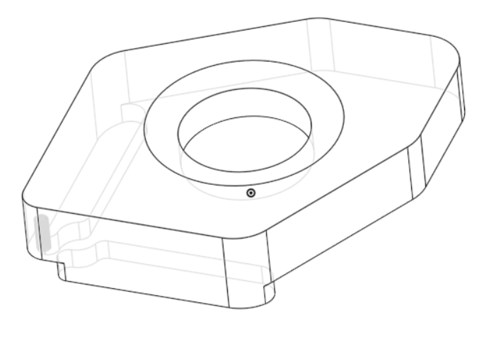

Over 8 different design concepts were created before landing on the current design. Here are a couple examples.
  1. Hole block
    Rough dimensions: 60x60x20mm
    Total weight: 147g
    COM from edge: X & Y= 19.89mm
  2. Leaf plate
    Total weight: 127g
    COM from edge: X & Y= 20.12mm
  3. Hole block
    Rough dimensions: 80x80x20mm
    Total weight: 206g
    COM from edge: X & Y= 28.04mm
