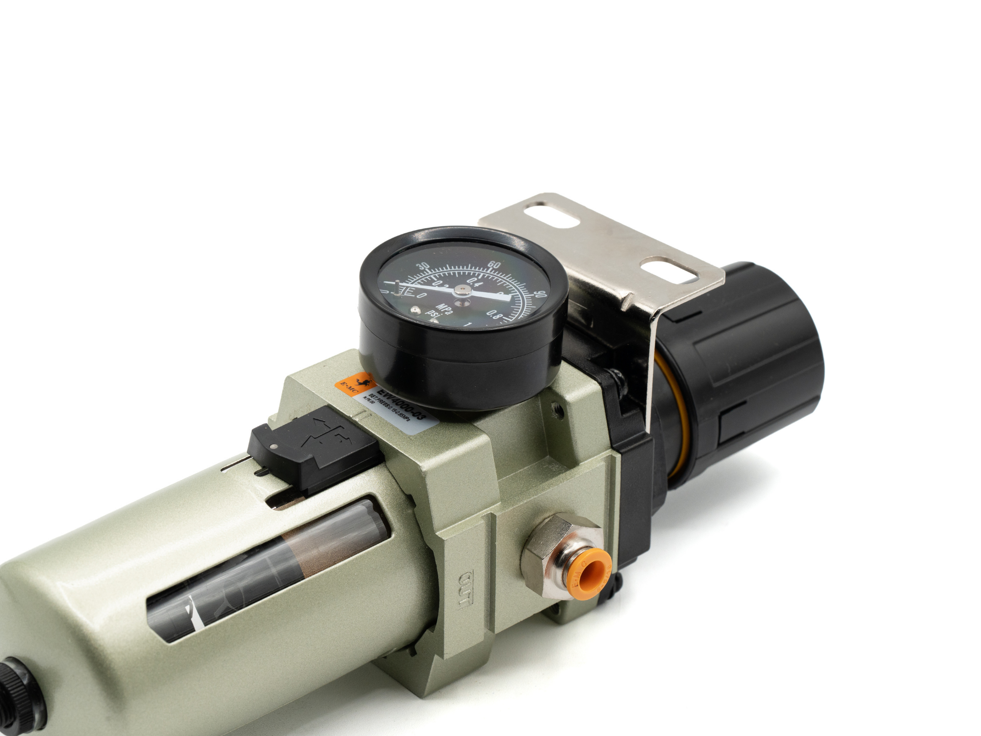

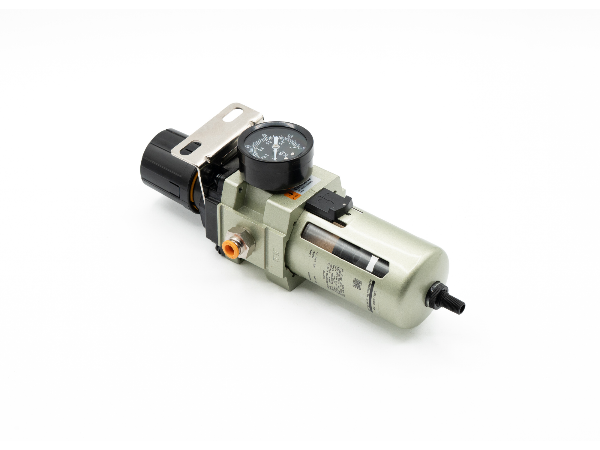

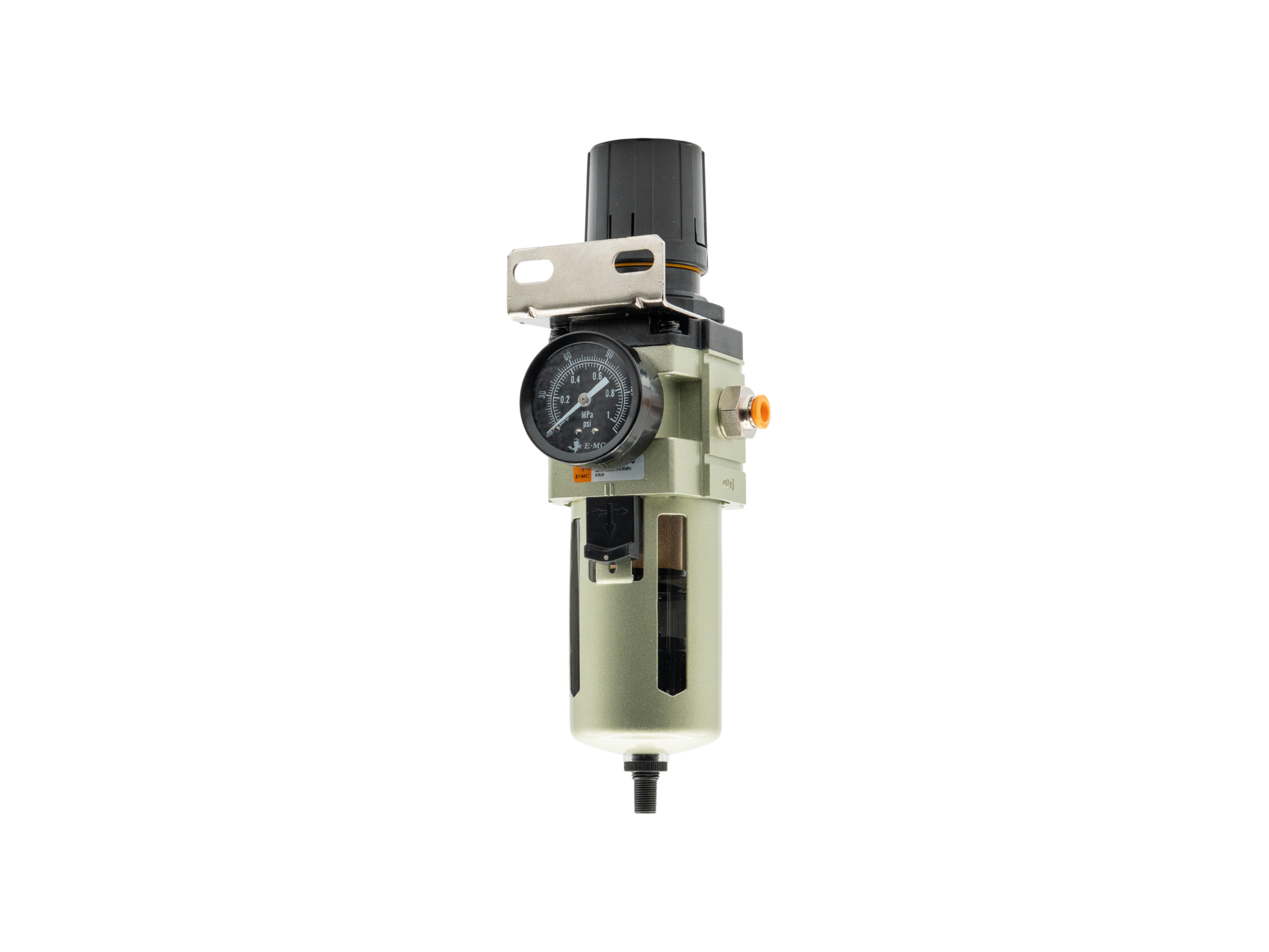

This Air Filter Regulator is recommended to prevent dust, debris and moisture from entering an ATC spindle, and to extend the performance of the spindle.

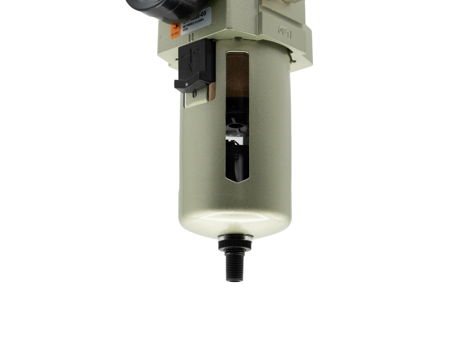

It includes an auto-drain feature for maintenance free operation, plus, the preassembled quick disconnect allows you to connect with most compressors without an additional adapter.
Each order comes with one (1) air filter regulator and one (1) compressor quick disconnect. Tool holders, ATC racks and ATC spindle sold separately.

  • 25 µm filter regulator (coalescing type with auto drain and shut off valve)

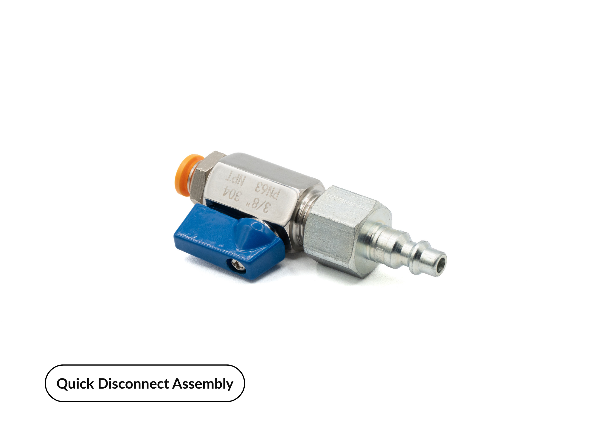

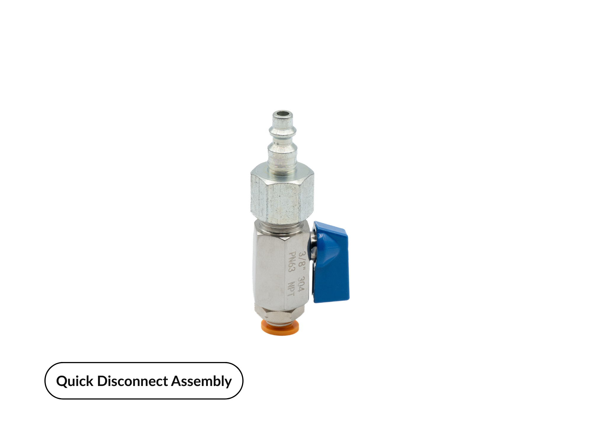

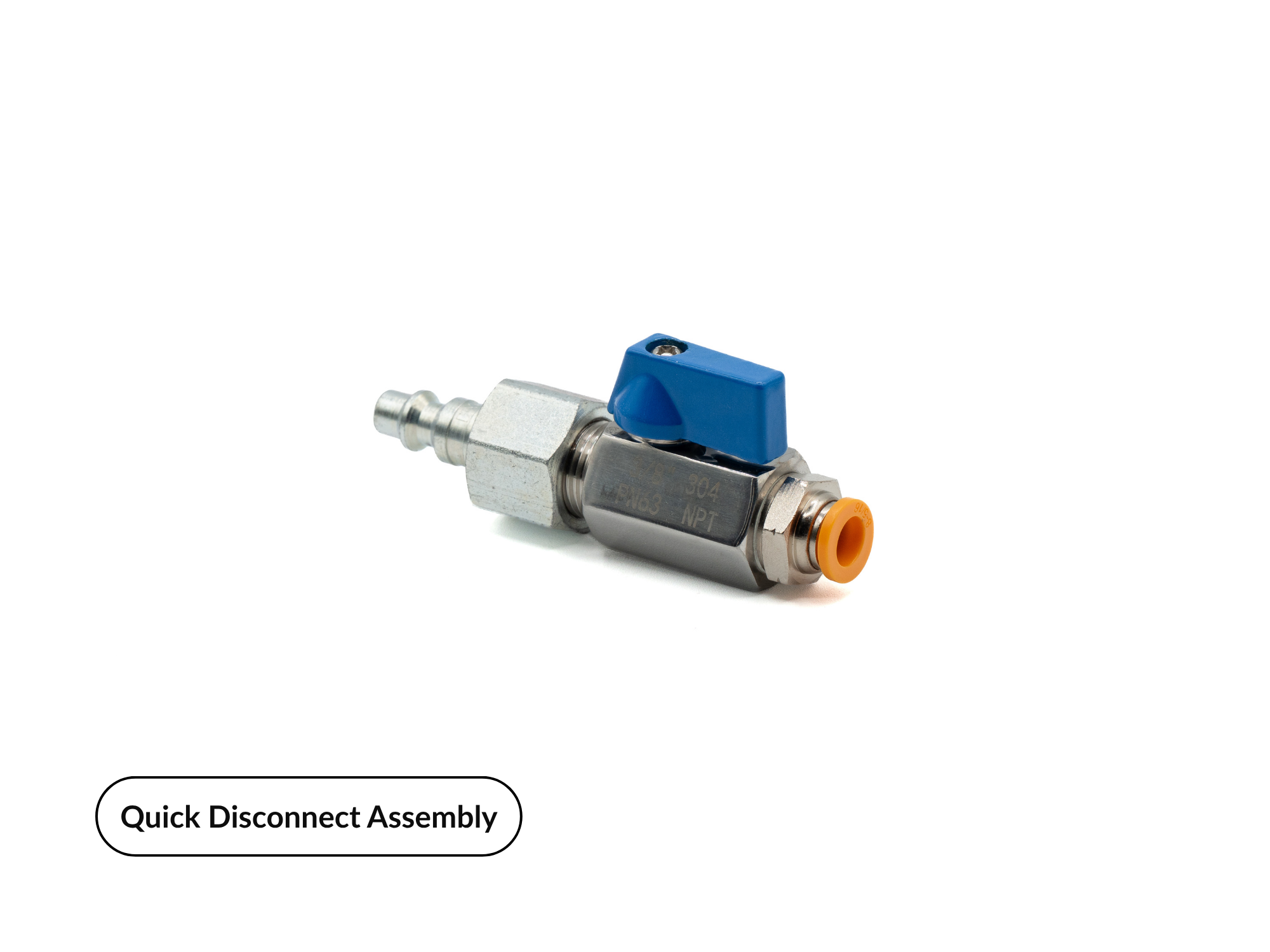

  • Quick disconnect with on/off valve
  • Mounting bracket

Air Filter Regulator Specification
  • Thread: 3/8″ BSPP (Fittings for 8mm | 5/8” tubing comes pre-installed)
  • Rated Flow: 180 SCFM | 5108 L/min
  • Temperature Range: -5~60 ℃ | 23-140 F
  • Proof Pressure: 1.5MPa | 217psi
  • Pressure Adjustment Range: 0.15-0.85 MPa | 25 – 120psi
  • Maximum Working Pressure: 1MPa | 145psi
Quick Disconnect Specification
  • Disconnect Type: Industrial (Milton) Thread: 3/8″ BSPP (Fittings for 8mm | 5/8” tubing comes pre-installed)
Max Working Pressure 145 psi / 10 bar
Pressure Adjustment Range 5 – 130psi / 0.05 – 0.9 bar
Proof Pressure 215 psi / 15 bar
Filter Size 25µm
Drain Function Auto
  • Compressed air should be filtered to 40 µm or better using a coalescing-type filter, unless your air source (compressor) already includes built-in drying and filtration.,
  • For use in high-humidity environments, additional drying equipment is recommended to reduce the risk of corrosion.
