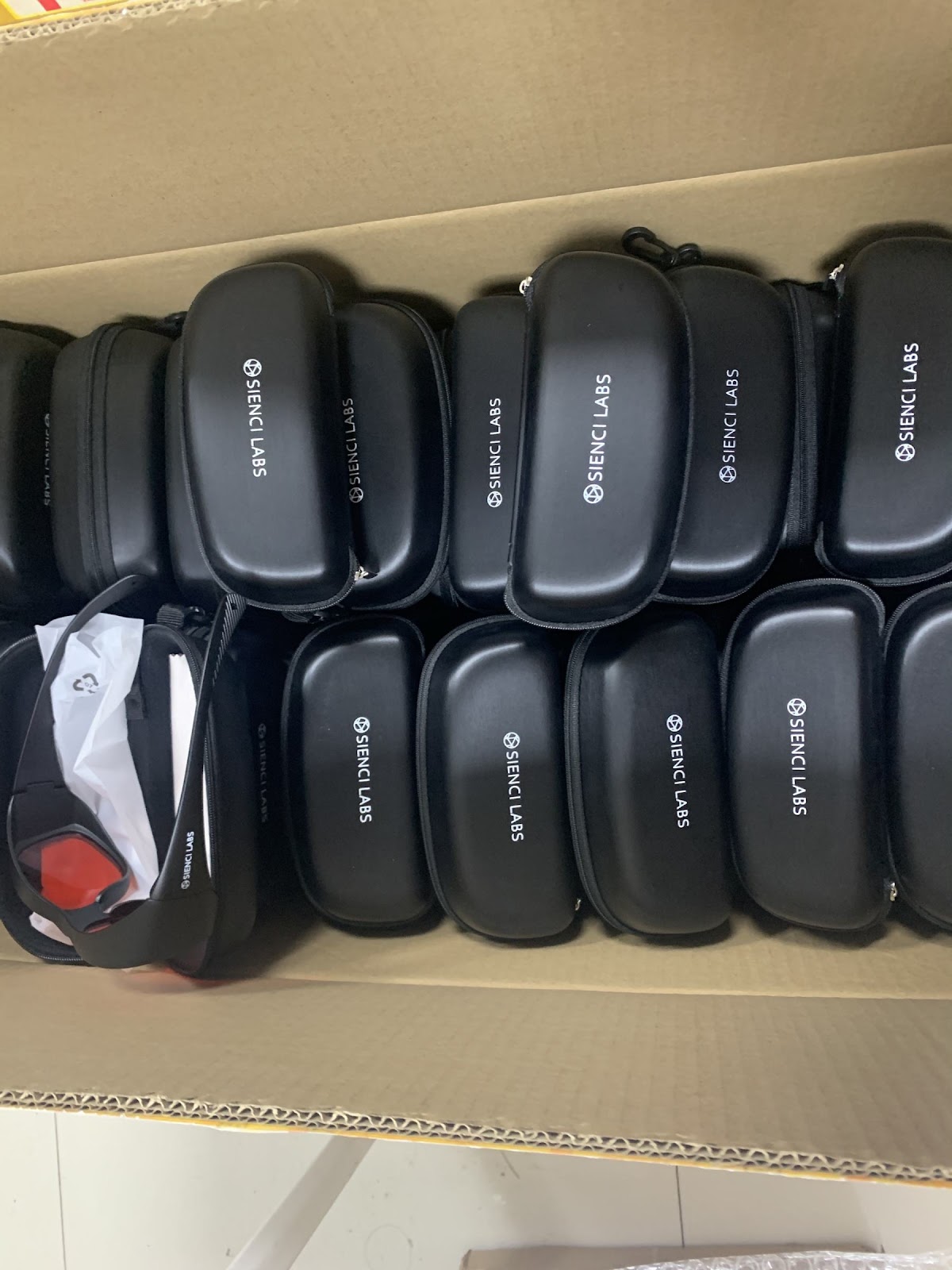

Safety Glasses:
Our safety glasses are ready and being shipped now. I have been using a these exact glasses to run all our LaserBeam testing and can confirm with my own experience as well as laser power testing that these are great safety glasses and your eyes will be well protected.
