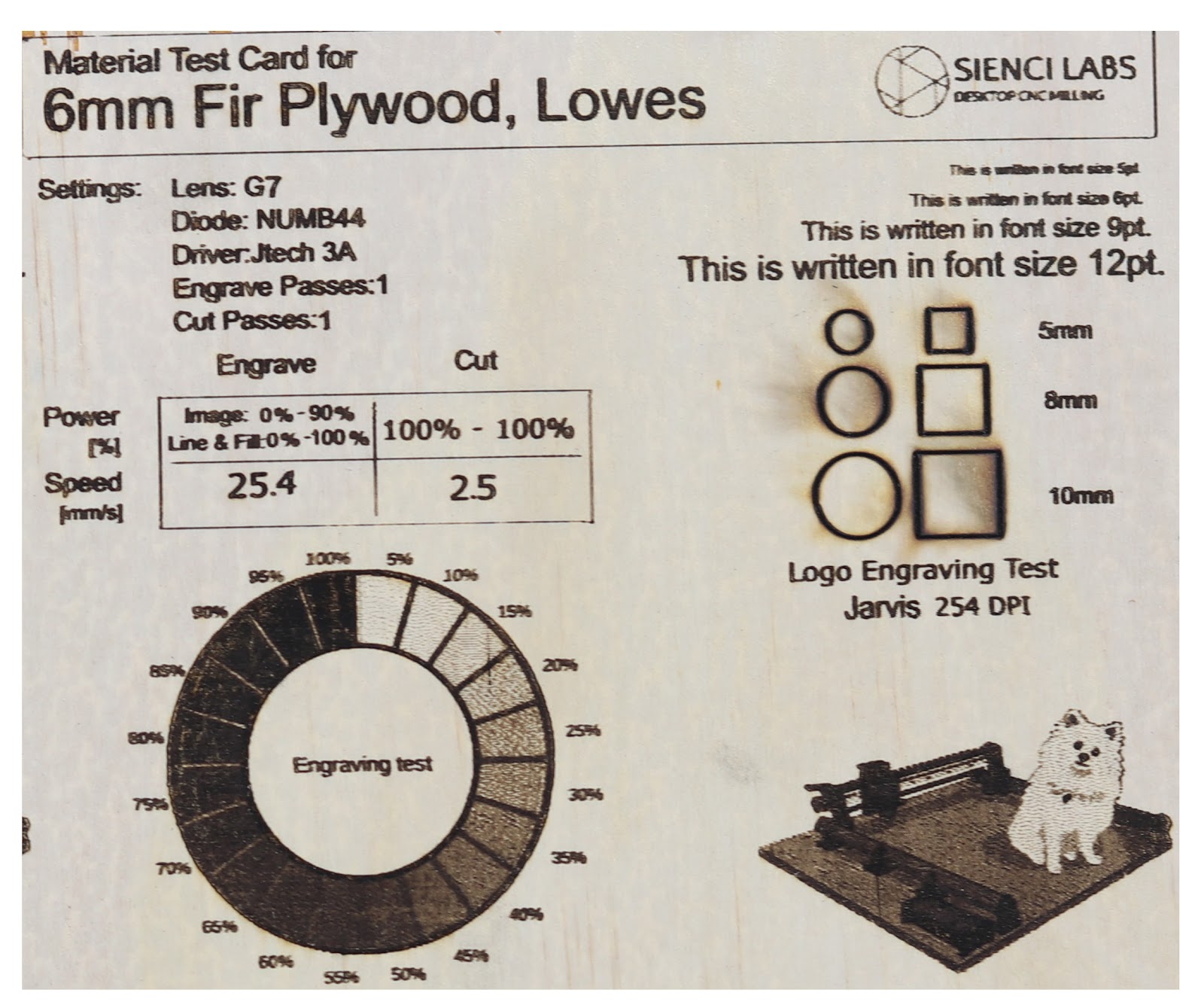

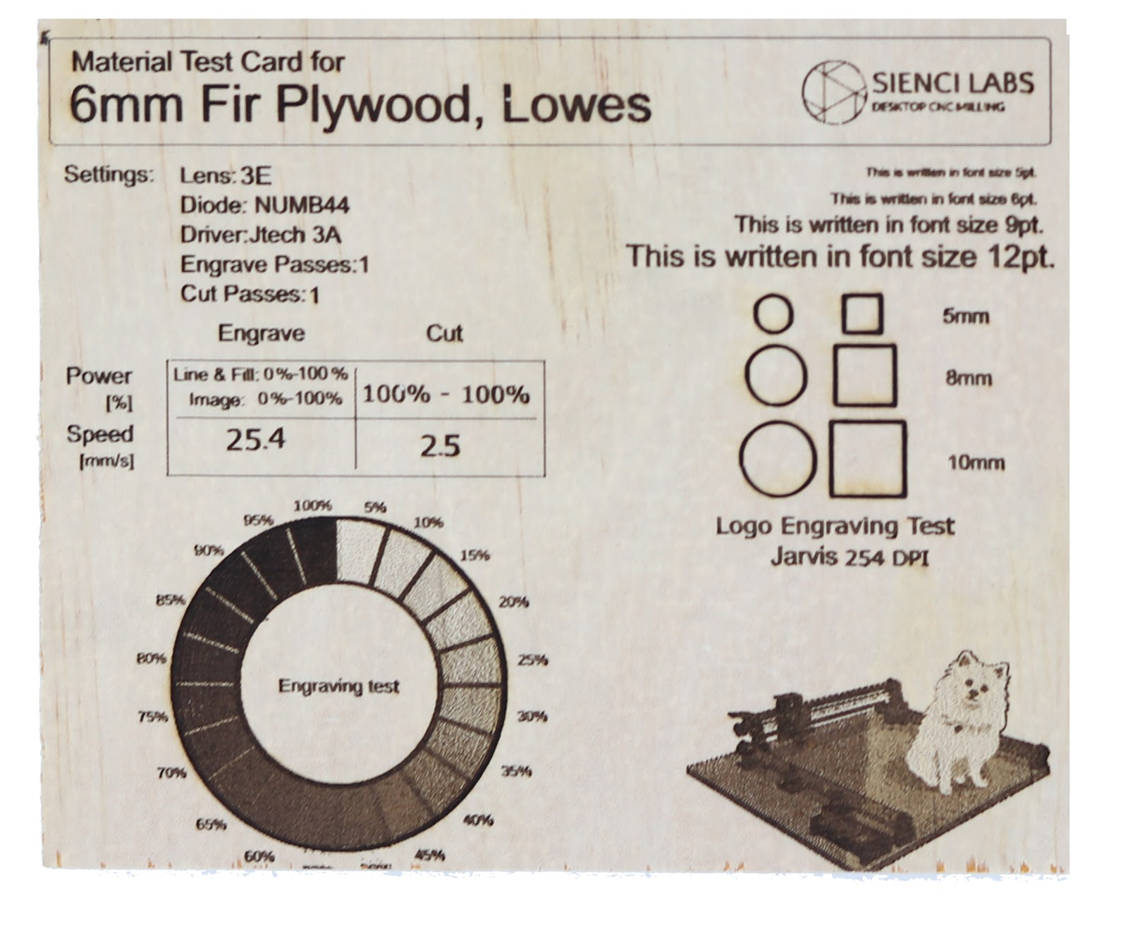

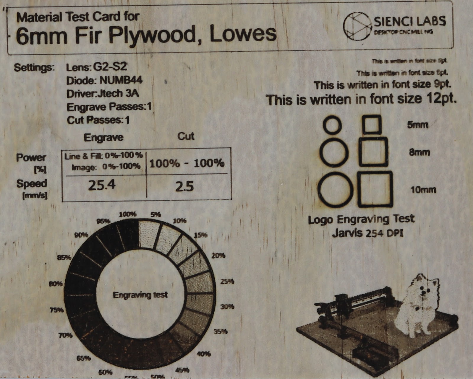

Lens Descriptions
Lens TypeDescription
G2 Lens has the best efficiency (most power) and shortest focal length so it’s great for cutting and good for engraving
3 Element Lens 3 Element has the cleanest beam profile (super detailed text, lines and image engraving)
G7 Lens has a good balance between the power of the G2 and the clean beam profile of the 3 Element.

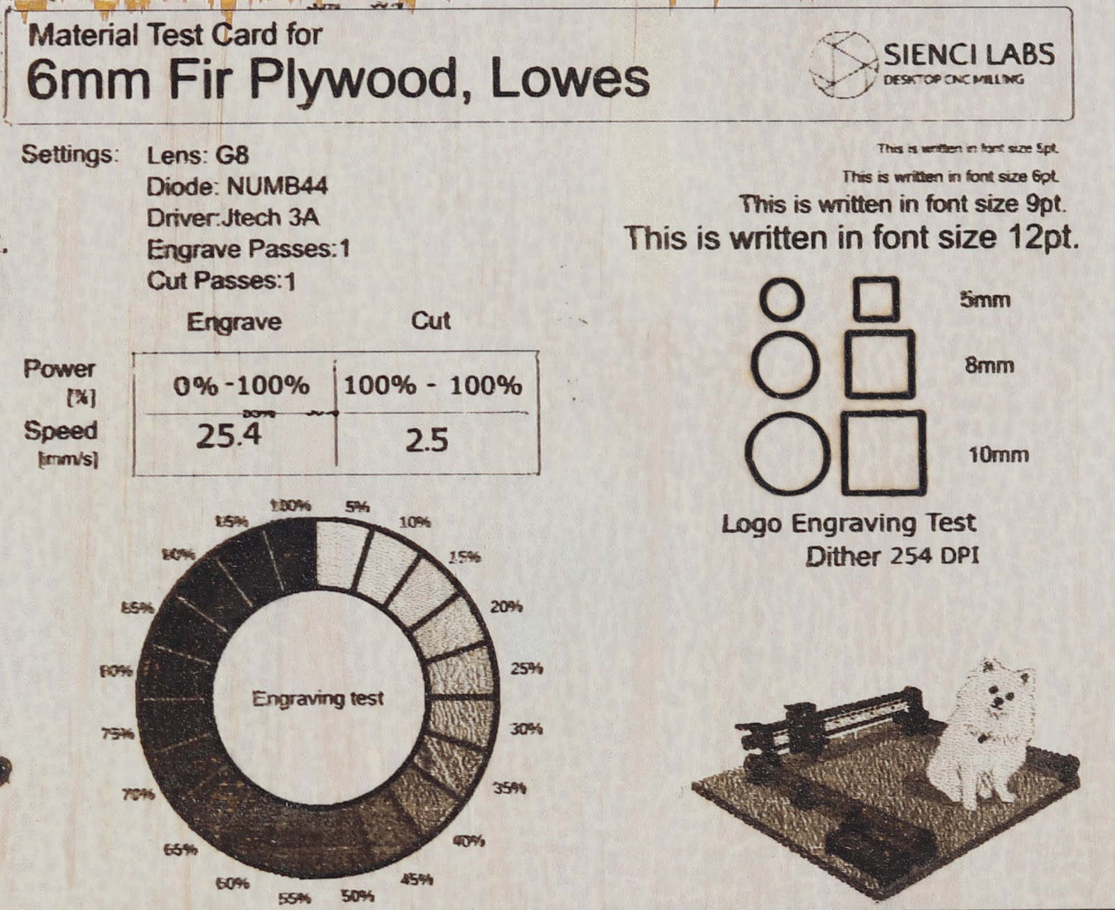

G8 Lensis very similar to the G7 but it has a smaller focus length so you can engrave thicker material than the G8 because you would have more available Z axis travel. I will make a dedicated video for lenses but hopefully that gives you a bit of clarity until then.
Lens Test File
G2 Lens
3 Element Lens:
G7 Lens:
G8 Lens:

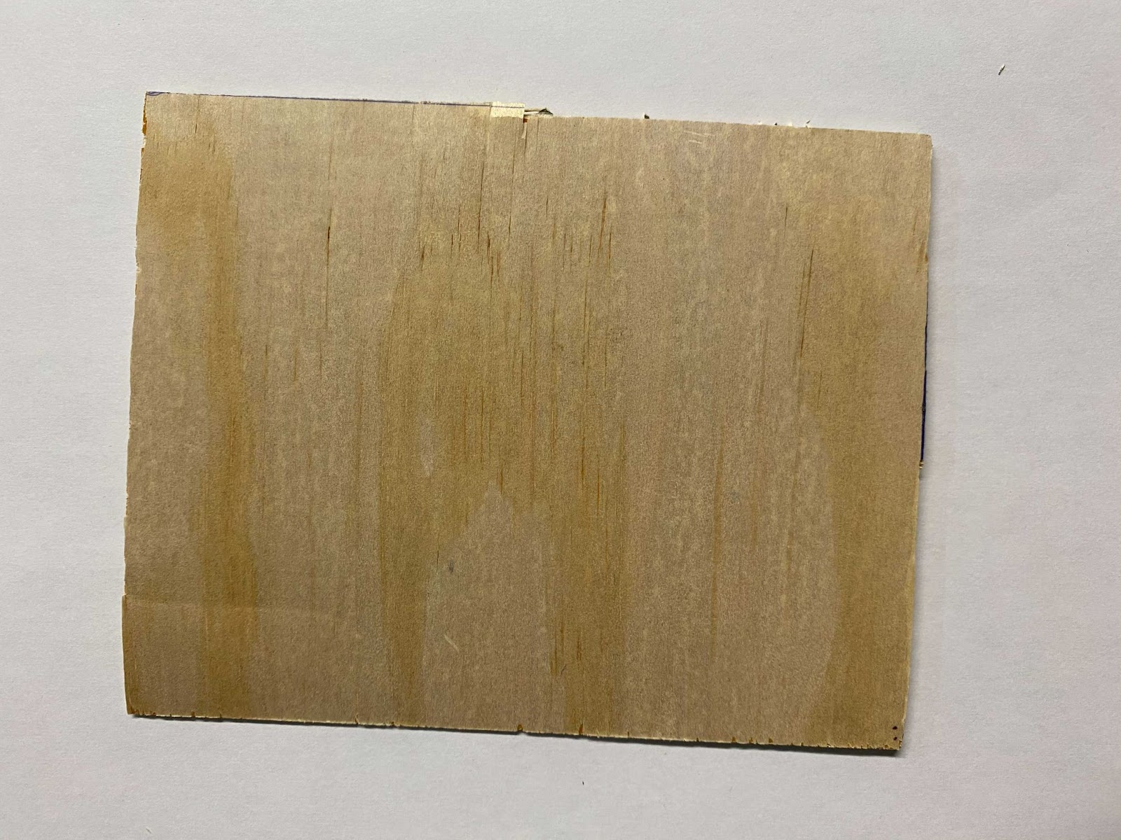

3mm PlywoodLens: G2
Speed: 2.2 mm/s
Power: 100%
Passes: 3
Z step per pass: 1mm
For cleaner finish decrease power and z step per pass, increase speed and number of passes
Lens: G2
Speed :25.4 mm/s
Power:100%
Passes: 1
Decrease speed for deeper and darker engraving

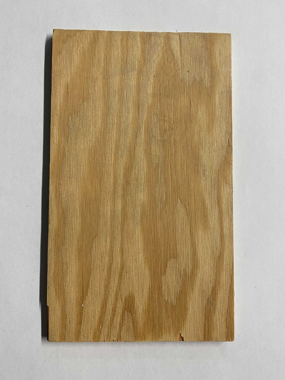

6mm PlywoodLens: G2
Speed: 2.2 mm/s
Power: 100%
Passes: 5
Z step per pass: 1.2mm
Lens: G2
Speed :25.4 mm/s
Power:100%
Passes: 1

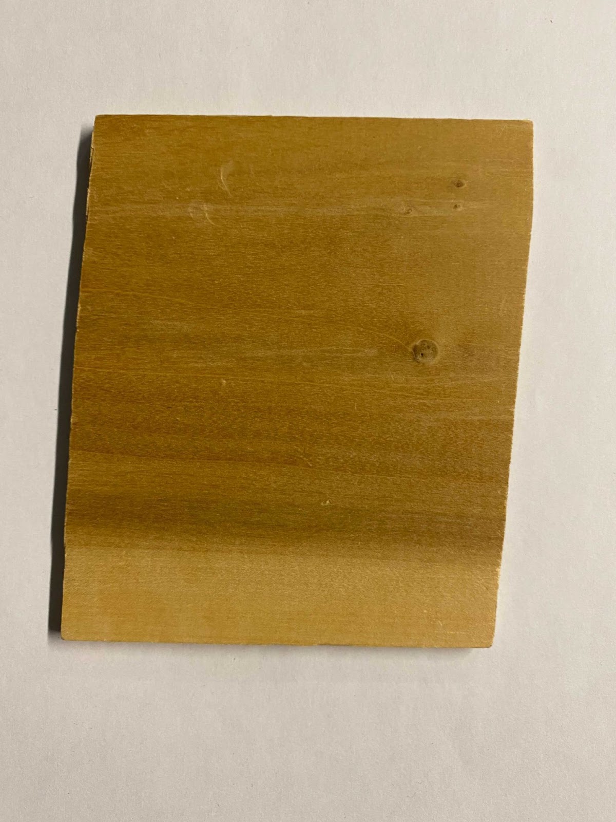

1/4″ PlywoodLens: G2
Speed: 5 mm/s
Power: 100%
Passes: 16
Z step per pass: 0.4mm
Lens: G2
Speed :25.4 mm/s
Power:75%
Passes: 1

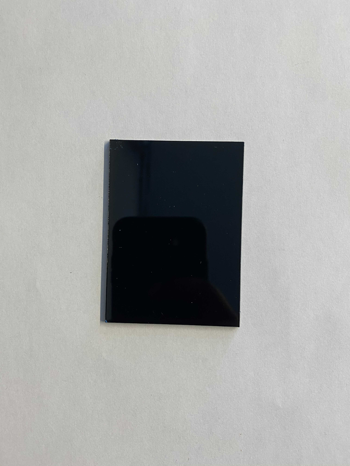

1/8th Acrylic (Opaque) Lens: G2
Speed: 2.2 mm/s
Power: 100%
Passes: 3
Lens: G2
Speed :25.4 mm/s
Power:100%
Passes: 1

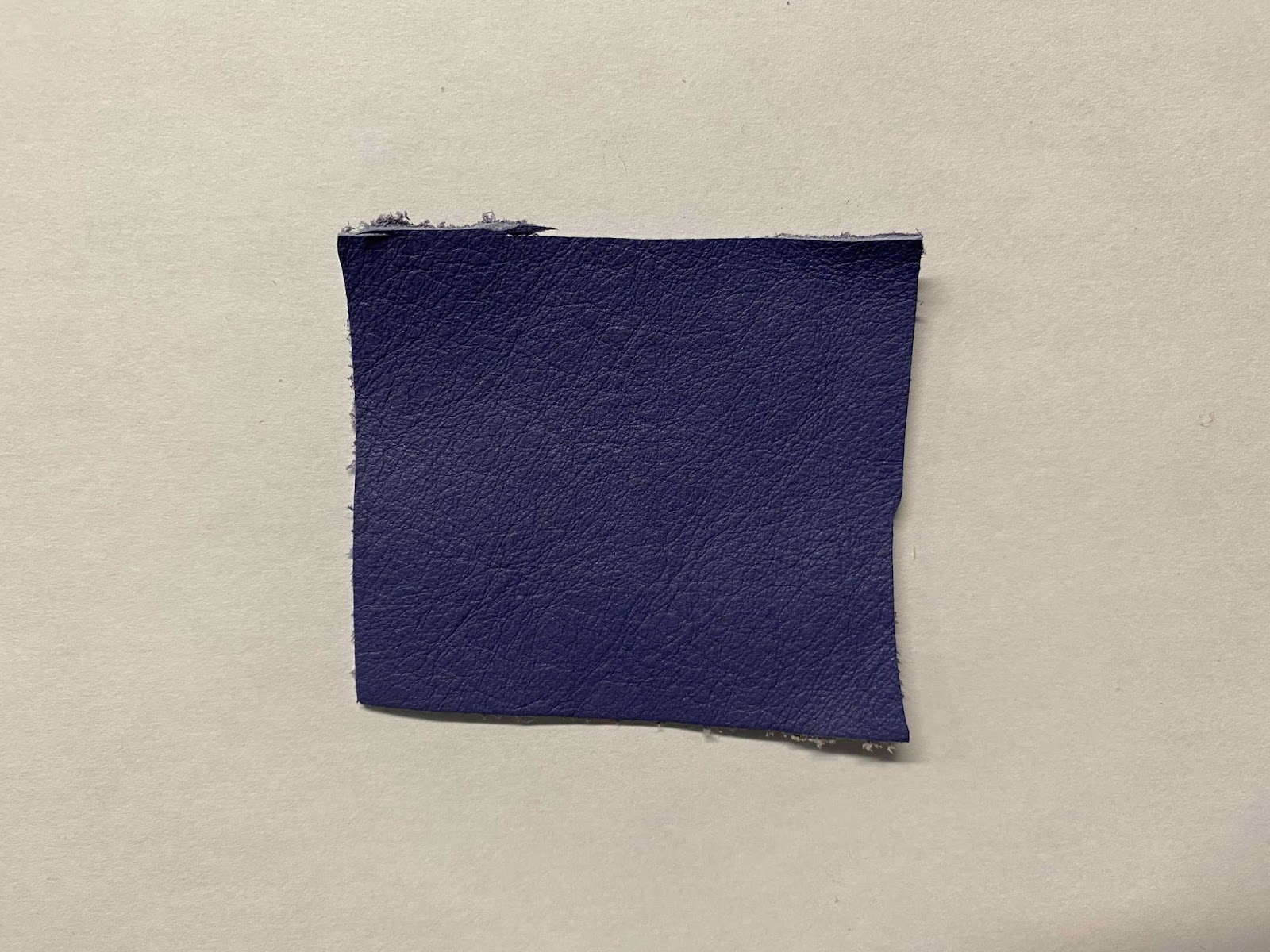

Organic Leather
Organic Leather tends to shrink and deform when cutting is attempted. Although one may be able to cut organic leather. Beware that as the leather shrinks and deforms it can become a fire hazard as the laser is no longer focused.
Lens: G2
Speed :25.4 mm/s
Power:75%
Passes: 1

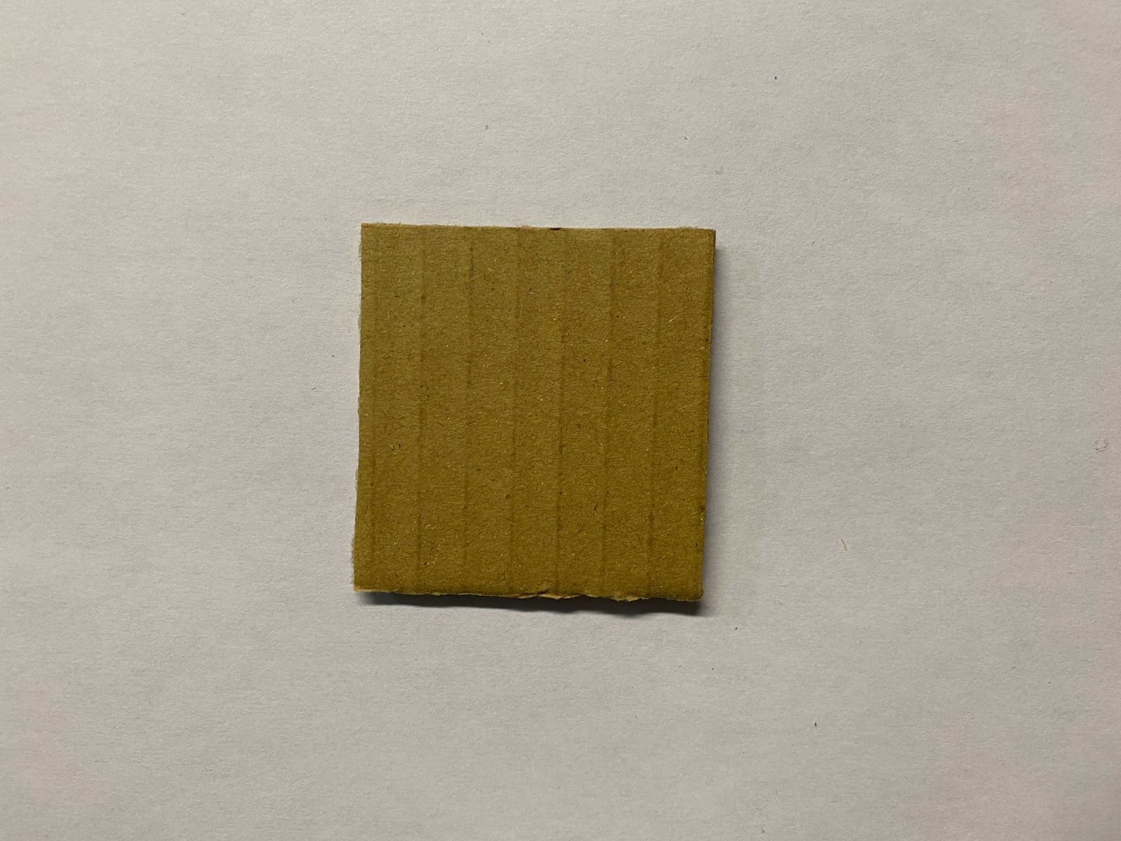

3mm Corrugated cardboardLens: G2
Speed: 5 mm/s
Power: 75%
Passes: 2
Z step per pass: 1.5mm
Lens: G2
Speed :25.4 mm/s
Power:75%
Passes: 1
