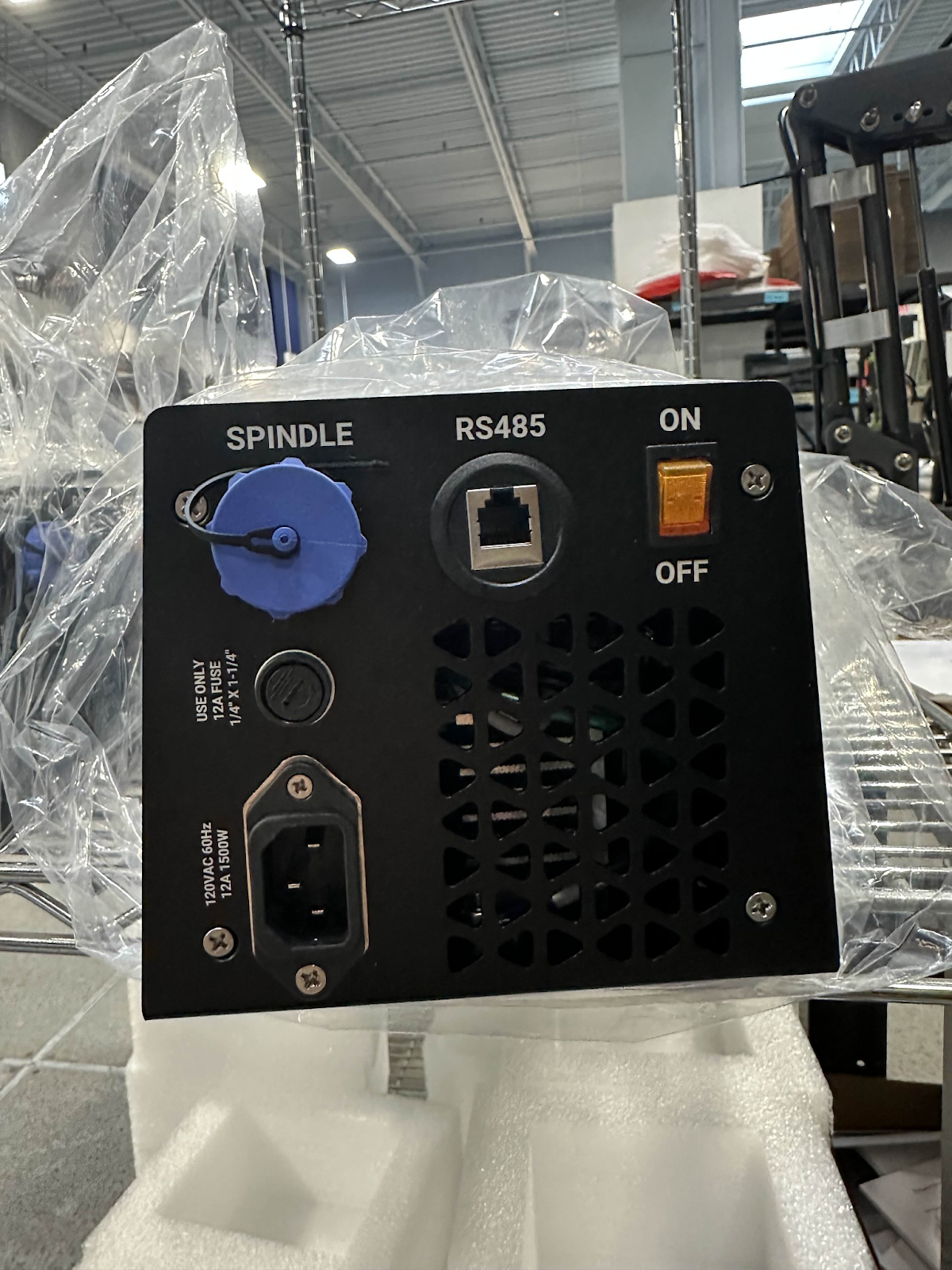

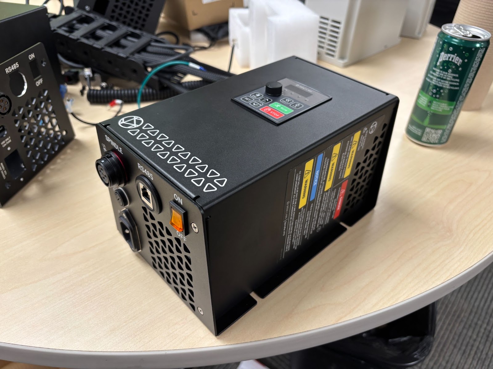

The new VFD comes with several changes considering improved safety and ease of use.
Ease of use improvements:
- Pluggable spindle cable: the cable for the spindle is no longer wired in with a screw terminal but instead uses a plug on each end allowing for the user to easily connect and disconnect the cable without tools
- Pluggable AC cable: like the spindle cable, rather than needing to use a screw terminal for the plug, the NEMA 5-15P style cables. Note that this cable must be rated for 15A (these are provided in the kit)
- Pluggable RJ12 connector for controlling the spindle via RS485
- Fuse is easily accessible and swappable
- Switch allows for user to easily turn on and off their VFD

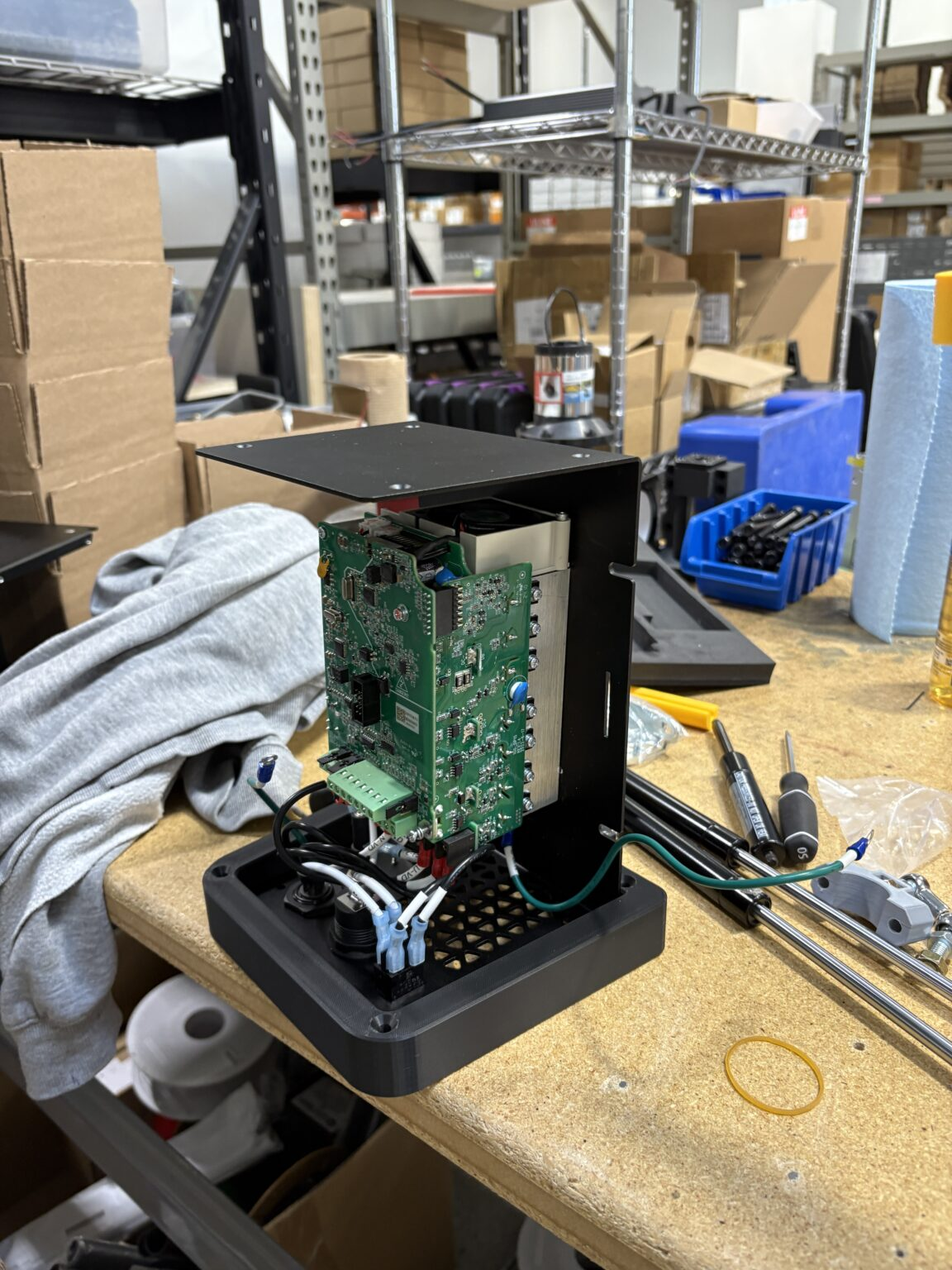

Safety related changes:
- Components are tested for fire resistance, and all bear appropriate UL/CSA safety markings
- Enclosure designed to prevent shock, with proper spacing and mechanical strength to prevent shorting
- Proper safety warnings and stickers

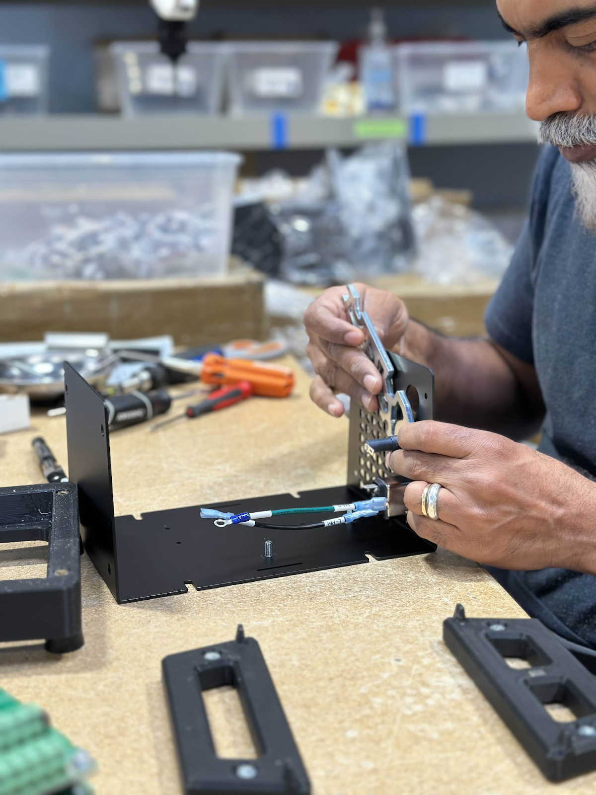

We’re currently assembling the first 100 units for the 110V 1.5KW, some which will go to the initial customers, and the remainder will be available to Canadian customers once the batch is complete.

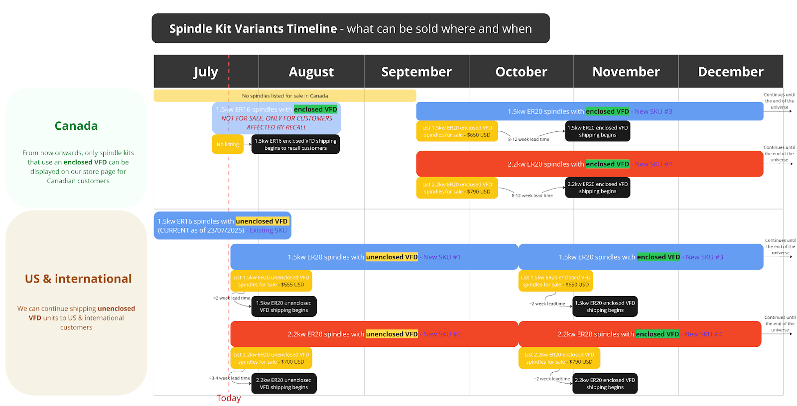

Pricing
Here’s a timeline and estimated sale price for each variant. Please note these are estimates only and may change – watch for emails and social posts for formal announcements over the next few weeks
Enclosed VFD refer to the certified versions
Unenclosed VFD refer to H100/uncertified VFDs
1.5kW ER20 with unenclosed VFD – $555 USD
2.2kW ER20 with unenclosed VFD – $700 USD
1.5kW ER20 with enclosed VFD – $650 USD
2.2kW ER20 with enclosed VFD – $790 USD
