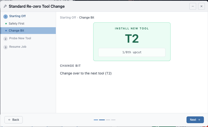

- Numerous visual and workflow improvements to the tool change wizard
- Tool change wizard will now resume the spindle before returning to the previous XY position.

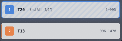

- Tool change wizard and tool timeline now display annotation comments when no ATC nickname is set

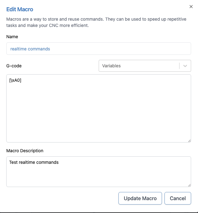

- Macros can now send realtime commands using the [\xNN] format
