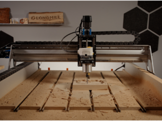

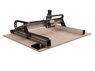

The LongMill MK3 is an easy-to-use, budget friendly CNC to get your imagination carving on day one. Built with hobbyists and new comers in mind, this turnkey, benchtop CNC system is reliable and powerful, and capable of cutting up to 275 inches per minute.
The 30×30 machine has a 4.6″ z-axis cutting depth, 32″ x-axis cutting width, and 32″ y-axis carving length. It can handle materials ranging from softwoods to hardwoods, plastics and foams, to acrylics and even aluminum. It runs on a closed-loop stepper motor system, and comes equipped with a grblHAL-based CNC controller. Its linear rail system allows for production-level performance not found in similar hobby-level machines.
The LongMill MK3 represents the best entry-level hobby CNC in terms of performance, design and customer support. It’s the fastest, most rigid CNC machine in its size and price category, and comes pre-assembled so you can be up and running within two hours, right out of the box.*
Router and other accessories sold separately. A LongMill MK3 Beginner’s Kit with all necessary start up items is available.
Lead Time: 6 weeks
54 in stock
Description
Highlights:
  • Pre-assembled for a quick, plug and play set up in just under two hours*
  • Accessible, capable and affordable
  • Ideal for hobbyists and entry level consumers

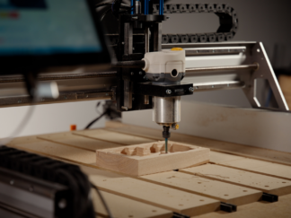

  • Cuts materials ranging from softwoods to hardwoods, plastics to foams, and acrylics to even aluminum
  • Closed-loop stepper motor system (detects when it loses steps)
  • Advanced, production-style features including y-axis auto-squaring and limit switches by default
  • Lead-screw and linear guide rail motion system with anti-backlash nuts for precision
  • Table mounted, flexible for any setup
  • Industry leading hobby-level cutting speeds of 275 inches per minute
  • Z-axis maximum travel: 5.1”
  • Z-axis clearance: 4.6″
  • 32″ cutting width on the x-axis
  • 32″ cutting length on the y-axis
*A two hour set up is an estimate only, based on internal testing and expected assembly of pre-assembled parts.

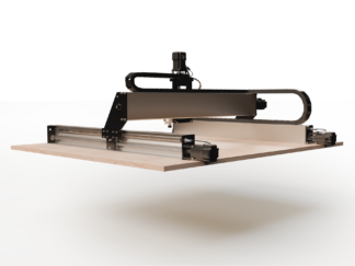

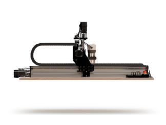

  • 30×30 Machine Specs Diagram
  • Footprint: Approx. 40″ x 45″ x 20″ including motor space / 1016mm x 1143mm x 508mm
  • X- & Y-Axis Working Area: 32” x 32″
  • Z-Axis Maximum Travel: 5.1”
  • Z-Axis Clearance: 4.6″
  • Motion System: T12 Lead screws on all X, Y, Z axes
  • Linear Motion: 15mm profiled linear guide rails and bearing blocks on all axes
  • Drive Motors: High-torque NEMA 23 closed-Loop stepper motors; 1.2 Nm on all axes
  • Control System: SLB-LITE controller with grblHAL firmware
  • Power Supply: 24V DC, Class 2 Certified
  • Weight: Approx. 72lbs when assembled
  • Spindle Mount: Supports both 65mm routers and 80mm spindles*
*When using an 80mm spindle and a dust shoe, cutting area will be reduced.

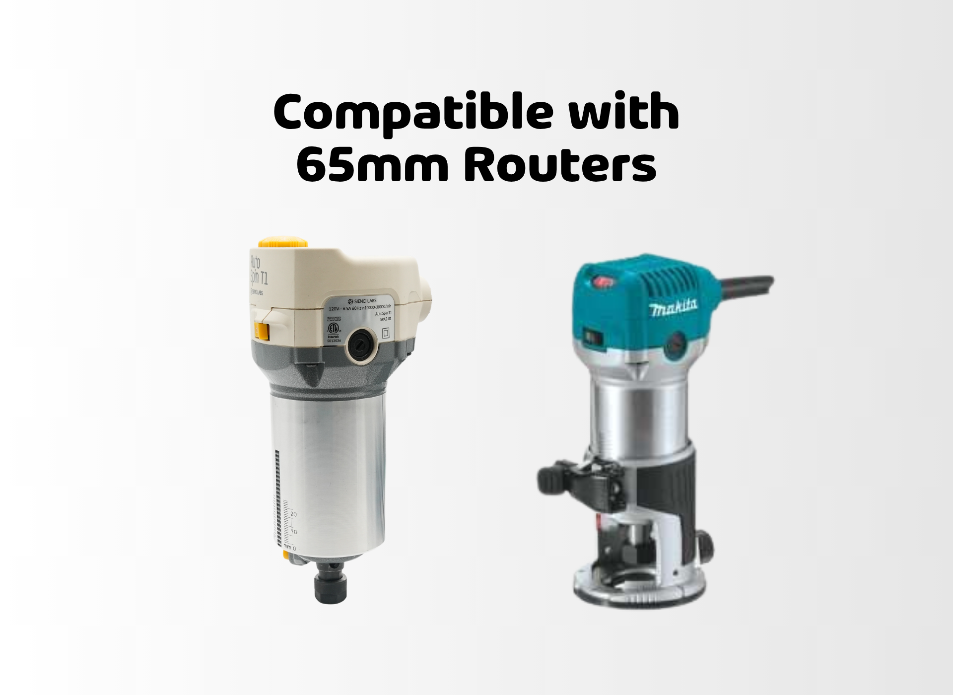

What spindles or routers can I use?
While we recommend our AutoSpin T1, you can also use other 65mm trim/palm style routers. Your LongMill MK3 comes with a standard 65mm mount. You can also use our 1.5KW spindle but its current dust shoe is large and will reduce the cutting area.
Is the LongMill MK3 compatible with the Makita RT0701?
Yes it is, and all LongMill MK3s will come with a 65mm mount. Please note that you may need to use an extension cable for the Makita RT0701 to pass through the drag chains.

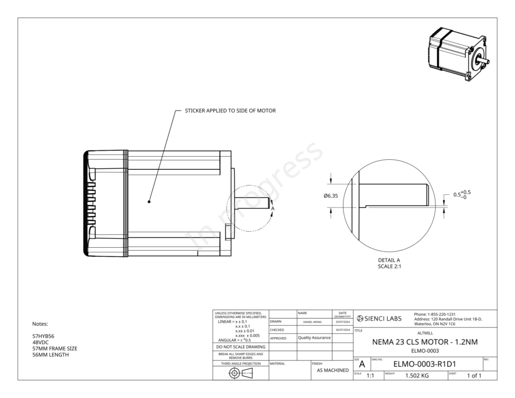

What are the motor specifications?
The LongMill MK3 uses 1.2NM NEMA 23 closed-loop motors. See details and drawing below.
  • Motor frame size: NEMA 23
  • Motor torque: 1.2NM
  • Voltage: 24-48VDCNEMA 23 Motor Schematic

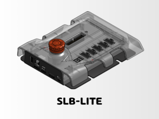

What controller does the MK3 come with?
The LongMill MK3 comes with the SLB-LITE, a newly redesigned version of our original SLB. It uses a 24V power supply, and can support motors (open and closed-loop) with external drivers.

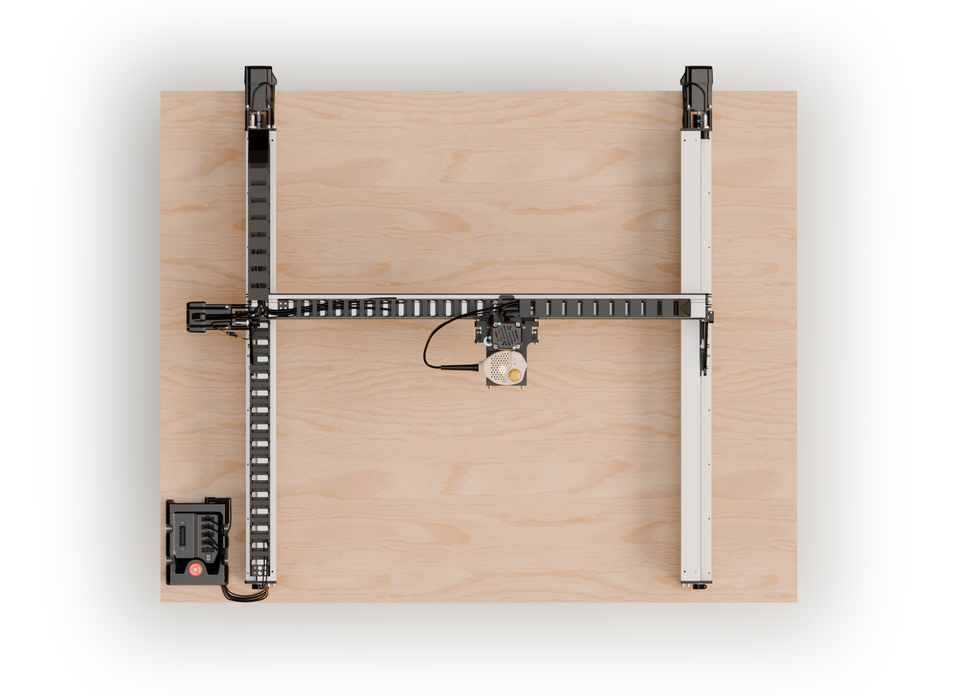

Can you tile/pass sheets through the back of the machine?
Definitely. Just like all our machines, the rear of the LongMill MK3 is open and you can pass larger sheets through the machine. It should be noted that you may need to position or route the Y motor cable in a way to prevent interference with material if you do choose to do tiling.

Is the SLB-LITE controller available for purchase as a solo item?
As of May 2026, it is not available as a solo item for purchase. It is expected to be available as a solo item once we begin shipping machines in the fall of 2026.
