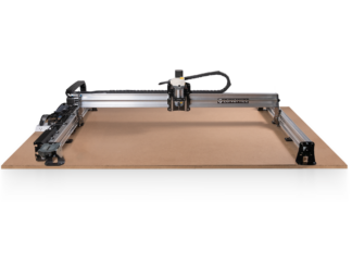

Introducing LongMill MK2 Beginners Kit
The LongMill MK2 Beginner’s Kit is a, “everything you need to get started with CNCing” package. This package comes with the LongMill MK2 CNC machine and basic accessories that the large majority of users order. Not only does this help new users get everything they need to start, but also reduces lead times as it allows us to make pre-assembled kits in stock.
What is the LongMill MK2 Beginners Kit?
We created the LongMill Beginner’s Kit based on sales data for items that customers buy with their LongMill, as well as feedback from our customer service team on items we felt were most beneficial for customers to have when opening their boxes.
The Beginner Kit comes fully loaded with:
1 x LongMill Benchtop CNC MK2 – choose between 30×30 or 48×30
1 x AutoZero Touch Plate
1 x Starter End Mill Set
1 x LongMill MK2 Magnetic Dust Shoe
1 x Makita RT0701C Router
It should be noted that all of the items can be purchased separately, customers who wish to pick and choose what they get with their order can still do so through our Store.
It’s also important for us to mention that there are also certain items that we feel like although a lot of people buy them, they are either not needed for beginners or don’t bring a lot of value.
For example, let’s take the MK2 Lead Screw Dust Shield. For regular use, they are not needed at all. Since the lead screws and nuts on the LongMill are designed to be used in dusty environments, they do not need to be covered. In fact, they can be inconvenient in ways as they need to be removed every time the nuts have to be adjusted.
The other big omission folks might notice is the Inductive Sensor Kit for the LongMill MK2. This is because we believe that most beginners will find them unnecessary, and due to the complexity of setting them up, we find a lot of customers have issues due to improper setup and settings. Additionally, since crashing the LongMill won’t damage the machine, using limit sensors are not needed for limiting travel. All in all, we feel that for most people, they will be more trouble than they are worth. We recommend adding them once customers are familiar with using their machine and are ready to take the next step in doing more advanced work.
You might also have noticed that the 1/8″ Precision Collet for the Makita RT0701 also isn’t included in the list. That’s because the Starter End Mill Set comes with a 1/4″ to 1/8″ Collet Adapter included.
The items in the Beginner’s Package are there because we think they are the products we think you should get to have the best experience as a beginner. We don’t want to sell you stuff you probably won’t need, especially when starting out. However, if you want those items, feel free to add them to your cart, we won’t stop you!
