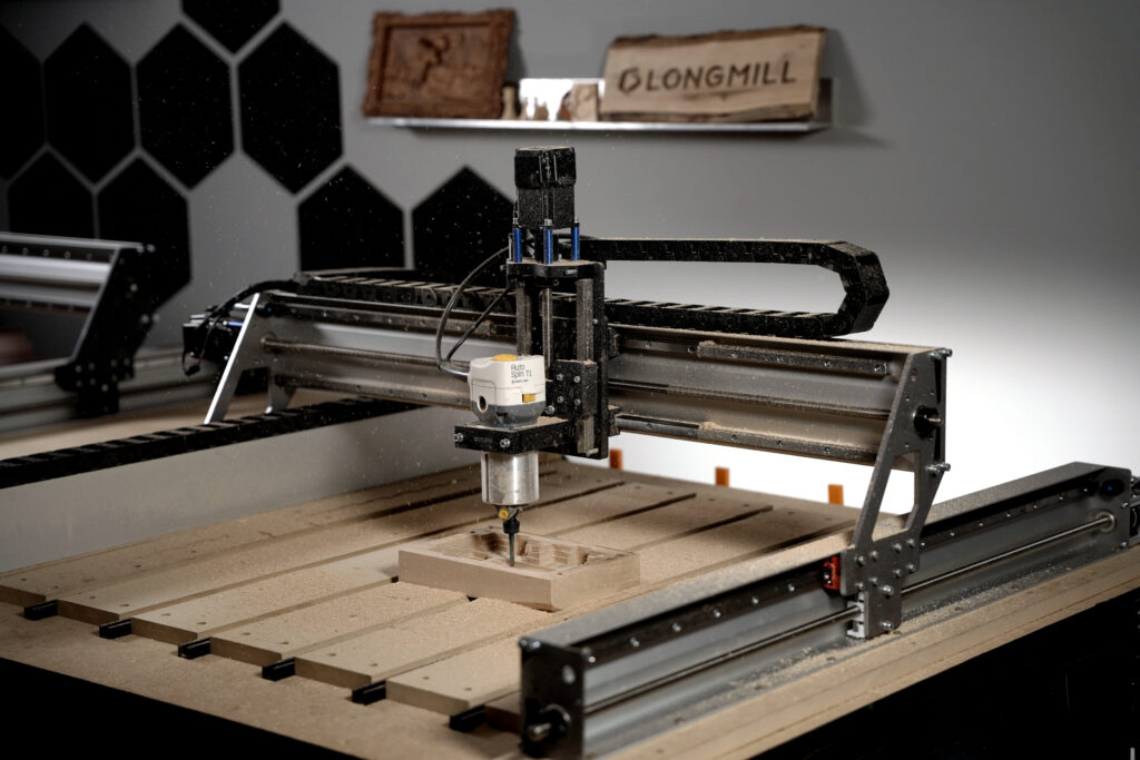

Everything You Need to Know About the LongMill MK3
The LongMill MK3 is the successor to our past line of LongMills. Like the original LongMill, its aim is to provide a beginner friendly experience to people who are looking to get into CNCing, while providing enough power and performance to be a productive machine. The LongMill MK3 was designed to address several of the LongMill’s weak points, integrate new technologies, optimize manufacturability and ease of assembly.
To speak frankly, we designed and we believe that the LongMill MK3 lineup represents the best entry level hobby CNC under $2000USD in terms of performance, design and customer support. We are excited to launch the LongMill MK3, as it represents a huge step forward in the hobby CNC field industry.

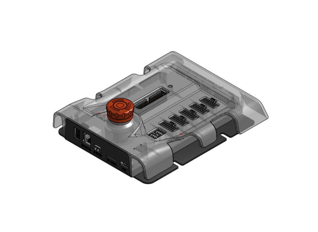

SLB-LITE 3D Render - Thumbnail
SLB-LITE 3D Drawing - & Ports Cables

Performance Differences
With the conjunction of closed-loop steppers and thicker lead screws, we are able to push the rapid speeds of the LongMill MK3 to almost double the speeds of the MK2.
LongMill MK2
  • X and Y default max rapid speeds = 4000mm/min, 157IPM
  • Z default max rapid speed = 3000mm/min
LongMill MK3
  • X and Y default max rapid speeds = 7000mm/min, 275IPM
  • Z default max rapid speed = 6000mm/min, 236IPM
Rigidity
The performance of any CNC machine depends a lot on the overall rigidity. Based on our testing, we are able to see between 60 to 80% improvement in overall rigidity of the machine. This means that not only can the machine move faster, it can handle the extra power. In practice, this means shorter cutting times, cleaner results, and more reliability overall.
Comparison at 25N/5.62lbs
Positive X (thou)Positive Y (thou)
LongMill MK2 48×30 (extrapolated)710
LongMill MK3 48×304.58
Difference (thou)2.52
Difference (%)64.29%80.00%
Comparison at 50N/11.24lbs
LongMill MK2 48×3014.220.7
LongMill MK3 48×301011
Difference (thou)4.29.7
Difference (%)70.42%64.29%

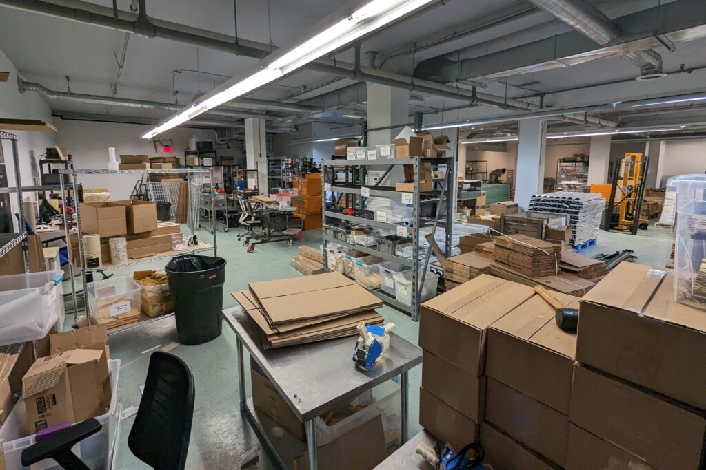

Back in the March 2026 Production Update, we mentioned that we added about 2500sqft of production space to our shop. I’m excited to announce that our office expanded again this month by another 3500sqft. This includes around 2100sqft downstairs, which used to be a large boardroom to be turned into media space, where we’ll use as a dedicated filming space for the marketing team. We’re also looking to potentially host classes and events there down the line as well.
The upstairs ~1400sqft is expected to be used primarily as desk space, with some focus for the customer service team, as the space has a couple of enclosed offices, which should allow them to make and take calls in a quieter environment.

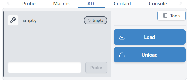

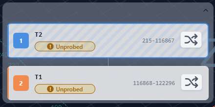

ATC Now Shipping
Extra exciting news is that the ATC is now shipping as well since April 16th! Again, a huge accomplishment for all of the teams at Sienci Labs for pulling off what is probably our most complicated project to date.
Our first batch of ATCs have sold out, and we are now in production for another batch. We are expecting orders for ATC placed today to start shipping in June. We are nearly sold out on our second batch of ATCs as well. If you order in our third batch, we are expecting those to ship out Aug-Sept. Please see our latest Order Status updates for lead times.
As you may or may not know, we also designed a TLS (tool length sensor) for the ATC process, but we’ll have those for sale to accompany regular spindles as well, so keep an eye out for that. This has been a feature a lot of people have been asking for.
Videos for ATC are also now out, so feel free to check those out as well!

SLB-LITE/SLB-EXT V2
Development continues to move along for the SLB-LITE and SLB-EXT V2. We have now been doing testing and troubleshooting for the new boards for the last few weeks and working on tweaking the design for the second version.
Things done this month include:
  • Design and production of pulp molds for packaging
  • Ordering of mounting bushings and other parts needed for case assembly
  • Ordering of e-stops
  • Initial test production batch of 200 PCBs, and if no issues, we’ll push for the full batch (around 1000 controllers)
Otherwise we expect to be continuing testing and design work for the new controllers into May and June.

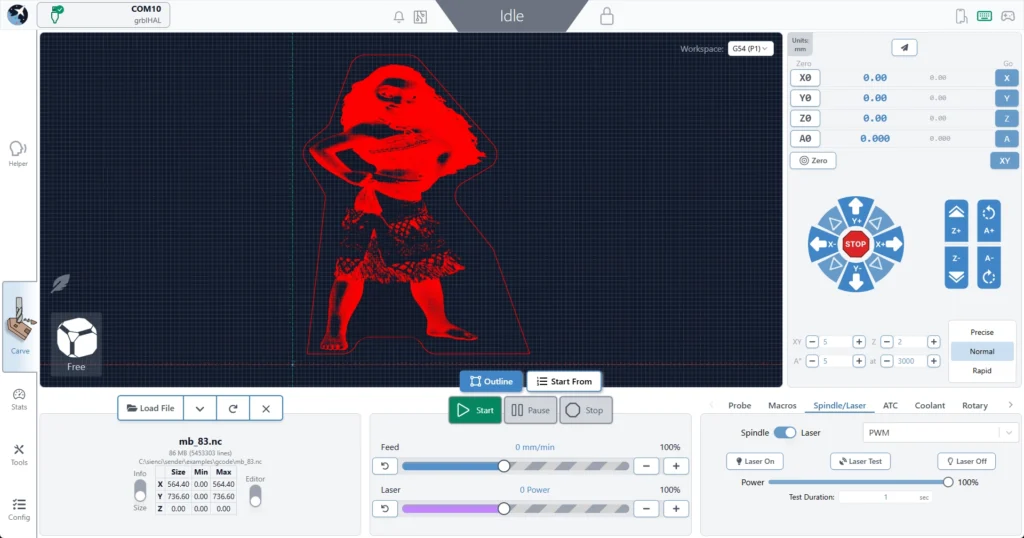

gSender 1.6.1
1.6.0 was well received (thanks for all the feedback), but a few issues and edge cases popped up across different setups that we wanted to address quickly. 1.6.1 is focused on tightening things up, improving consistency, and smoothing out some rough edges.
Changes

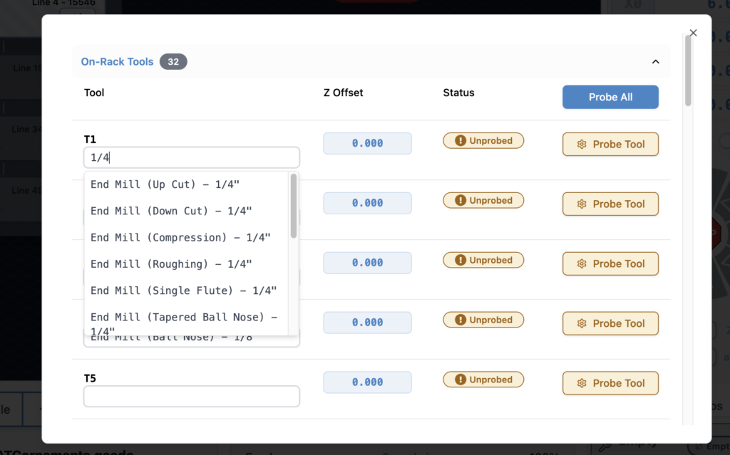

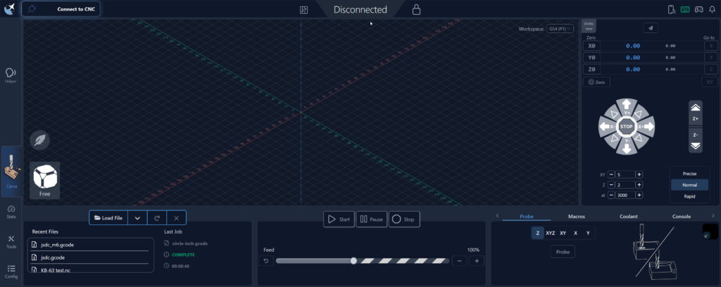

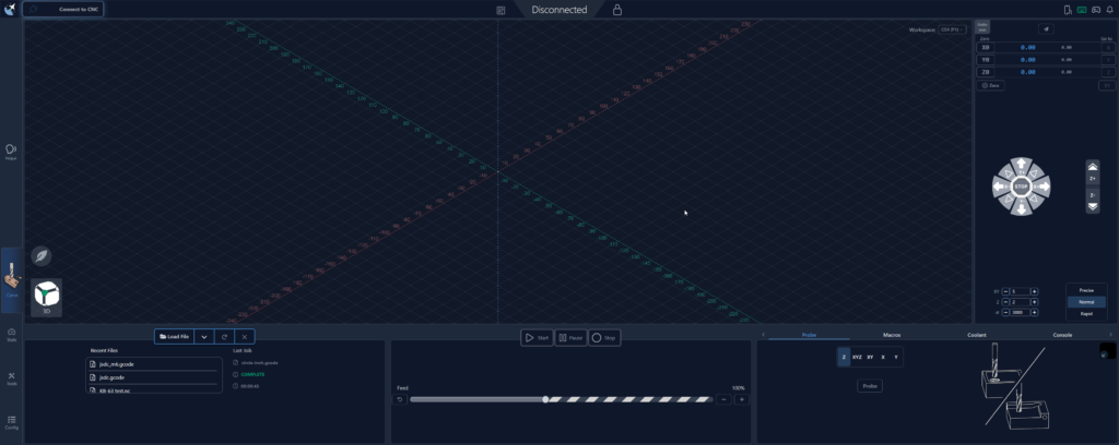

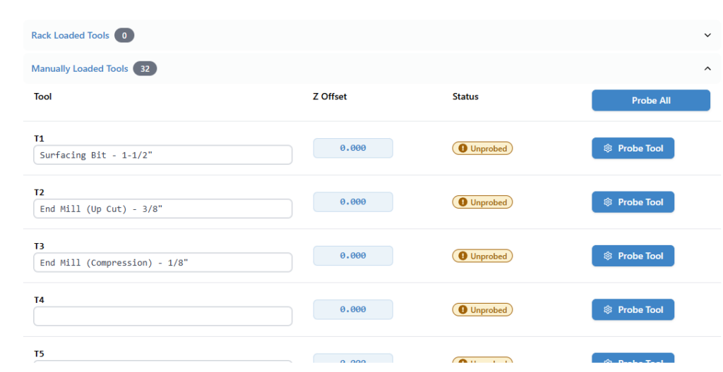

  • Added option to skip the first tool change when using fixed strategy, with a prompt to confirm

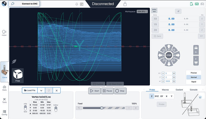

  • Added application scaling support for larger monitors and devices (Config → Accessibility)
Widescreen – 100 percent scaling
Widescreen – 200 percent scaling
  • Rapid Position and Park buttons now enable correctly after homing on grbl controllers
  • Spindle Delay config now properly reads $392 on older firmware versions
  • Go To flyout can now move in machine coordinates (MCS) when homing is enabled
  • Go To flyout now uses the same safe height logic as other Go To actions
  • Machine defaults selector will now prompt to apply changes where needed

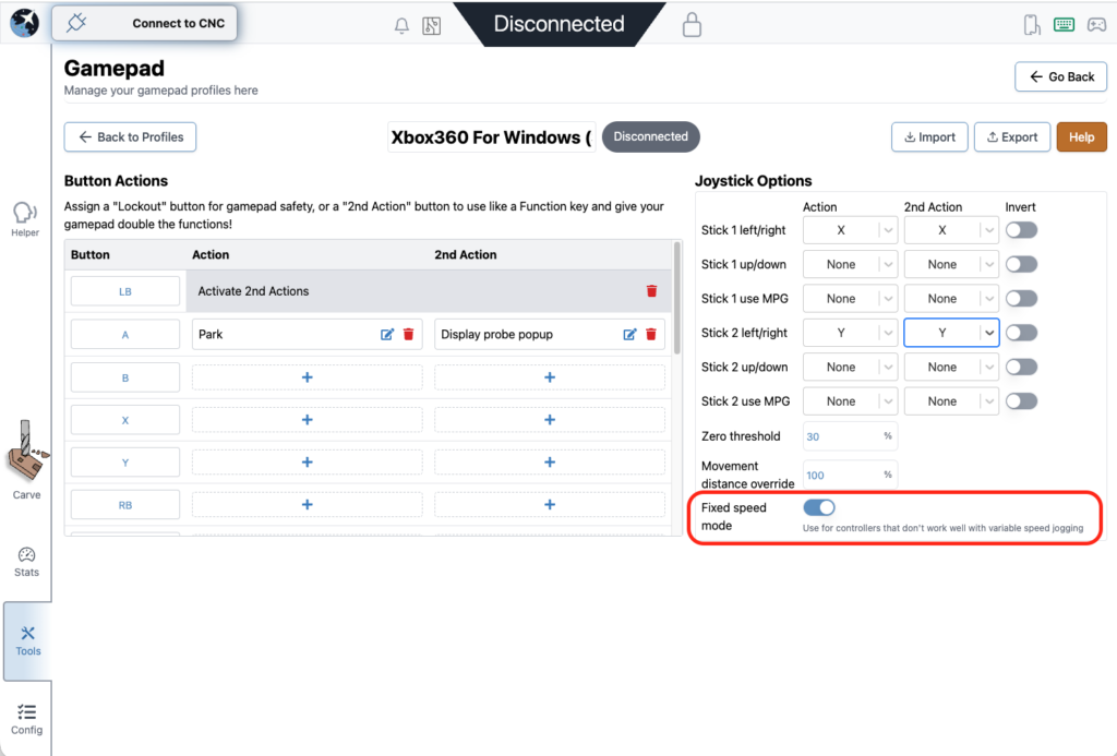

  • Gamepad Park shortcut now works as expected
  • Gamepad Fixed Rapid Position shortcut using stale position data
  • Macro keybinds should persist again

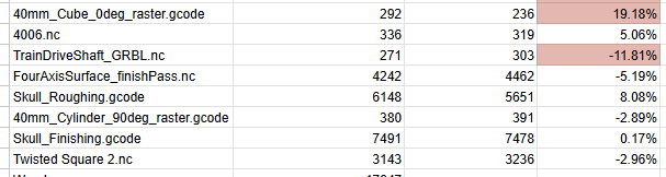

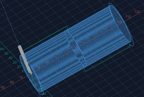

  • Continued improvements to rotary time estimation
  • Fixed issue where tool table was assumed as compiled in from PRB: output (not always present on some grblHAL setups)
  • Laser test now calculates max values using $30 (grbl) or $730 (grblHAL) instead of local state
  • Added iOS application icon support for better branding on handheld shortcuts
  • Added option to toggle probe type directly in the Probe drawer for quicker swapping of probe block types
  • Improvements to Automations editor (variables dropdown + general UX tweaks)
  • Added option to disable Electron power saving (allows screen blanking)
  • Lite mode toggle is now more obvious when enabled/disabled
  • Macros now show again in Remote Mode
  • Updated 3D Probe instructions to better match the selected probe type

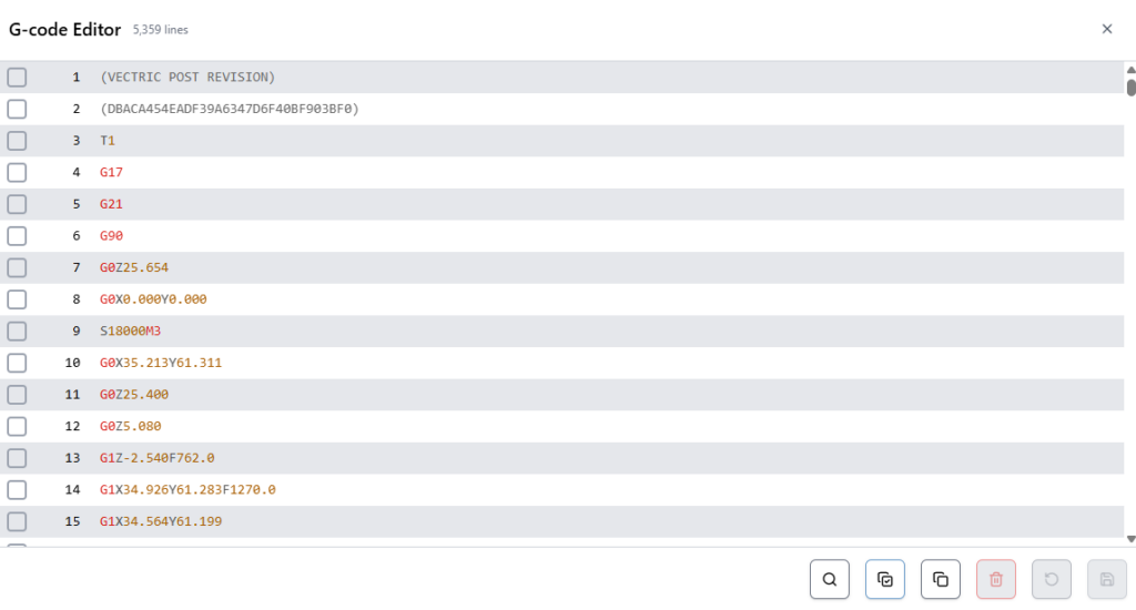

Built-in G-code Editor
gSender now includes a built-in G-code editor for inspecting and modifying files directly inside the application.
The editor includes:
  • Syntax highlighting
  • Search functionality
  • Quick navigation to specific terms or lines
  • Basic editing and saving capabilities
The editor also acts as an additional progress indicator while running jobs, highlighting which lines have been processed.
Editor

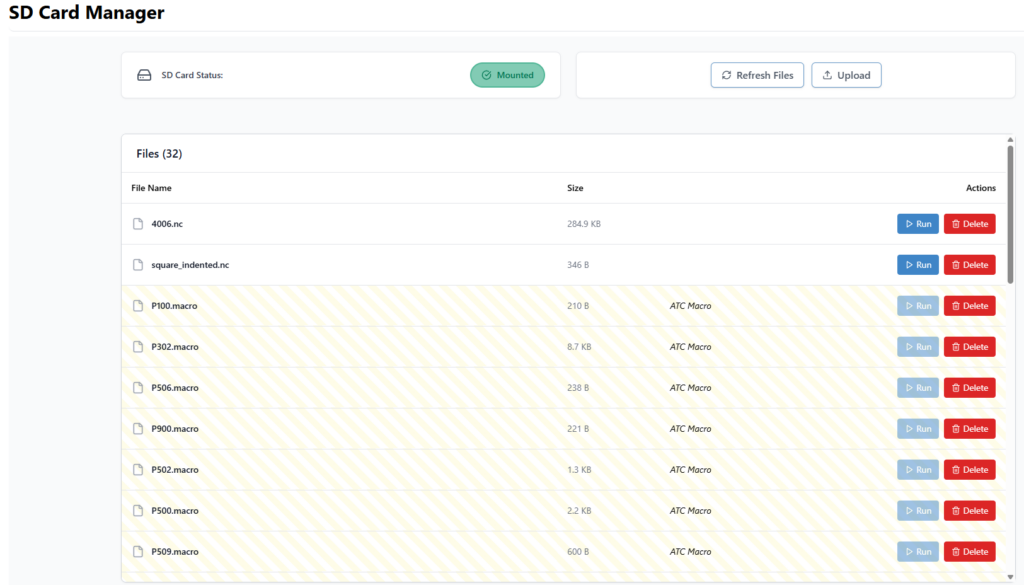

SD Card File Management
SD card functionality has been expanded significantly.
gSender can now interact directly with files stored on the controller’s SD card for grblHAL devices. It uses yModem protocol for USB connections, and FTP when connected over ethernet.
You can:
  • View files on the SD card
  • Upload files
  • Run files
  • Delete files
Files can be uploaded using drag-and-drop or file selection, making it easy to move jobs onto the controller.
When running jobs from the SD card, gSender now displays progress feedback similar to streaming jobs directly from the application.

Tool Table
A new Tool Table allows you to manage all tool-related information in one place.
You can now:
  • Store tool offsets
  • Assign nicknames to tools
  • Probe individual tools or complete racks
This makes it much easier to maintain consistent tool setups across jobs.
Tool Table – now with easier nicknames!

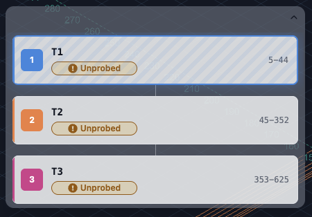

Tool Timeline
Tool changes during a job are now represented in a Tool Timeline, giving a clear view of when tool changes occur and which tool is currently active.
This helps users quickly understand multi-tool programs and track job progress more easily.
Tool Timeline

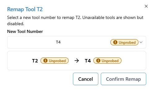

Tool Remapping
Tool remapping allows you to adapt a G-code file’s tool numbers to your machine setup without editing the file itself.
This is particularly helpful when:
  • CAM tool numbers don’t match rack positions
  • You want to run the same job with a different tool configuration
  • Tool racks change between jobs
Remapping can now be configured directly inside gSender before running a job.
Remap Dialog
ATC Workflow Controls
New controls were added to support day-to-day ATC operation.
You can now:
  • Load tools – both manually and using the rack
  • Unload tools – both manually and using the rack
These actions tie directly into ATC macros and make managing tool states much easier during operation.
ATC Widget

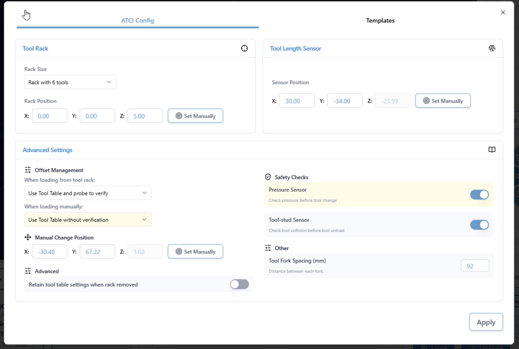

Accessory Installation Tool
To make getting started with an Automatic Tool Changer easier, gSender now includes an ATC setup tool that helps guide users through the initial configuration process.
The setup tool walks through the core steps required to configure an ATC system, including importing macro templates, defining rack size and behaviour, and writing the required configuration files to the controller’s SD card. This removes much of the manual setup that was previously required and helps ensure the necessary macros and configuration files are installed correctly.
The goal of the setup tool is to simplify the process of bringing an ATC system online, reducing the chances of configuration mistakes and making it easier for users to get up and running with automated tool changes.
We’ve already also implemented a spindle install tool, to help users with setting up their spindle accessory on arrival.

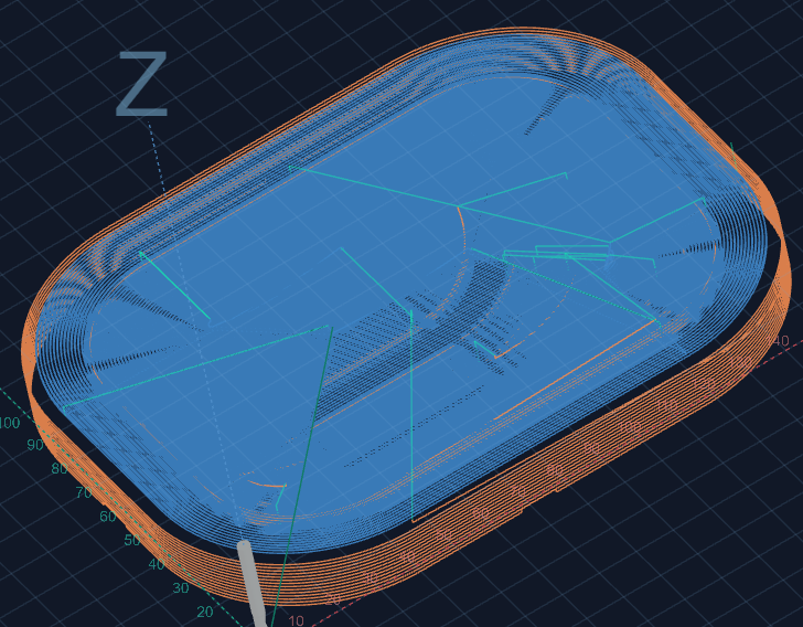

Improved Visualization
Visualization has seen several improvements in this release.
Rotary Visualization Improvements
Rotary jobs are now visualized more accurately, with fixes to geometry rendering and preview alignment. This provides a much closer representation of the final machined result.
Surfacing file no longer two straight lines

Improved visualization speed
Visualization parsing had significant improvments on both speed and memory usage. The end result is that users should be able to visualize larger files faster.
Benchmarks indicate about a 50% increases in visualization and a 35% reduction in memory used.

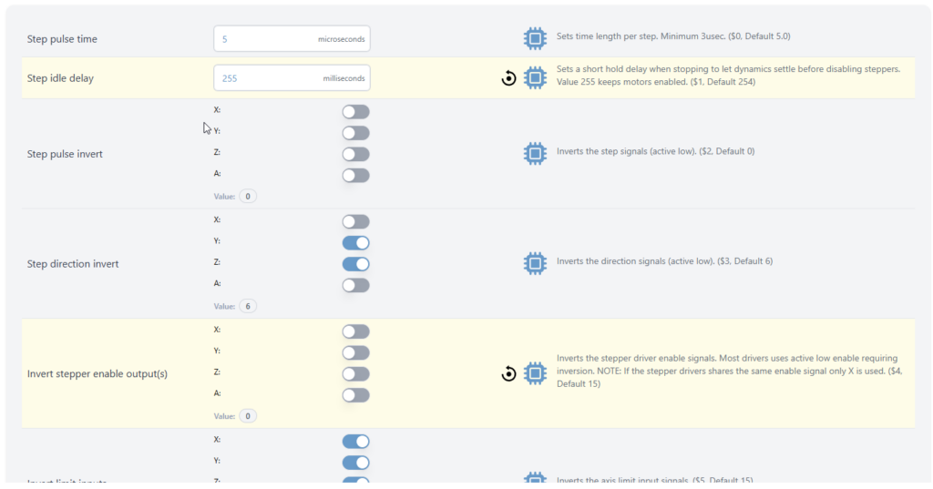

EEPROM Editor
Advanced users now have access to a new EEPROM editor.
This tool allows you to:
  • View EEPROM values
  • Modify configuration parameters
  • Search for specific settings
This replaces the older legacy firmware tool and provides a more flexible interface for working with controller settings. You can find it in the Config section of gSender.
EEPROM tool in Config

  • Gamepad options and configuration updates – some new behaviours related to jogging.

Office Expansion
We just expanded our office again! Mid-last year, our upstairs neighbours moved out so we took over around 6000sqft. There was also a part of the office with a stairway that lead to nowhere. Now, that stairway leads somewhere! We are knocking down that wall to take over a portion of our next door neighbour as well. This move adds another 2000-3000sqft, which will be used for some assembly work, especially for electronics, as it is more isolated to the larger office and we can reduce the amount of dust for those parts.
Painting the new office expansion

SLB-EXT V2
The development of the new controller continues to be underway. For those not up to date, we are working on a new version of the SLB to be better optimized for cost and manufacturing, while still keeping the same functionality of the original SLB.
Continued development of the SLB-EXT
A ton more work done with the new SLB, including:
  • Updated layouts for the traces and components
  • Design and development of the advanced breakoutboard
  • Design of new plugs and cables to improve wire management
We will start the process of making a batch of prototype boards and conducting testing in the coming weeks.
Rendered mockup

gSender Edge 1.6.0-Edge-4
gSender 1.6.0 Edge-4 is now out, bringing a solid round of improvements, fixes, and general polish.
We’re officially in the part of the Edge cycle where the focus shifts away from big new features and toward testing, optimization, and cleanup. A lot of this release is about making things faster, smoother, and more reliable based on feedback from everyone testing Edge so far.
If you’ve been waiting to try Edge, this is a really good time to jump in. As always, reports from early testers are extremely valuable.
Visualizer parsing improvements
This release includes a major rewrite of the file parsing and visualization worker used when loading G-code files.
Performance gains:
  • ~55% faster visualization time for most files
  • ~75% faster visualization for rotary files
  • ~35% less memory usage for typical files
  • ~86% less memory usage for rotary files
What this means in practice:
  • Bigger files load faster
  • Less RAM usage while previewing
  • Much better handling of large jobs
For reference, we successfully loaded an 85 MB / 5.5 million line file, which wasn’t possible in previous versions.
Large files visualize easily
If you want the full breakdown of what changed:
https://brash-elf-7d6.notion.site/gSender-Edge-4-Visualizer-Parsing-Improvements-30979195bff08056abcaf978c3db5cee

ATC – status updates and other
  • Probed, unprobed, and off-rack/manual states are now separate statuses
  • You can always see both offset status and manual/off-rack state when applicable
  • Tool Timeline received a visual refresh for better clarity and information layout
  • Tool nicknames are now included anywhere a tool number is shown in the UI
  • Config and Templates moves into Accessory Installation Wizard
  • Extremely professional placeholder images added to ATC Installation wizard while we wait for marketing
New timeline look
New machine profiles & grblHAL Core support

Outline improvements
  • Outline process improved – should be faster, should work better for all types of files. Travel direction is always consistent.
  • Added new option – Rapidless Square – which computes a bounding box of only the cutting movements (G1/G2/G3) and ignores G0.
  • Can now configure outline to use custom feed rates and G1 rather than G0 (Thanks, kieraneglin)
  • Inner islands no longer considered when generating hulls for details outline – so file outline should be more consistent overall
G0 ignored, just outline cutting motions
