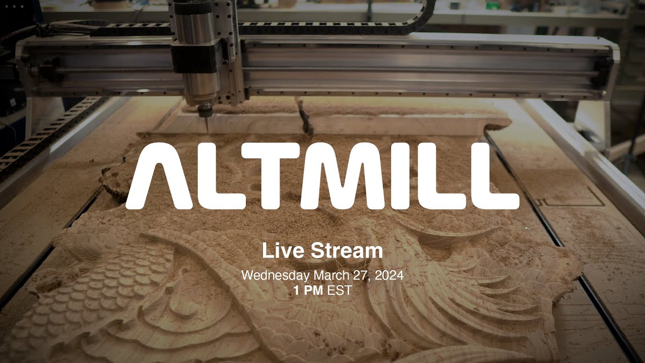

The AltMill can now be ordered on the AltMill product page.
Check out the Launch live stream below:
AltMill CNC Launch: Product Launch Live Stream Event

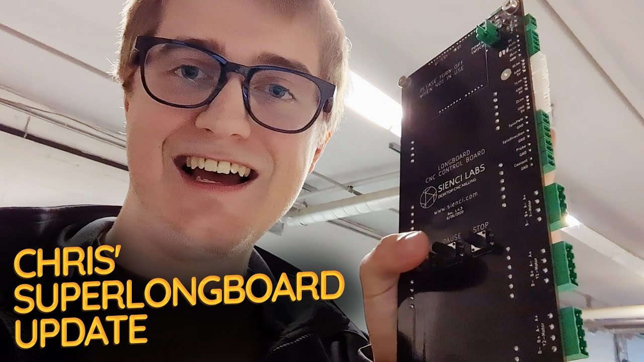

Greetings all, Chris here again to emerge from my SuperLongBoard development cave and provide you with my news!
For anyone who still has yet to hear about our new and most ambitious Sienci Labs electronics projects to-date, our arguably aptly named SUPERLongBoard, is the graduated version of our current LongBoard and has been designed to be even more SUPER at all things hobby CNC.

Next Big SLB Update
It’s SuperLongBoard update time!
Hi everyone, Chris here. It’s great to be speaking with y’all again, it’s not often I get around to writing blog posts since I tend to be more behind the curtain on the tech development we do here at Sienci. As Andy mentioned in his November Production Update post, there’s a lot to update on so I’ll spread as many juicy details as I can. We’re now at over 400 people interested in buying the new SLB system we’ve been working very hard at so thank you for your support! It’s very clear that our community is very excited about this massive upgrade to the LongMill and for the future of the hobby CNC industry.
To read past updates about the SLB, see our first major blog post (First look at the SuperLongBoard) as well as all the Production Updates that Andy has been putting out to keep you guys updated on our progress: May Update 1, Aug Update 2, Sept Update 3, Oct Update 4.
There’s also a video I filmed which you can feel free to watch if you prefer to see more of my face 🙂
Chris' SuperLongBoard Update: What's New?
