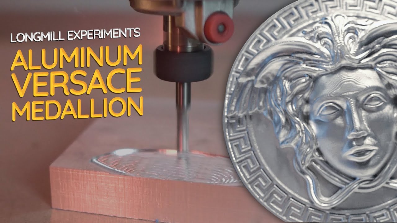

Hobby CNC vs Metal? LongMill MK2 carving a goddess into 6061 Aluminum
We’ve tested the LongMill on cutting softer metals such as brass and aluminum. CNC machines like the LongMill can take light cuts on these non-ferrous metals. Our team and customers have also tested cutting harder materials, such as steel, however, the LongMill is not effective with these materials. Most people will likely stick to aluminum as the metal of choice for cutting, which we will discuss here.
