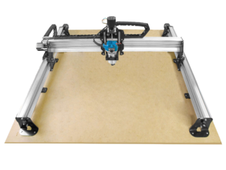

Your first, and largest purchase is going to be the machine itself. The LongMill Benchtop CNC is a capable option for hobbyists who are looking for a lot of functionality found on more expensive machines but in a more budget-friendly package. Depending on the size, you can get a LongMill for around $1800 to $2300CAD or around $1400USD to $2000USD, which makes it one of the least expensive options for the size.

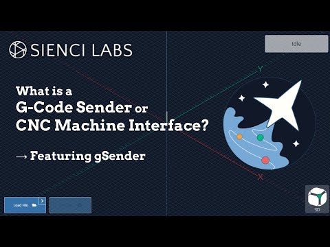

There are two main pieces of software you’ll need with your CNC machine. First is the gcode sender. We build gSender as a feature-filled, powerful sender specifically for the LongMill. This program lets you send jobs, change settings, control your machine, and integrate with accessories like the touch plate and inductive sensors. Best of all, it’s completely free!
What is a G-Code Sender or CNC Machine Interface?

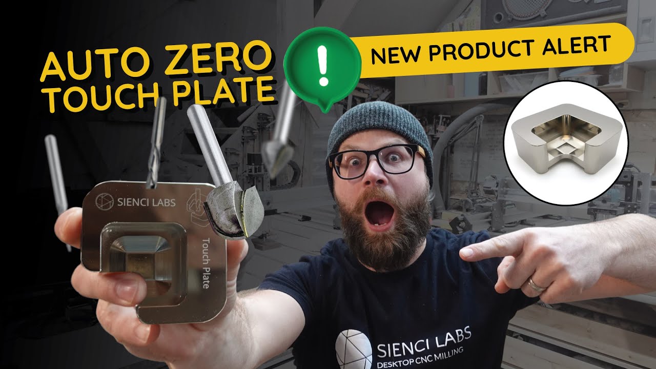

When starting your job, the LongMill needs to have a set origin point. You must choose a starting point for the machine to start from, and it will perform the movements sent by the computer from that point, in relation to the starting point.
The important thing is to setting the starting point. You can choose the starting point manually by just jogging the machine to the place you want to start and “Zeroing” the machine, but we’ve created the touch plate to help semi-automate the process.
Introducing the New AutoZero Touch Plate!
We currently have a simple touch plate for around $30, and a more advanced AutoZero touch plate for around $100.

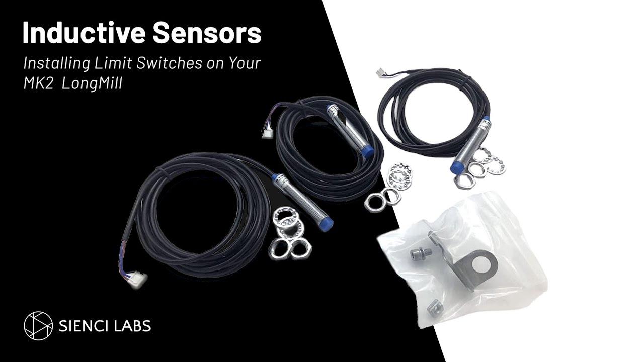

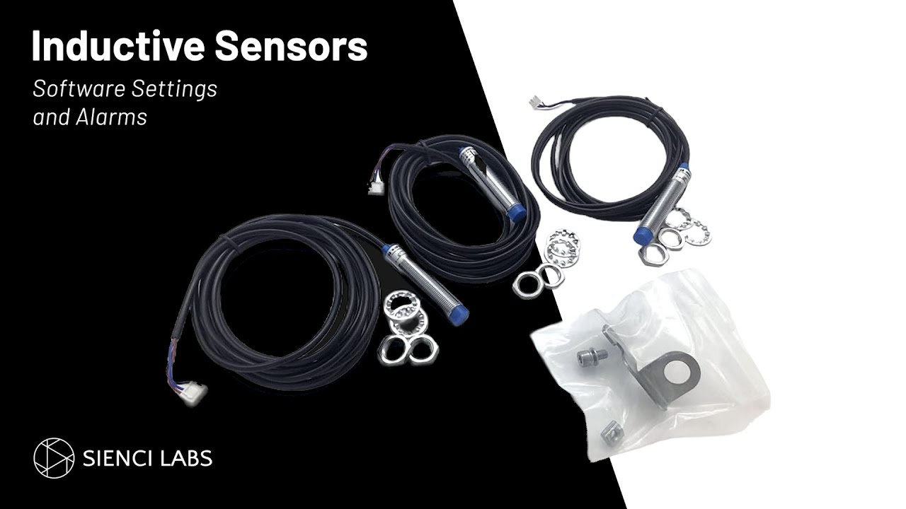

Enabling the Inductive Sensors for the LongMill CNC from Sienci Labs
You can get an inductive sensor kit for about $50-60 dollars from our store, however, we generally recommend this to only advanced users, since the setup and process for using it can be complicated, and we generally recommend users who are already familiar with their CNC machines to use it.
